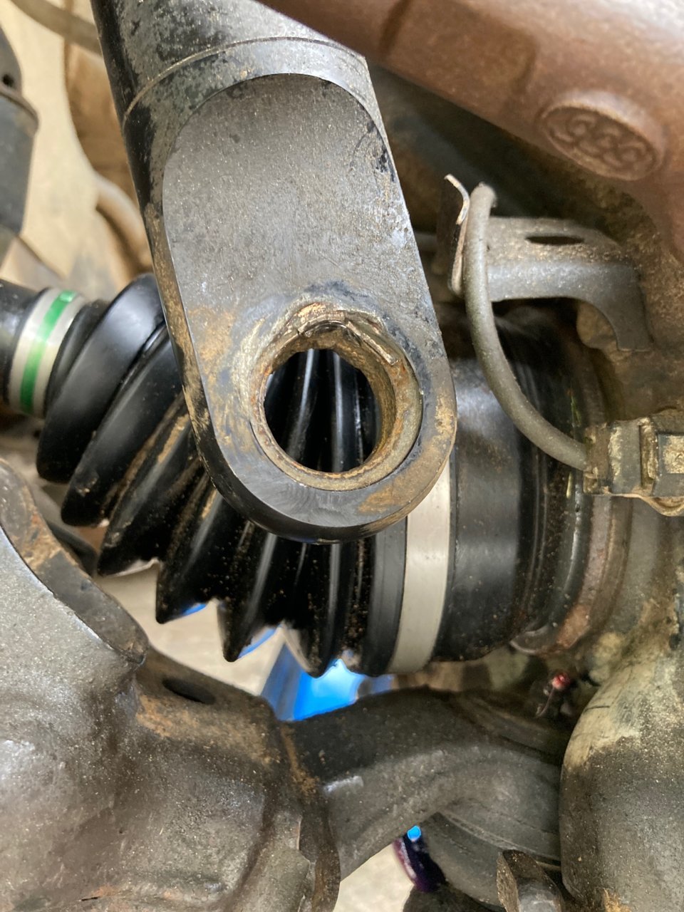

    That's the one, just not expected it to disintegrate in many pieces after two years (they barely saw any winter) when other brands last 3-5 years up here (FOX, KING, ICON). Problem is - I need this entire new lower shock mount, nobody got it.

    That inner circle is part of the bearing and can be pressed out. The new bearing would then get pressed in. Doesn't look like the shock itself would need to be replaced. Knowing the bore size of the shock body, the width of the bearing( the part left in the shock) and the inner diameter of the bearing you could source one from a bearing supply place. https://www.skf.com/ca/en/products/plain-bearings/spherical-plain-bearings-rod-ends/radial

    They're all the same bearing. I get a year out of my lowers on 3 different brands of shocks.
    I'd press a new bearing in there and send it until you can get a new rod end. @TMFF - 303 Shock Services has bearings and misalingment spacers in stock.
    IMO - this problem was due to a lack of maintenance, not Elka's fault.

    I thought about it as well first, till I brought it to CT motorsports who confirmed it needs to be changed. Plus few other places after sending them pictures said the same including Elka themselves.

    Changing every year seems to be excessive, again those should last much longer, guys here run other brands for many years with no issues. Either way we aren't here busting their quality, but lack of service support when I am ready to pay for parts. Simple things like this should be accessible.

    It should take you about 5 minutes to check the spherical bearings for play. Plus the squeaking and clicking should be a pretty good indicator that they're shot. If you're to the point of ruining the rod end, you've gone months ignoring the warning signs. They're performance parts and not made for longevity. If you want that buy shitty shocks with rubber bushings.

    Rubber seals can be swapped easy using anything similar at any supply store like Princess Auto. I would recommend to unbolt shock at the control arm and inspect it just in case now. :rolleyes:
    I pressed out remaining of the bearing, cleaned as much as I could, going to sand it and going to install Icon repair kit which comes with the new bearings and misalignment spacers whenever it arrives, so I will let everyone know if this works with Elkas. They did not find parts still, so pretty much if you own them you are on your own right now. :deadhorse:
    Icon Vehicle Dynamics Lower Coilover Bearing Spacer Kit - 611067 | 4wheelparts.ca
    Realistically if your misalignment spacers aren't damaged you can find bearings cheaper at local store.
