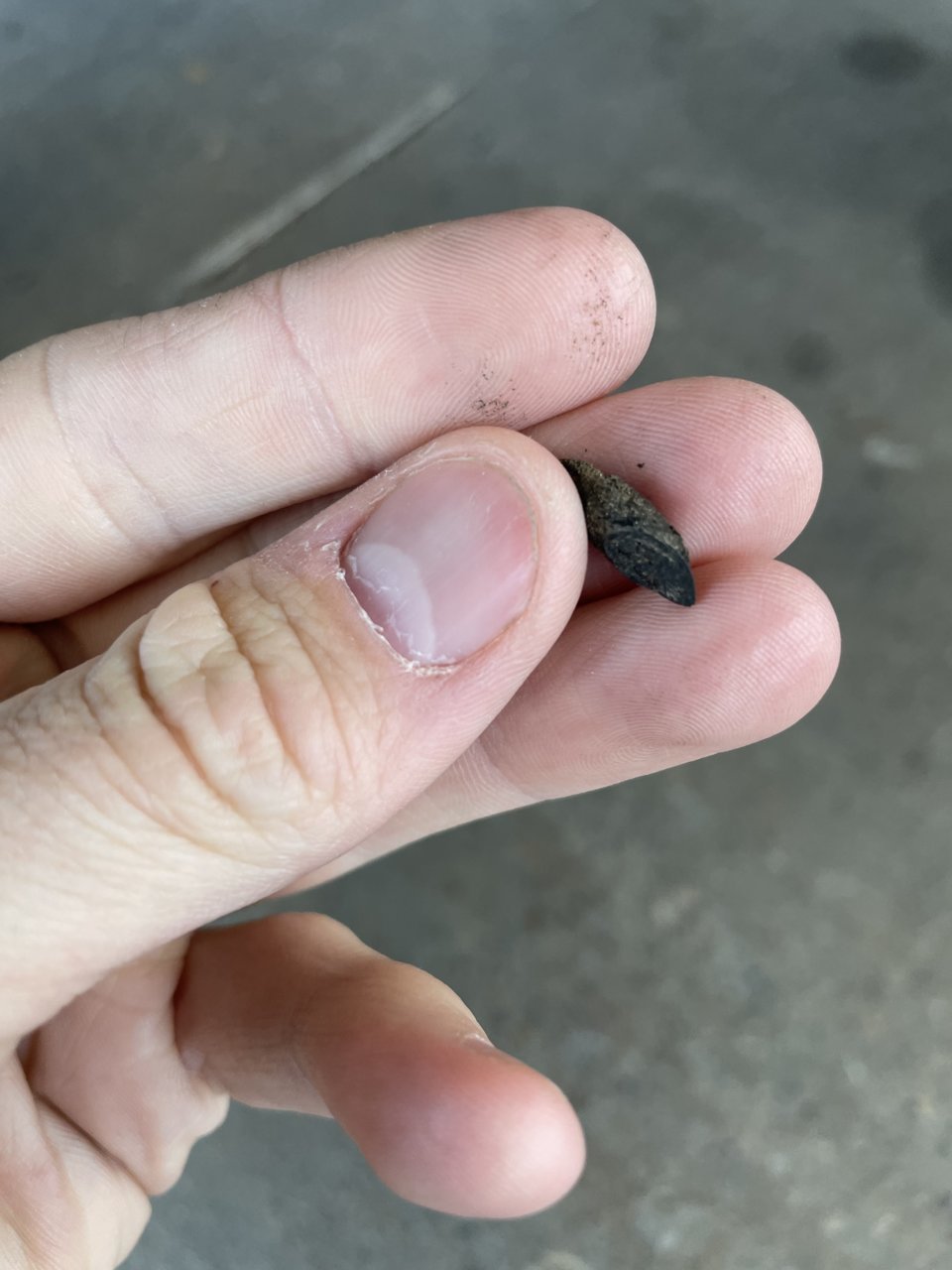

    What’s the correct way to check these bearings for play? I’m at about a year and a half on mine and y’all have me worried. I’m the least mechanically inclined person in the world though so talk real slow please.

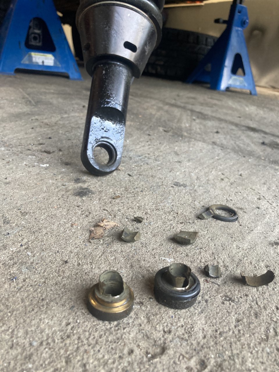

    Yikes :eek: it’s like everything disintegrated!!!! That is crazy. So what could look normal on the outside isn’t the same story on the inside

    @Squeaky Penguin may know better, but I guess lift your vehicle to have the most droop, remove lower shock bolt, pull the shock to the side and check by hand how much play bearing has? If you’ve been driving for 1.5 years now you may be due, since mine failed at 1 year and 10 months.

    Hell I didn't even get that far... 20211015_174316.jpg go back to start and try again! Got a couple replacements...gonna see if I can get the truck on the 2pt lift at the neighbors or inlaws and pull them, plus I need to adjust passenger preload to even out the mean taco lean I'm rocking.
    Also might explain the sound/vibe I was experiencing.
