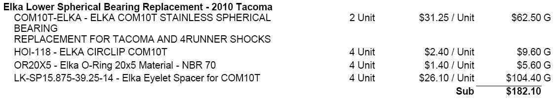

    Its a pretty common bearing amongst the different shock manufacturers. I get mine from here
    https://www.303shockservices.com/product-page/com10t-bearing-kit
    Might not ship to Canada though.
    You can also get those bearings in higher end specs if you want that will probably last longer but they cost way more. Here's some info on those
    https://adventuretaco.com/replacing-the-spherical-bearings-again-with-stainless-steel/
    Couple places you can get them online if locally doesn't work out. Not too hard to replace.

    I got 4WA here in Edmonton to replace my spherical bearings on the 2.0 Elkas.
    I bought the replacements from Krave and they had them in stock. It was just over $200 with shipping to Edmonton.
    4WA did mention that the Elka design is significantly better than ICON. Elka's have rubber o-rings and ICONs do not. 4WA says that the ICONs get completed wrecked by road salt and grime. Definitely not designed for Canadian weather and roads.
    I have no idea if these are a different design than the original. I don't think they are or 4WA would have mentioned it.

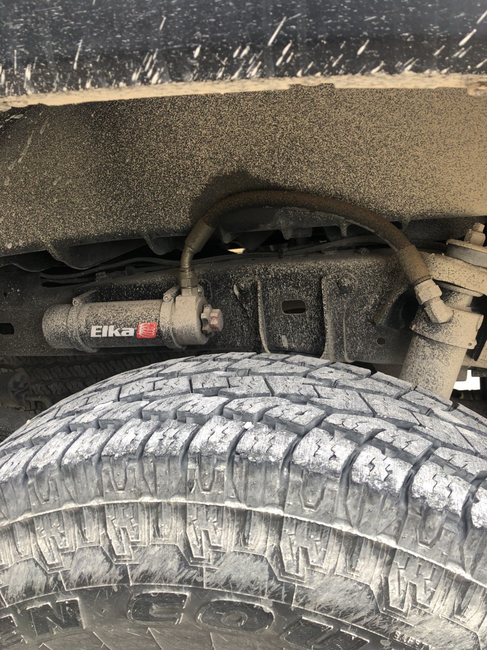

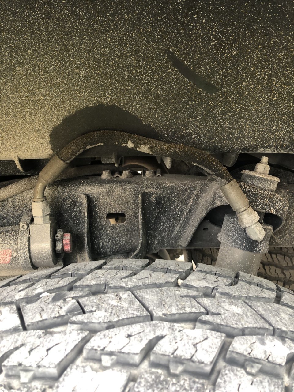

    Anyone had issues with the line between the shock body and remote reservoir leaking? 963DC8BA-B888-42CF-A0B5-1E19BE412D20.jpg F735D83D-5097-4500-8C31-A6AE0F3087F8.jpg

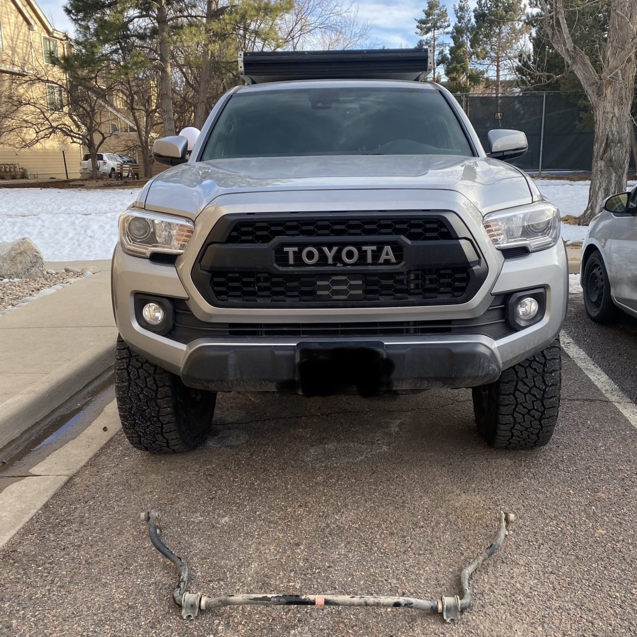

    Why did I wait so long?! This thing is going into the trash. I have 700lb springs and really regret not doing this day one.

    ^^ Not sure if it's any different but I have a 4th gen 4runner and both my sways are removed. I also have 700lb springs up front and the swaying back and forth is not a good feeling. I just haven't found the time to put my front sways back on. Most say their driving is nothing to worry about. Mine is the opposite. My daughter drove it the other day and that was the first thing she mentioned to me when she walked thru the front door. I thought it was just in my head but since she also mentioned it, I'm putting it back on.

    Yeah, I can hardly tell a difference at all with sway, but the ride quality is massively better.

  16. Feb 11, 2022 at 5:49 AM
    #356
    Skratch&sniff
    Skratch&sniff Well-Known Member
    Oct 16, 2020
    #344029
    205
    Its not just extra flex, it’s extra ride comfort. It just drives how I imagined it would after the suspension upgrade now. It doesn’t feel unsafe at all to me.
    TacoPandaTRD likes this.

    Congrats! It’s the best decision you can make. I’ve had mine off for 8 months now. Love the way it feels. With 700 lbs coils there is enough support to counteract the sway. I can’t tell a difference when swerving or getting on/off highway at high speeds actually but have noticed an improved ride comfort.

    How long and how many miles have you put on them?
    Any known or likely situations where you could've had flying sticks, largeish rock/stone? Is it leaking in the hose itself or the fitting/hose fitting?

    It’s perfect but not so stiff that it rattles your teeth out. Previous to removal I could open up high and low, all the way open, and it was still too stiff. I would sit down on the trails, still too stiff.
    Yesterday, when I took it out without the bar for the first time, it almost felt like a caddy. I tighten everything up today and it’s exactly what I needed. It’s sporty stiff, but I’m not going to get a concussion on a speed bump. Also, with the low speed tightened up all the way, I couldn’t really feel the sway at all.
    With how amazing the difference is, I can’t help but imagine that it wasn’t good for the spindles. I’m getting a Lil B’s front bumper installed with a winch on Tuesday. If it still feels this good afterwards I’m going to start getting serious about the Swaybarless spindle gussets.
