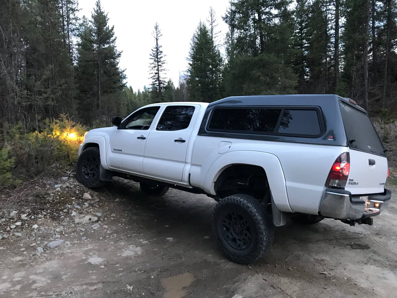

    I can say mine have held up well through their first winter. Body of shocks and resi's look new still. Some oxidation on fittings, but some polish will likely clean that up. Ride is good, though I don't have anything to compare to other than stock and the few months I had Fox 2.0 on front and custom tuned Fox 2.0's with resi's and LSC on rear. Ride is firm, but controlled. Seems to do best at slower speeds (5-15mph) in moderate to large size bumps/rolls, which it just eats up. Small bumps, pot holes, and expansion joints at speed >30 mph still drive me bonkers d/t feeling harsh and making the truck shake violently (that's rolling on C-rated KO2's). I don't feel like my adjusters make that much of a difference, which I need to reach out to Elka about. I have taken the sway bar off and added Hammer hangers in attempt to smooth things out more. Only small improvement noted. For reference, I have a 2nd gen DCLB with a shell that weighs ~175#. I went with 650# coils and used RXT leafs on setting 2 for driver and setting 1 for passenger, to help with the taco lean. Given the 3rd gen is quite a bit heavier in the front than the 2nd gen, I wouldn't be surprised if the ride is improved. I have yet to use the last 1.5-2" of shock travel on both front and rear, which makes me believe Accutune's philosophy that I could be sprung softer. I'd love to get my hands on a set of custom tuned 2.5 Fox's or kings with 600# springs to compare, but I'm already in so deep and corrosion is a huge issue where I live.
    Hope this helps. Here's a little flex shot.

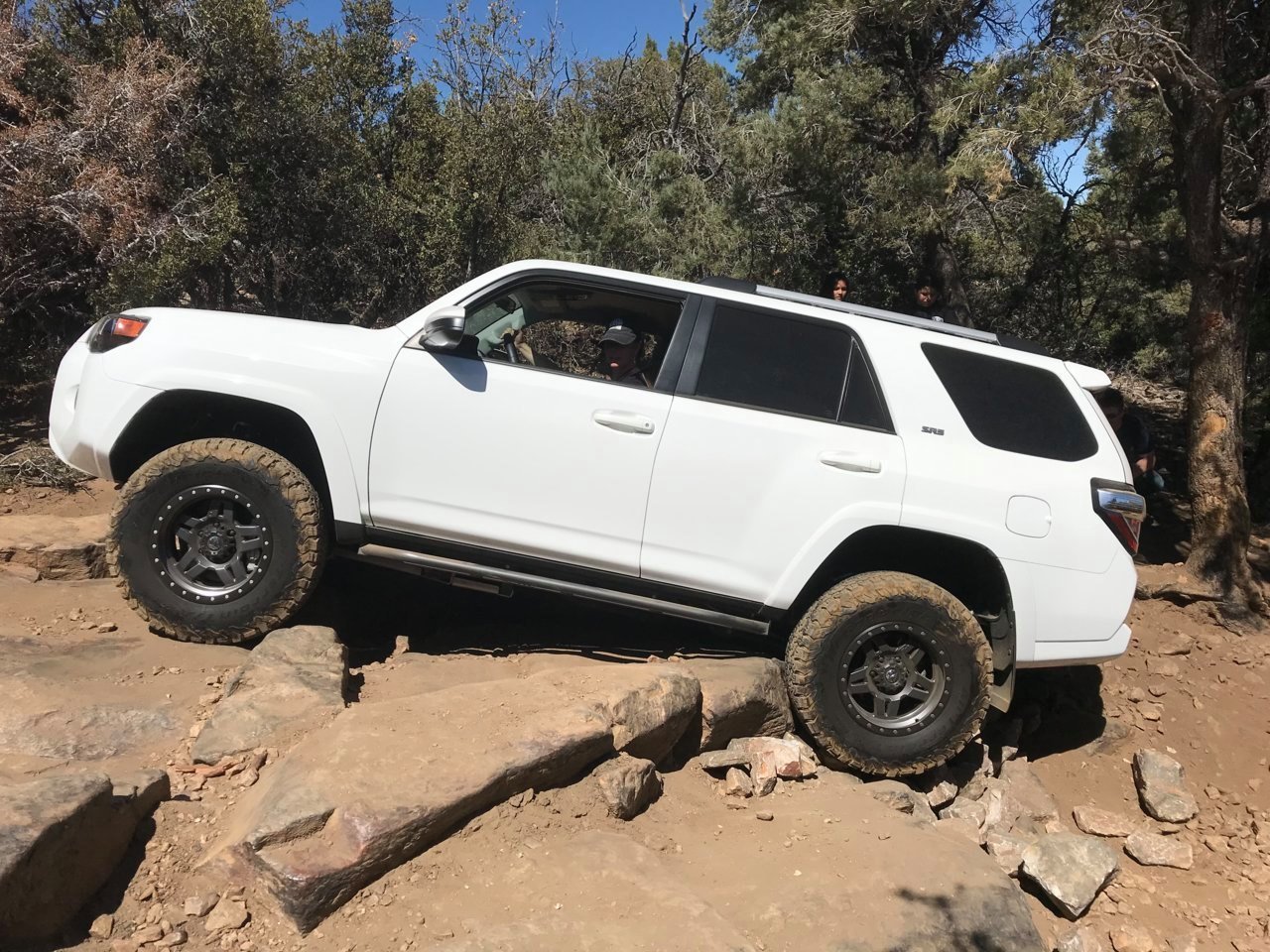

    I do have the Elkas on my 4Runner. So far I have been really happy with the on road and off-road ride quality. I have used them for daily commuting, longer family trips, some high speed desert stuff, and even some mild rock crawling. I personally do like the adjusters since I can (or usually my husband) dial them in for the various terrain and/or load we are running.
    If anyone is interested in Elka feel free to PM me and I can see what I can do on pricing for you :)

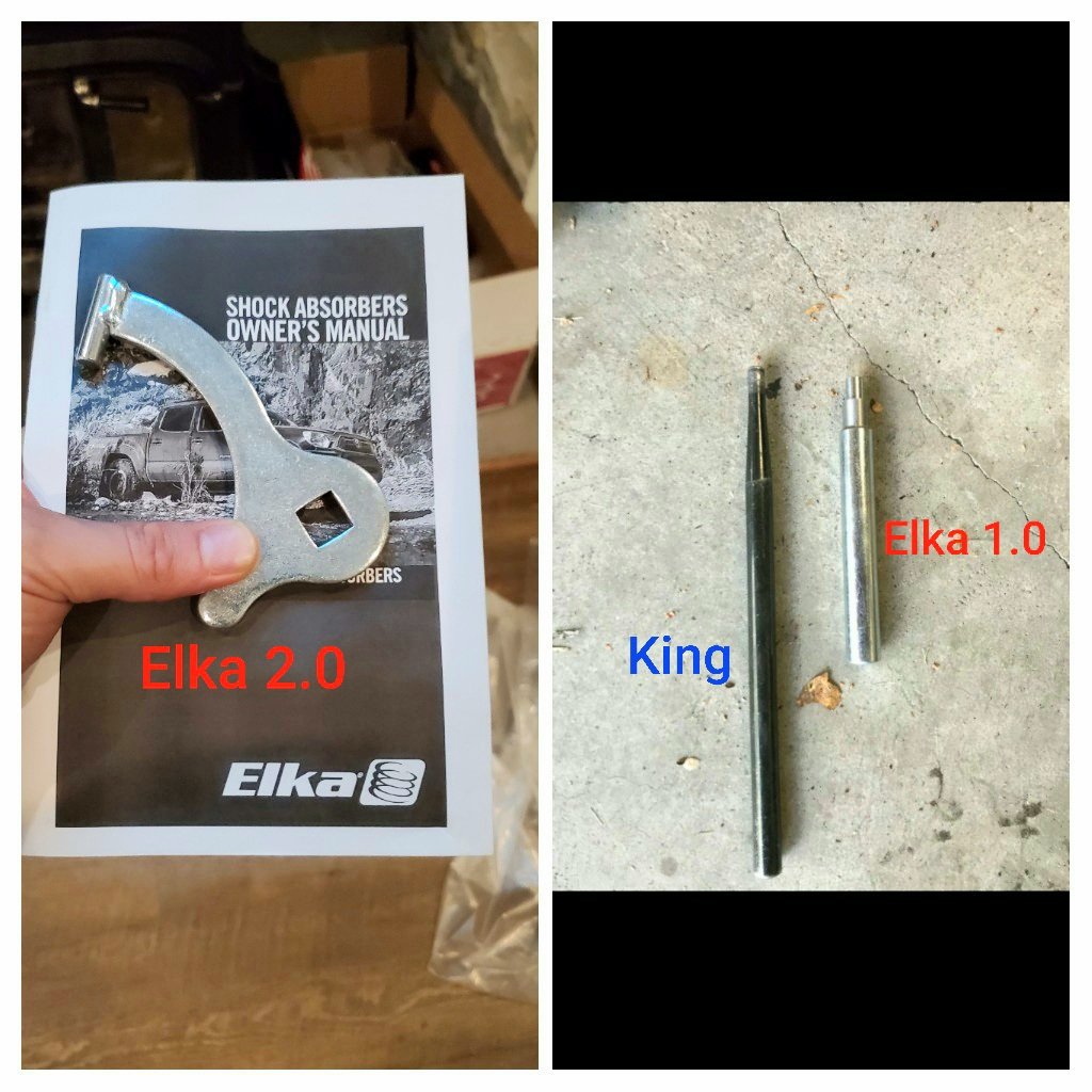

    Glad they listened to my feedback
