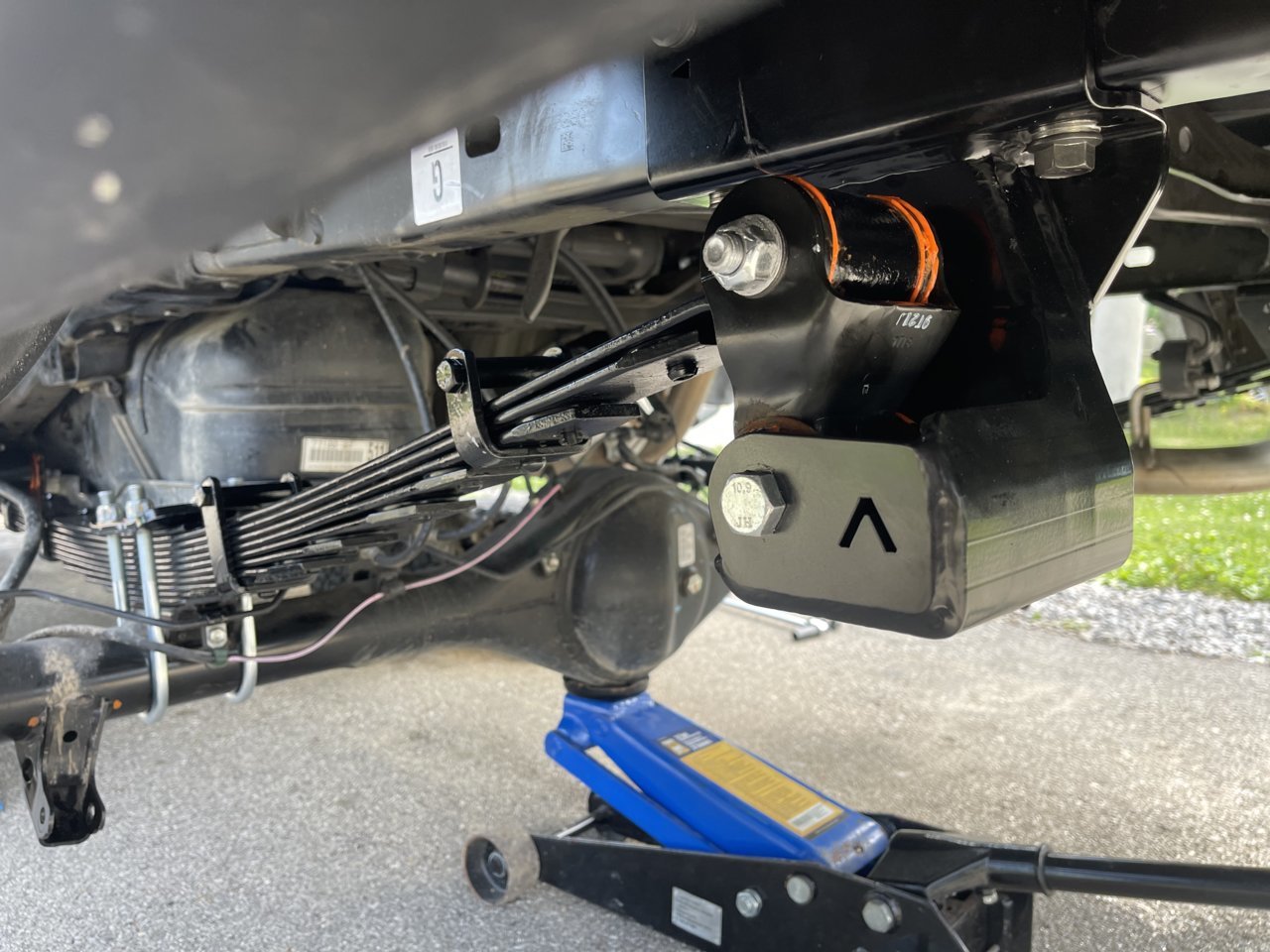

    There's the base hanger kit which is $500 USD shipped in the states. Optional 3.6" shackles (top quality construction and bushings, fully assembled) are $270 option. Optional Hi clearance Cross tube is $250 USD option
    https://archivegarage.com/explore-archive/ols/products/tacoma-hammer-hangers
    That double bounce is exactly what Hammer hangers nearly eliminate. What is happening is the stock shackle hanger is so flimsy and flexible, it is essentially like a spring itself, and that makes the frame and bed twitch and bounce which inhibits the leaf from doing it's job, and it ruins ride quality and confidence in the vehicle, and it gets worse the harder you push it.
    The stock springs are fabulous for ride quality with Hh installed.

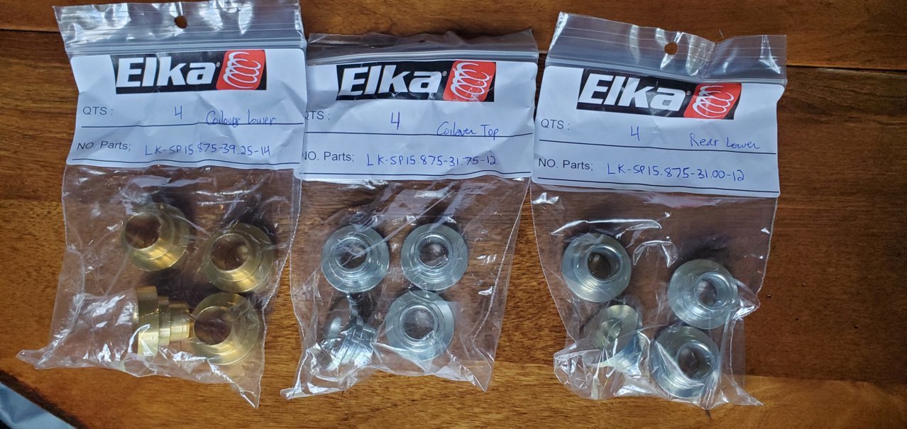

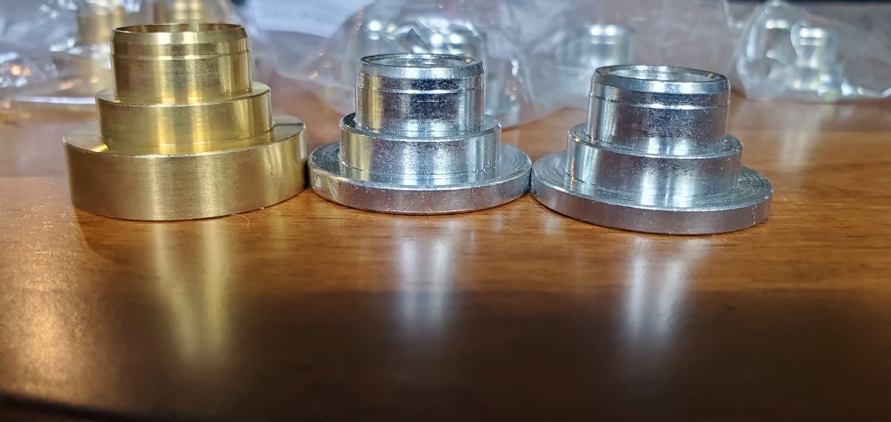

    FYI these silver/chrome ones are the other misalignment spacers for the coilover top and rear shock bottom.20220720_141130.jpg 20220720_141454.jpg

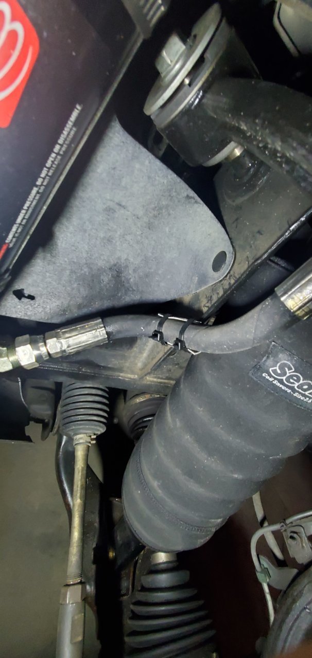

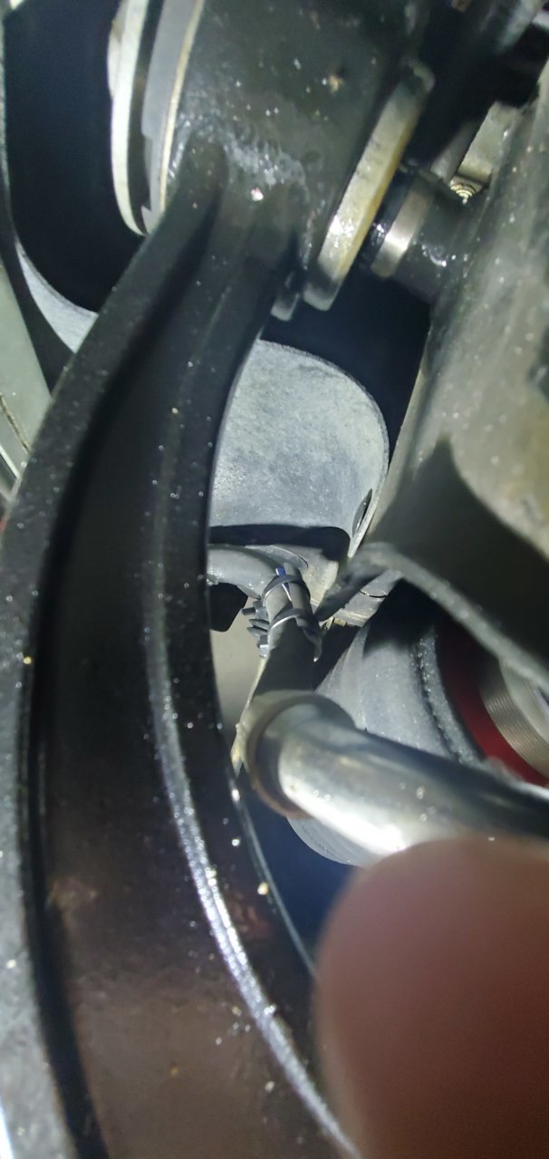

    Got my custom 2.5 DSC's with 600lb coils installed. Took about 12 weeks to get in, purchased through Krave. I've been running them for about 2 weeks now and have been very happy with the ride. However I was not the most impressed with how they fit. I had to loosen off and rotate the hose fitting coming out of the shock body so that the UCA's don't hit the hose during travel. But the hose is still touching the shock mount on the frame. There's already a fair amount of force on the hose which is preventing the resi from sitting higher in it's mount, so I didn't want to try to adjust that fitting yet. I made a little stainless steel collar to protect the hoses but still not a fan of them touching. Anyone else have this issue?

    Take the resi out of the mount and rotate it 360 degrees to get the hose to twist outwards. The hose shouldn’t be that close to the frame

    I'll give it a try... I don't recall that being possible though. There isn't much flexibility in the hose.
