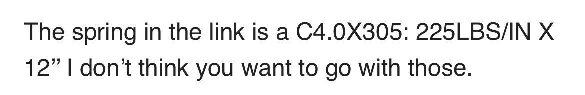

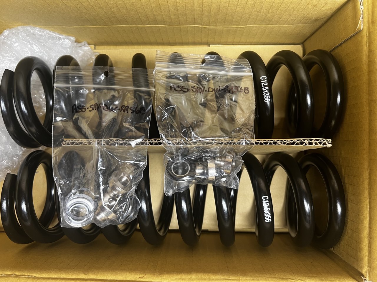

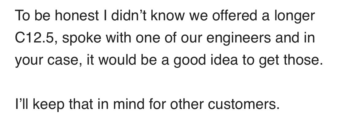

    So an interesting turn of events. At first when the rep responded to the link that you provided this is the response that I got:
    He obviously just looked at the photo and not the part number. So when I pointed that out, this is the response I got.
    Id like to thank @GasPowered for being the my number one Elka customer service rep. You da man! Springs are on order.

    Who has the upper and lower torque specs for a 3rd gen? :anonymous:

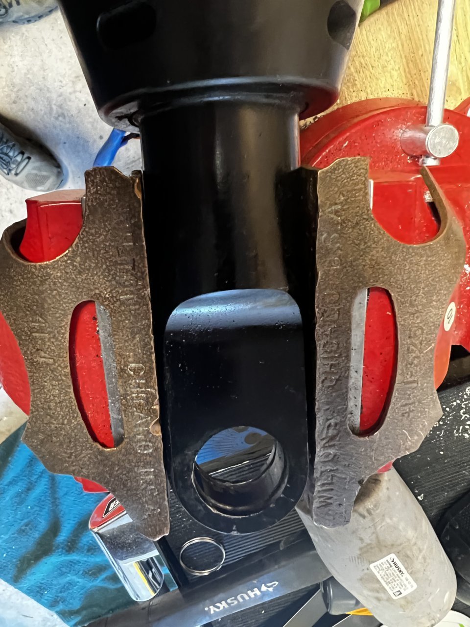

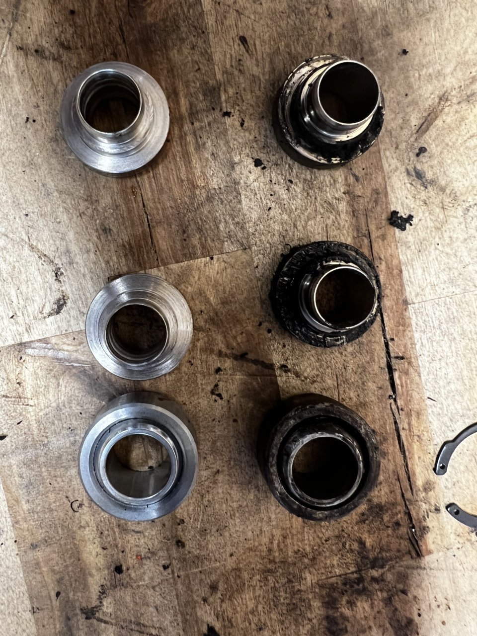

    I replaced the ones on my passenger side today. I can think of petter ways to spend a Saturday.

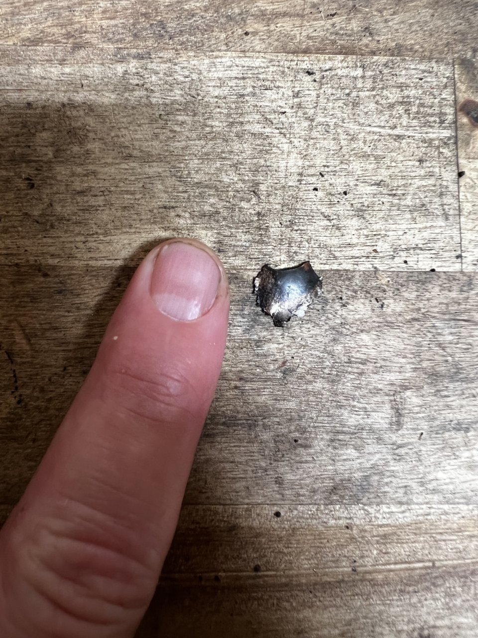

    Did anyone else get round shards like this coming out of the bearing?

    I didn't....

  11. Sep 21, 2022 at 7:53 AM

    That looks like the Teflon liner, once that breaks down the bearing is shot and the ball starts to move in the outer race.

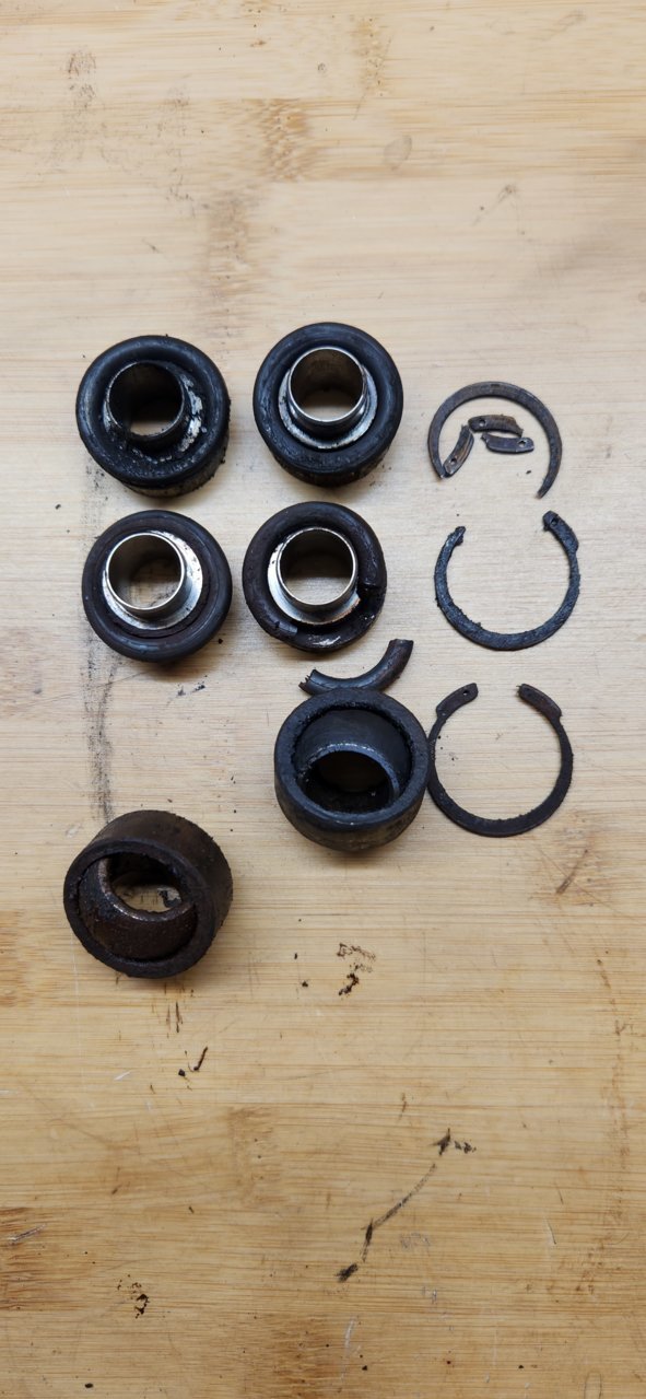

    Just thought I would drop in and leave this here. I'm amazed at how much dirt and crap was in there but everything came out pretty easily with no issues. The bearings were toast and I could move them freely with my fingers once I got them out. The new ones should be here today. 20220920_140013.jpg

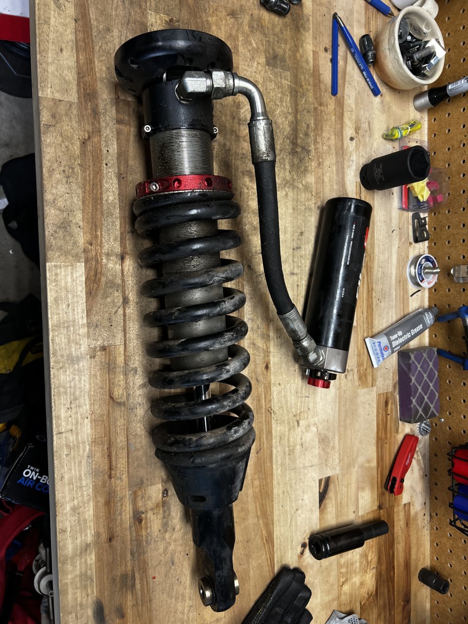

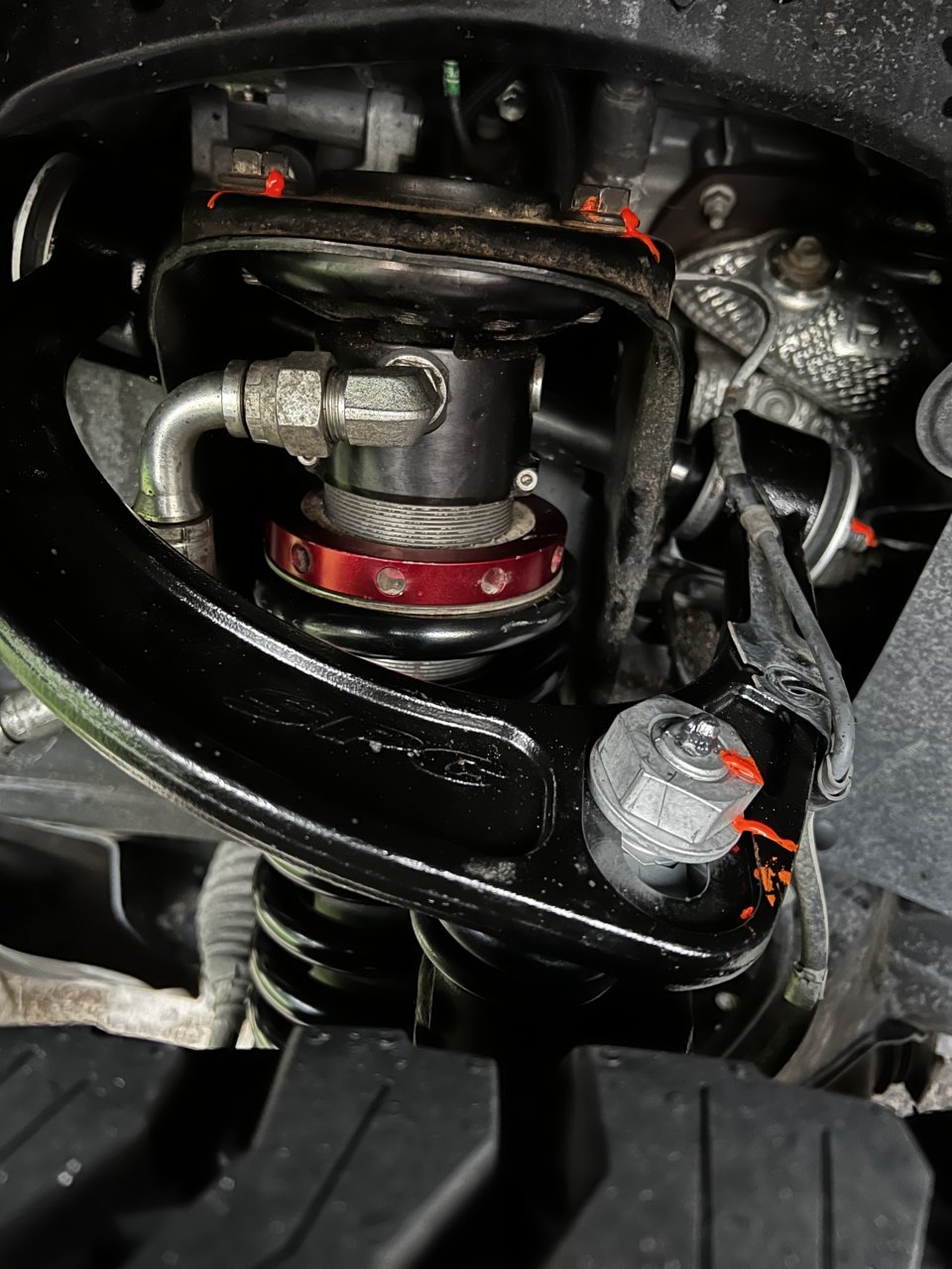

    Finally got the coils swapped today. Both are 700lb. It was good before, but now it’s amazing.
    E35B6855-FBC5-458A-9B76-609774D9D038.jpg D24E89F9-4348-4F3A-AA72-6ED536AD4A5C.jpg

    There’s less preload. They should not be shipping the extended travel shocks with short coils.
