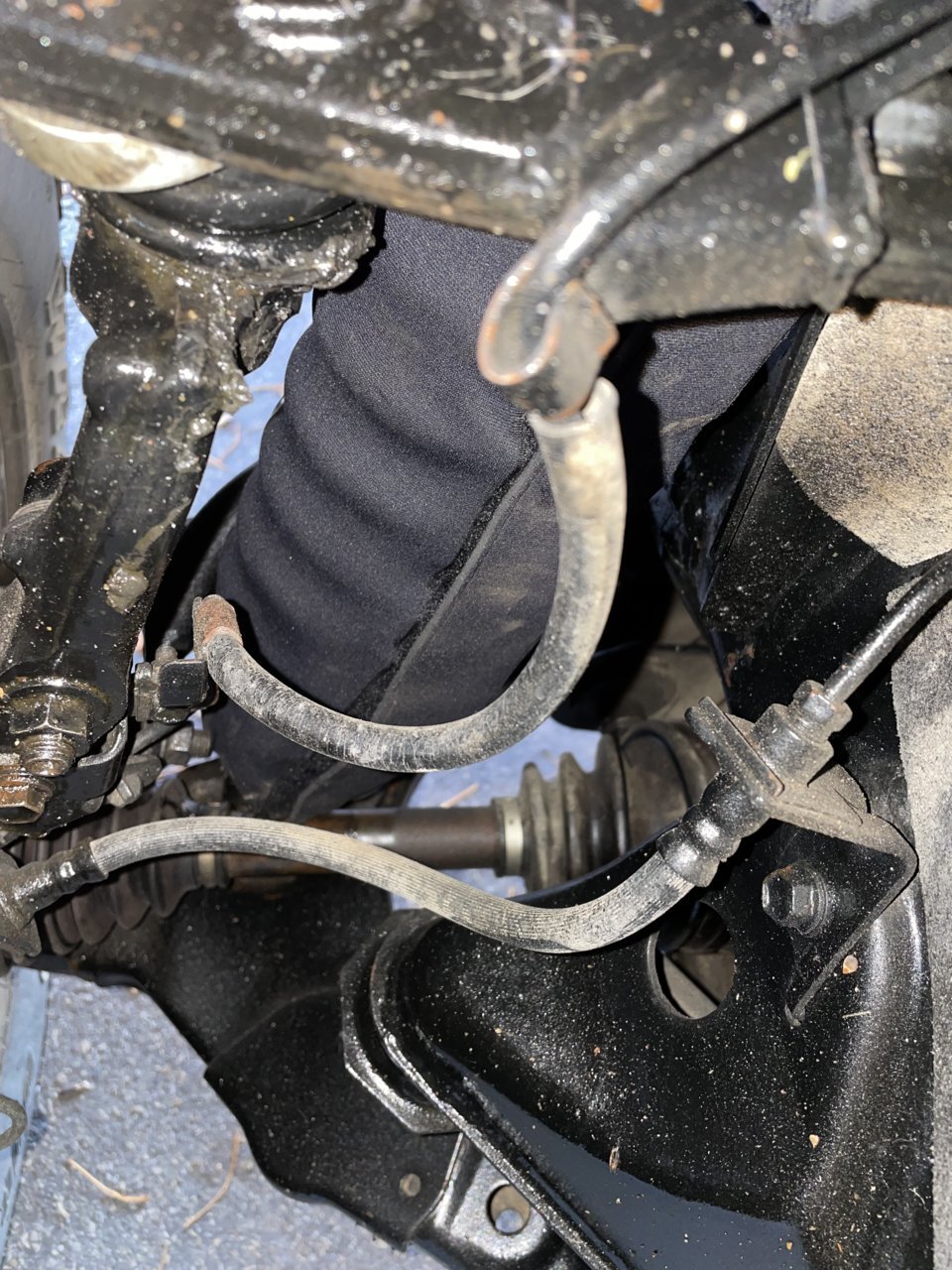

  14. Oct 25, 2022 at 3:32 PM
    #474
    dpele
    dpele Pele Prints Vendor
    Apr 13, 2016
    #184159
    988
    Dan
    Edmonton, Alberta
    2010 Tacoma DCSB
    Elka 2.0 w/ OME Dakars, 285/70/R17 Duratracs, & more!
    I have something similar.
    But I found that my neoprene coil covers have a little hole in them. It's from the brake line mount on the spindle.

  16. Oct 26, 2022 at 7:12 AM
    #476
    dpele
    Apr 13, 2016
    #184159
    988
    Dan
    Edmonton, Alberta
    2010 Tacoma DCSB
    Here are some pictures. The brake line mount on the spindle get close the shock when moving up and down.
    Don't mind the icon logo... for some reason I forgot to reverse the covers. I'll fix it when I put my winter tires on.

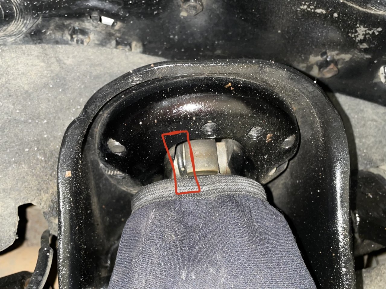

  17. Nov 7, 2022 at 1:22 PM
    #477
    dpele
    Apr 13, 2016
    #184159
    988
    Dan
    Edmonton, Alberta
    2010 Tacoma DCSB
    Has anyone had their top O-ring come out?
    I will try to put it back in before taking it all apart...
  18. Nov 7, 2022 at 4:53 PM
    #478
    Chax
    Chax Just sending it
    Aug 18, 2021
    #374556
    41
    Alberta
    2018 DCSB trd offroad
    Same thing happened to me on all my o-rings. Fixed under warranty. I think you need new o-rings, they get crushed when they do that. Did you adjust your shocks with the wrench?
    dpele[QUOTED] likes this.
  19. Nov 7, 2022 at 4:56 PM
    #479
    Chax
    Aug 18, 2021
    #374556
    41
    Alberta
    That o-ring design is terrible. I didn't adjust mine with a wrench when the o-rings squeezed out. 6 months on my Elkas when it happened.
  20. Nov 8, 2022 at 7:42 AM
    #480
    dpele
    Apr 13, 2016
    #184159
    988
    Dan
    Edmonton, Alberta
    2010 Tacoma DCSB
    I adjusted the preload right off the bat and never touched them again.
    I will push them in and contact Krave. I am also going to talk to them about the SPC warranty.
    Thanks for the info!
