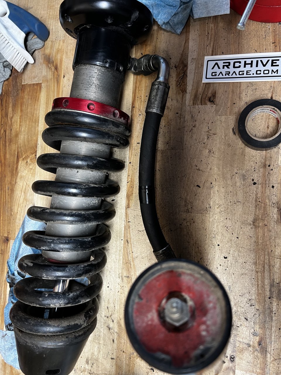

    Sorry, I was typing away on my phone and missed some important details.
    They shipped my 2-3 lift with 13” coils I believe. Hell, maybe they were 12”. All I know was there was a ridiculous amount of threads showing to achieve the appropriate amount of lift. I had to buy brand new 700lb coils (same weight, different length) to have an acceptable amount of preload. They charged me full price for the coils. Does that clear things up?

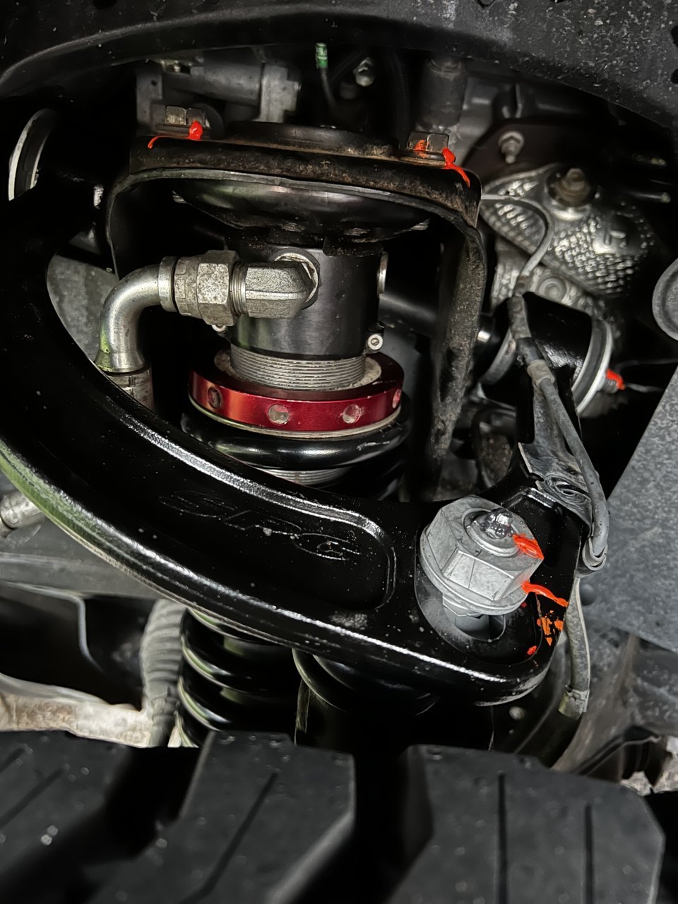

    At least when I looked earlier on Elka install instructions they said that you should not have over 2” of threads showing. My suspension certainly had more threads that the allowed showing, which is crazy considering it’s a 700lb spring and the appropriate amount of lift. This is before the swap.
    This was after:

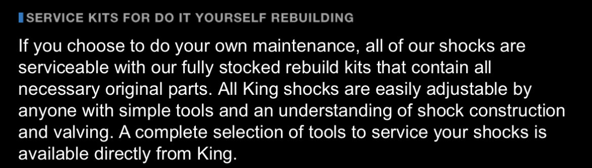

    It took weeks to get that response from Elka and previously they told me that their tech guy would provide the information, but then they changed their mind. I was willing to buy a second set if they were willing to provide it, but it’s a no go.
    I honestly haven’t found the rebuild info on Fox shocks website, but I haven’t really looked for it because I’ve watched enough videos to know it’s not going to be a problem.
    I found this directly on King Shocks website. This is the right attitude. I think that any company that advertises themselves as race shocks should understand that racers need pit crews with mechanics that have to appropriate information to do rebuilds.
    When I was on the phone with Elka the guy actually told me that they never made documentation for people to rebuild at home because “we didn’t expect that people would want to rebuild them at home”. What a joke!
