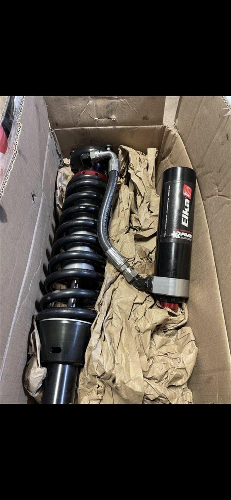

    Got a package today
    TacoPandaTRD and dpele like this.

    Slapping these on tomorrow. Hopefully they hold up better than my 2.0's dis long term

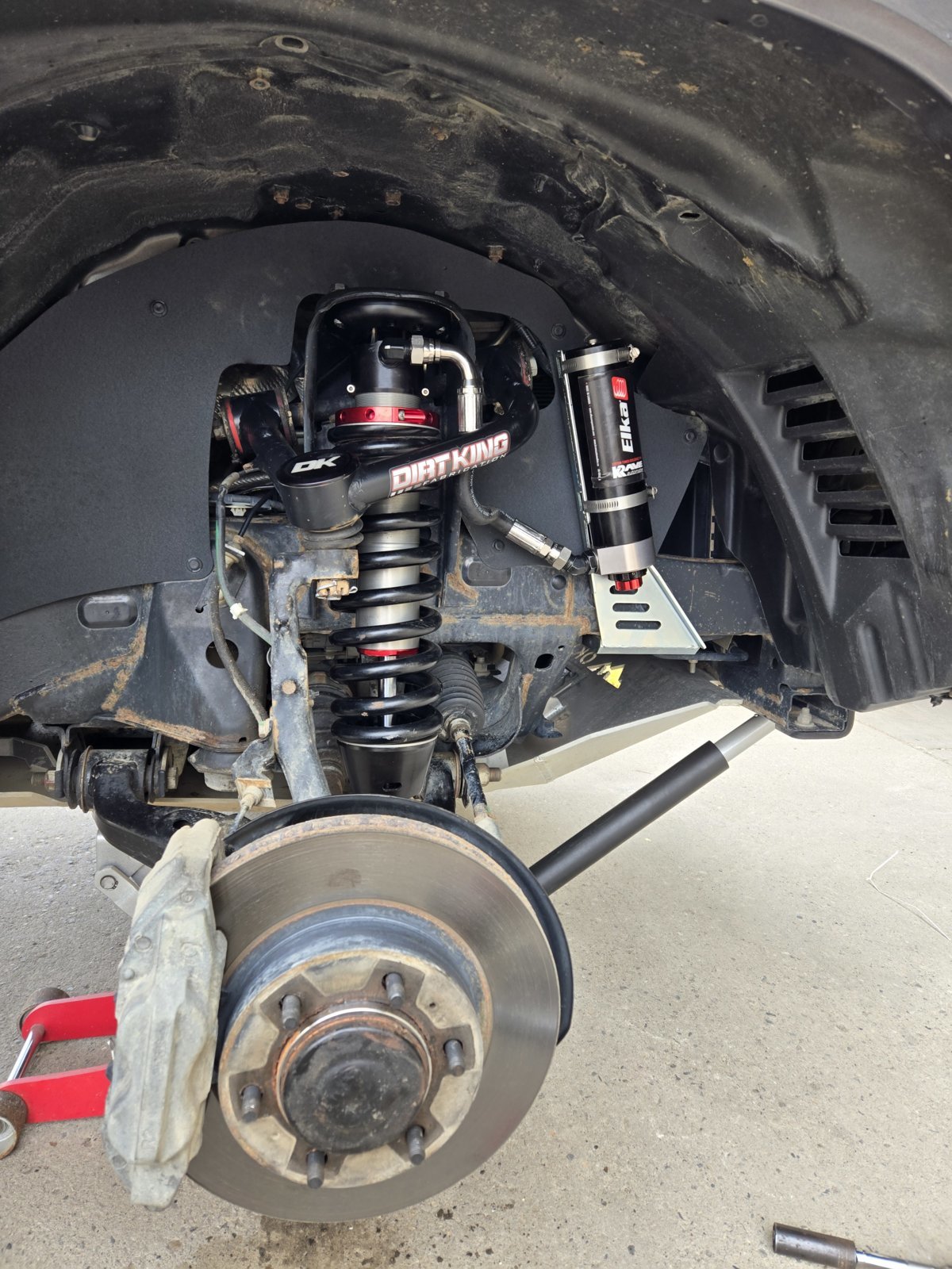

    They are in. The hose routing seemed a little odd but got it in the best position I could.

    That kink doesn't look ideal. Can you not just loosen the hose connectors a touch to move the hose around?

    That's the result after tweaking them. It goes in for the alignment thurs so I'll get a second opinion
