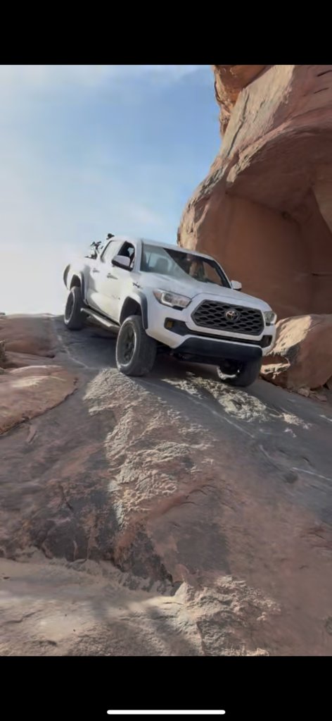

    14” 650 would be ideal for how I’m setup right now I think. Would be only the tiniest pre load on it. I have a spare 13” 700 but don’t think I want more spring rate just length.
    if it’s also your daily they’re damn good. I’d you’re expecting 100% purpose built off-roader I think there’s other ways to go than the IFP’s. But for simplicity’s sake, I’m glad I have em, and had the ability to raise the front easily after adding full skid sets vs clip settings on bilsteins and taking tophats off etc
    obligatory hells revenge pic with shit quality cus this is first night having service but only occasionally 1 bar & friends phone couldn’t get the full HD sent to me
