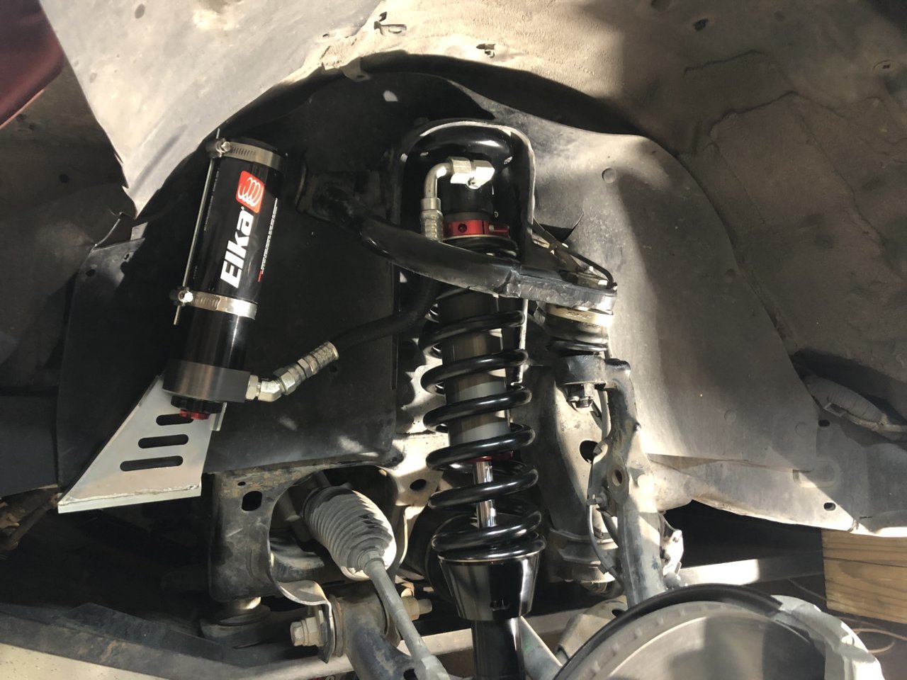

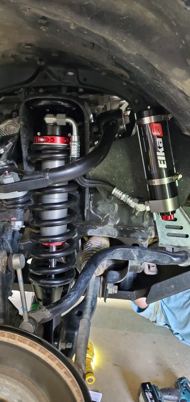

    Well changed shocks today, got the fronts only from someone who decided they were not going to install them after buying them. I did adjust the preload some but need to read some more to understand this better from what I have.
    700lb springs, short drive down the road and can tell there is a noticeable feel to the front end. The OME had just over 70k on them and the 886 springs have well over 100k as I got them used from a local member.
    Old
    new
    One thing that I had to do in order for my res bracket to work with my front bumper bracket was adjust it so that I could get it to line up with the mounting holes for sway bar location. (removed from my rig for months now)
