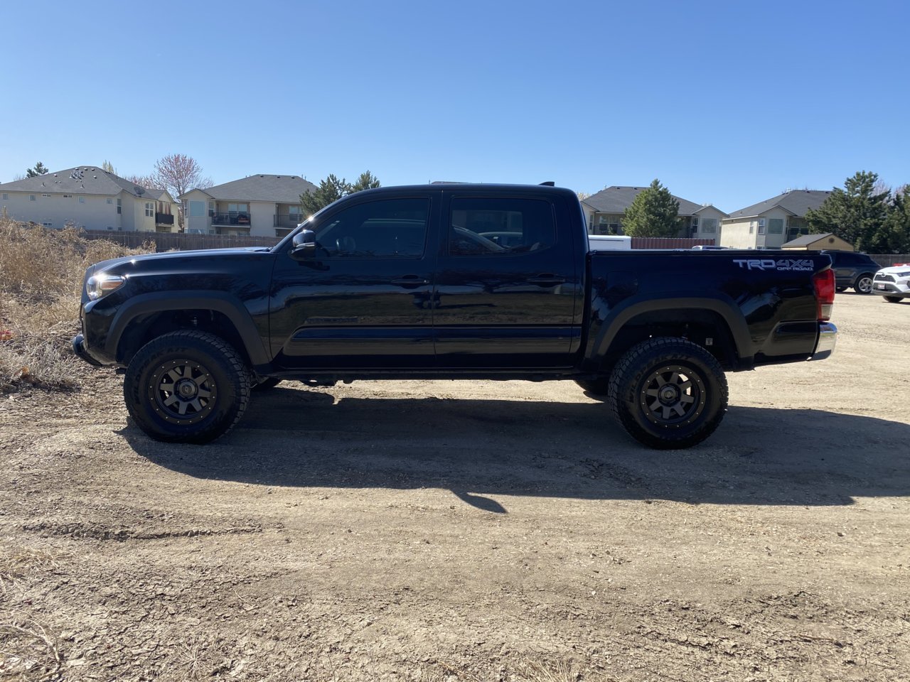

    Elka 2.0 with HS AAL. Stock size tires on 16” SCS wheels. I got the full 1-1/2 on the rear from the hub center. Only got 1-1/4 in the front. Need a turn or 2 on the coil over. Drives way better than stock and love it on and off-road. The rear tightened up a bit. Nothing too bad. 700lb coils.

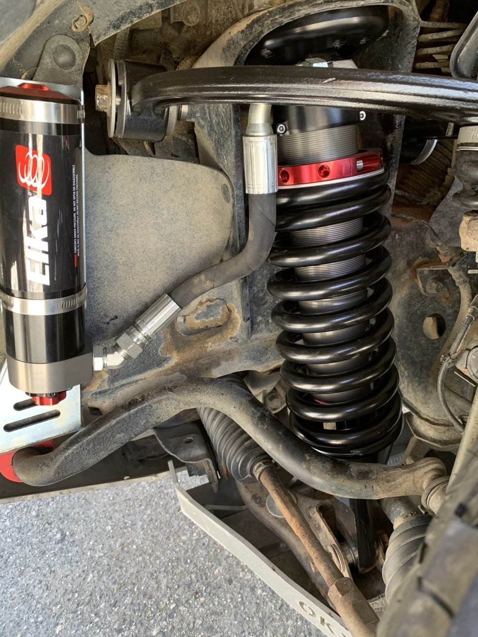

    Same thing although on 2nd gen with winch and bumper... coming from an OME setup with 885 coils that sagged due to the added weight. The new, factory set Elka 2.5 DCs, seem to give me less than 2” and are still giving quite some flex rub (alignment next week), which I haven’t had before. Keep me posted about adjusting the height and what Elka says.

    Interesting, ordered my 2.5 dsc with 700# springs and the 2-3in lift option. My collar is on thread #1 from factory, 20200919_155424.jpg and I've added hybrid slimline, steel skids and a winch. I've lost the ~2.5in lift on driver's side, so I'll be cranking on the collar in the not too distant future.
