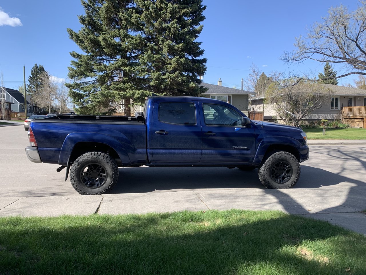

    Managed to get my 2.0s fitted up with spc arms. Threw an icon AAL and timbren stops on the rear. So far it feels good but haven’t done any fender well clearance work yet.
    Question for anyone - did the sway bar relocate bracket give adequate room to the coil? I’m about .5” away which seems close.

    wally11
    wally11 Well-Known Member
    Jun 30, 2020
    #332983
    62
    Mark
    2017 Black DCSB
    I have about the same clearance and have had no issues with the coil being rubbed or anything else rubbing

    I have the relocate kit installed and it's pretty damn close. I can barely stick in finger in-between.
    I do have some neoprene shock cover installed over the coils and there's not a mark on them. So I'm assuming they are not rubbing at all.

    Thanks Dan. Good to know I didn’t screw it up ha. So far pretty impressed with these! Time to make some fender room after the alignment as I’m rubbing in the usual spots.
