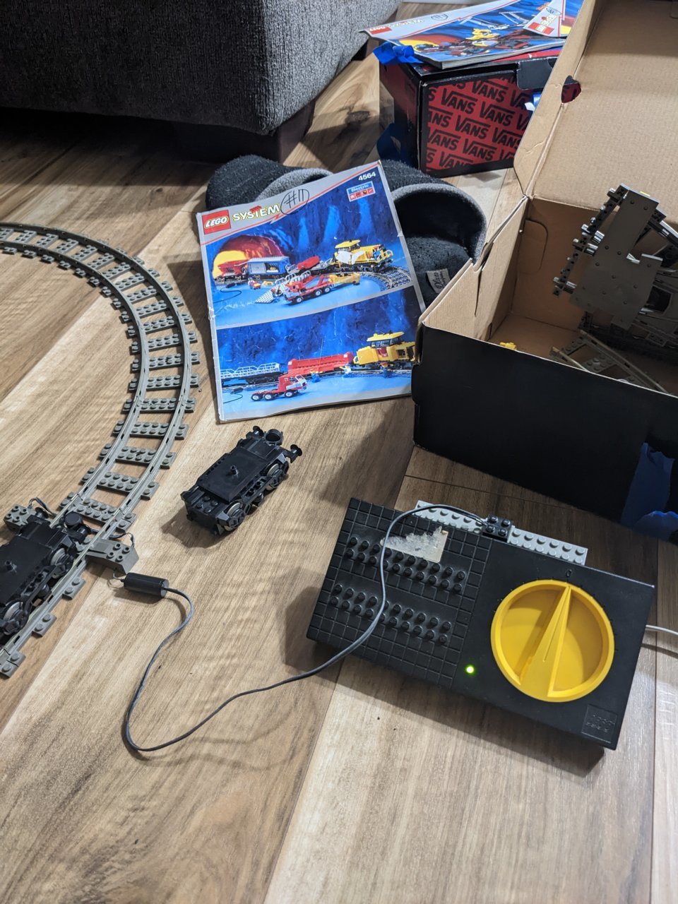

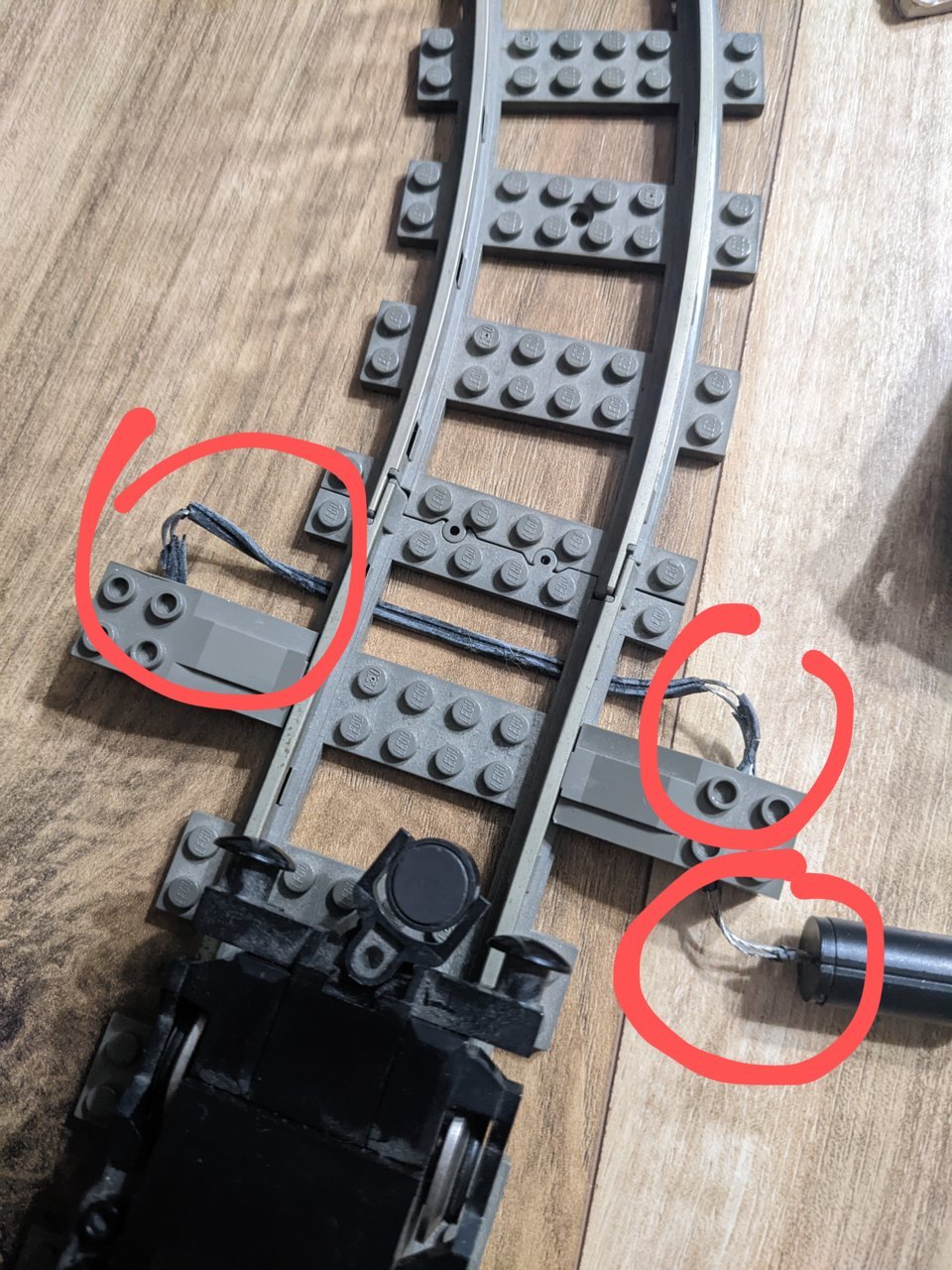

    Help!
    I busted this guy out from storage and it isn't running. There's power going to the controller but the 2 engines I have won't move. I've tried each engin on their own and then both on the track.
    Some of the plastic has worn off but the wires seem intact. I wonder if the metal on the tracks and wheels need to be cleaned? If so how?

    #150436
    6,002
    Truck
    Try a rubber eraser. Like you used in school to remove pencil.
    Works wonders on tarnished electrical connections.

    I'm just guessing here but, it looks like the metal in the two wires are touching each other in a couple places. That will cause a short circuit. The controller can probably sense that and is not supplying any power?
    It's not super dangerous but, it is risky since could cause sparks if used like that. Wrap the wires with electrical tape or even scotch tape to see if it works.

    So here's how you could repair this, if you're handy with a soldering iron.
    1 replace the wires, or 2 clean the wires up, snip one end of each, slip over enough heatshrink to cover the whole length, resolder, then heat shrink the whole length.
