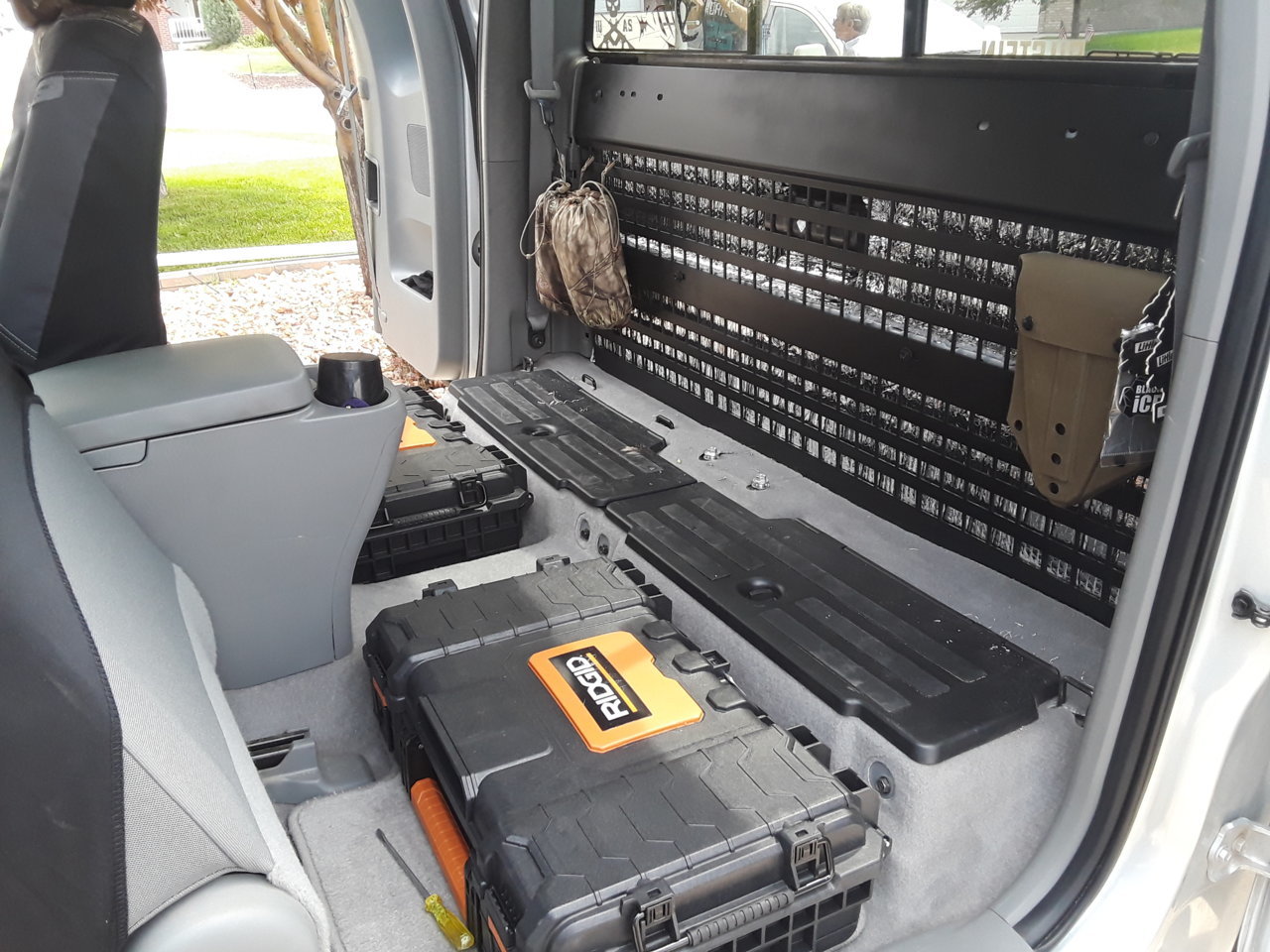

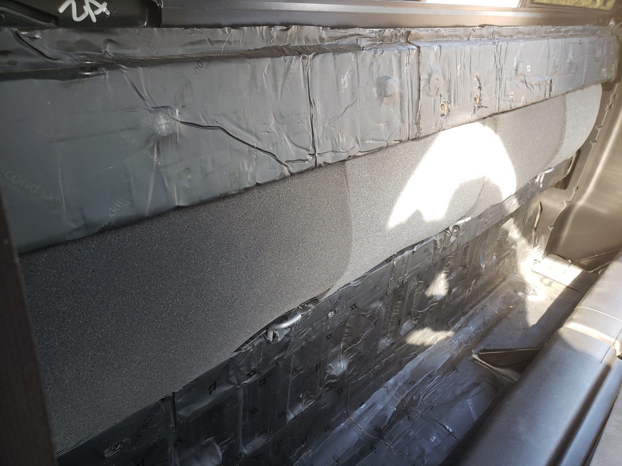

    Here is mine installed raw, with sound proofing applied under/behind it. Great product for sure! 20180708_132952.jpg 20180708_133024.jpg

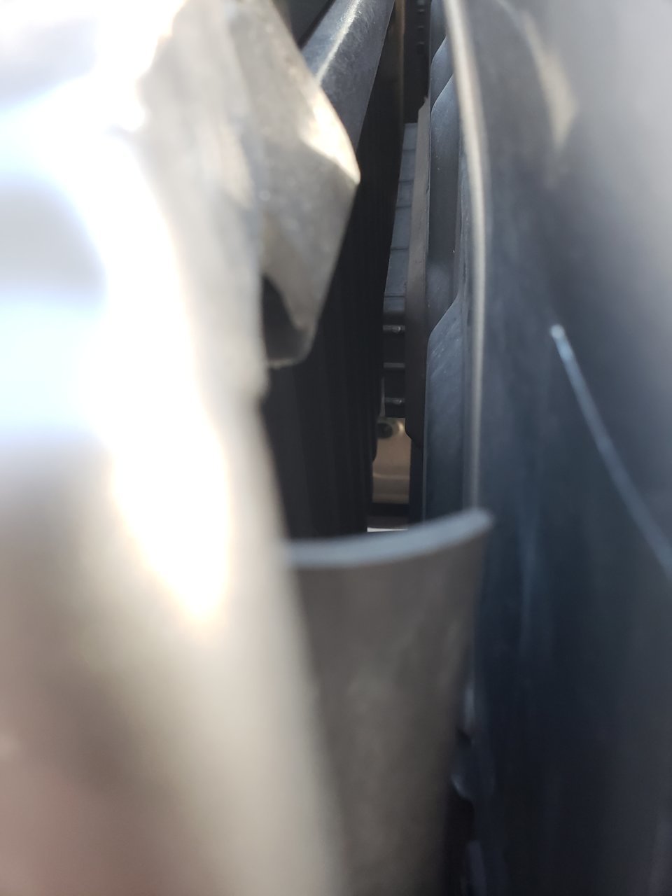

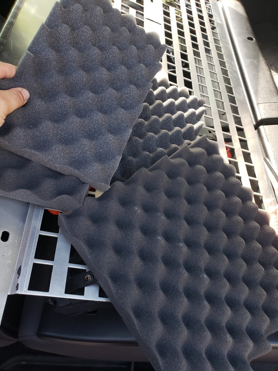

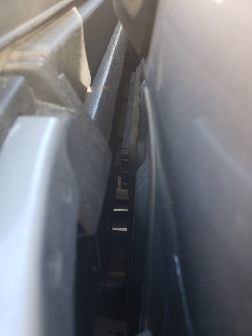

    20180708_075919.jpg 20180708_075724.jpg 20180708_080526.jpg 20180708_081039.jpg 20180708_075819.jpg 20180708_075910.jpg Finally broke down and added some open cell foam for baffling the air vents. HUGE improvement over just the damping material.
    Small green rectangle of "seat cushion" type foam stuffed inside the vents themselves (make sure you don't force the vents open when stuffing). Then cut down some eggcrate and fill the top groove. it'll take 4x 12in pieces, and then 1in of scrap You'll have some leftover to do with what you want if you start with 4x 12in squares.
    Now, whether or not recirc is turned on, it's quieter than factory. :)
