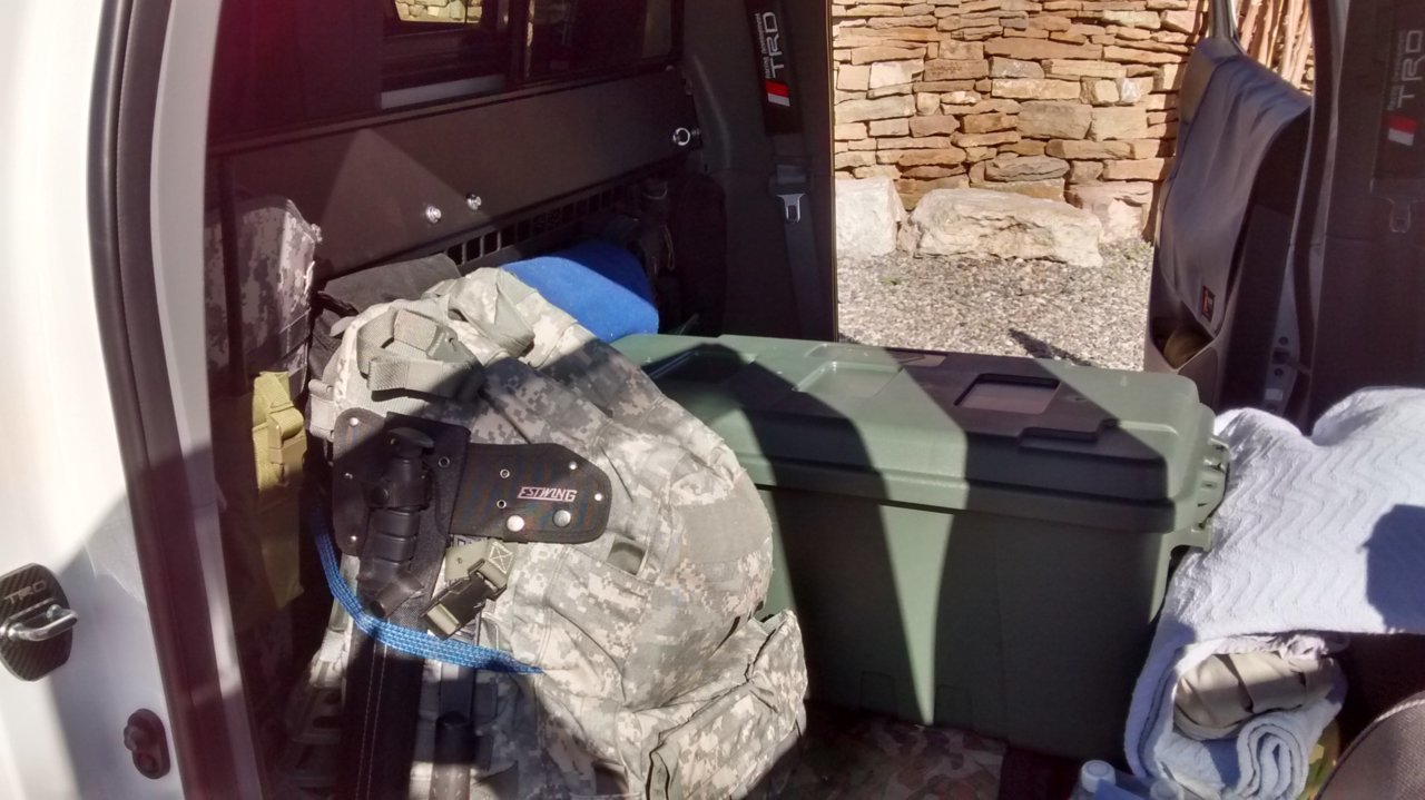

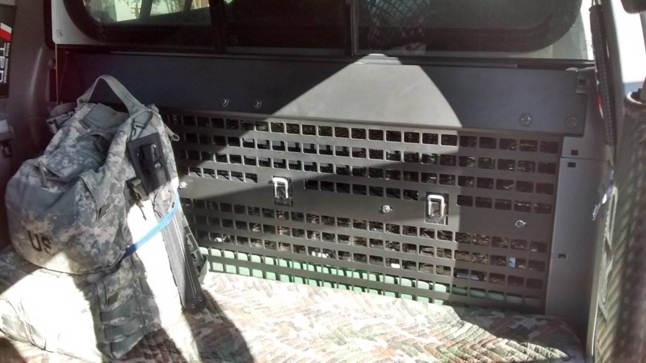

    From GB #15, molle panel_190814_17;40;21.jpg molle panel-200409_09;32;30.jpg molle panel-200409_09;32;42.jpg molle panel-200409_09;34;30.jpg I used Noico 80 mil black and put a piece of green army foam pad at the bottom so it would not vibrate...Then the finished setup...I have a blanket that goes on the green Plano box into the camper shell for my dogs.

    Looking sharp!

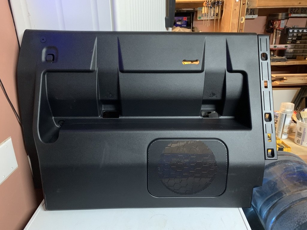

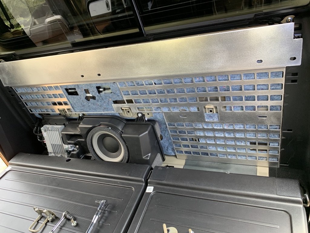

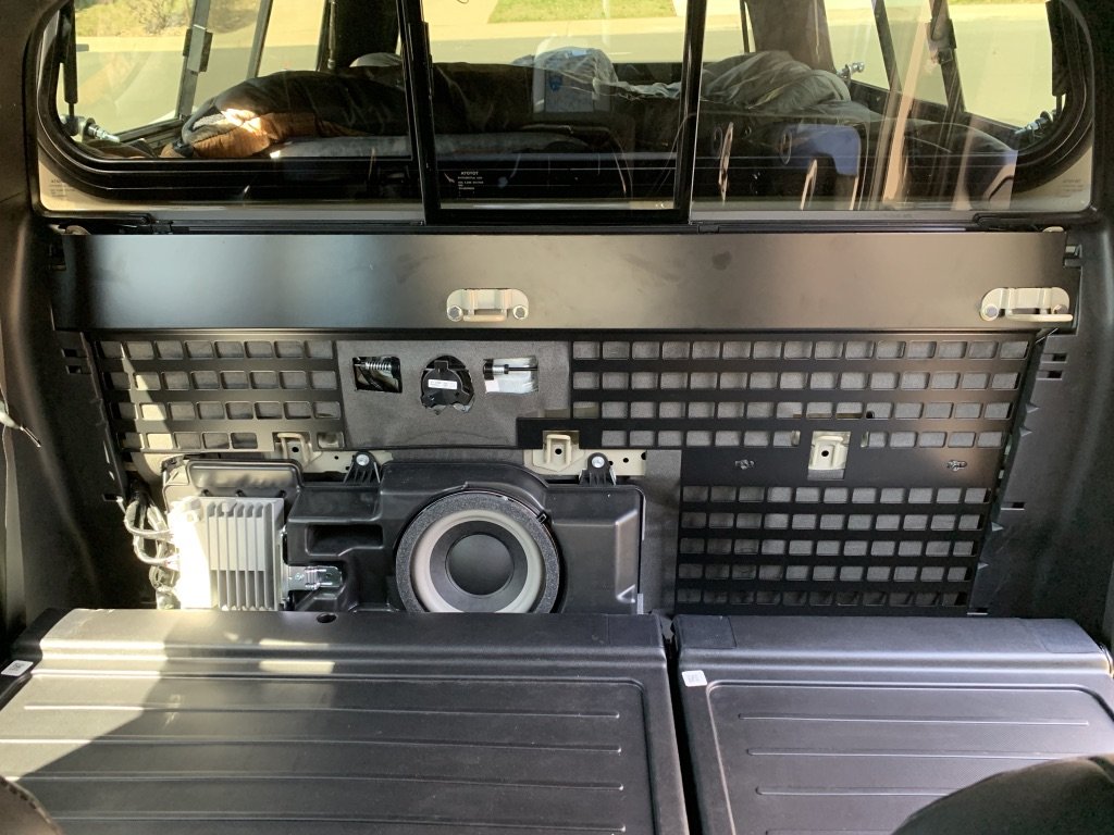

    I did 1/4" dynamat. I did need the longer M8x 1.25 screws from BelMetric to reinstall the seat latches over the 1/4" dynamat. There was 1/2" Dynamat but I thought that might be too thick? The sheet of 1/4" Dynmat that I cut did drop down behind the sub/amp enclosure, which is the same thing the blue OEM sheet did. This was the best reason to use 1/4" instead of 1/2" Dynamat.
    What are other power window + sub owners doing to recover their sub and amp enclosure? My options so far include cutting the lower half off the OEM panel, or recreating the lower panel in either wood or a custom mold...
    @MESO This is screaming for some of your custom work. I don't like any of my options so far...
