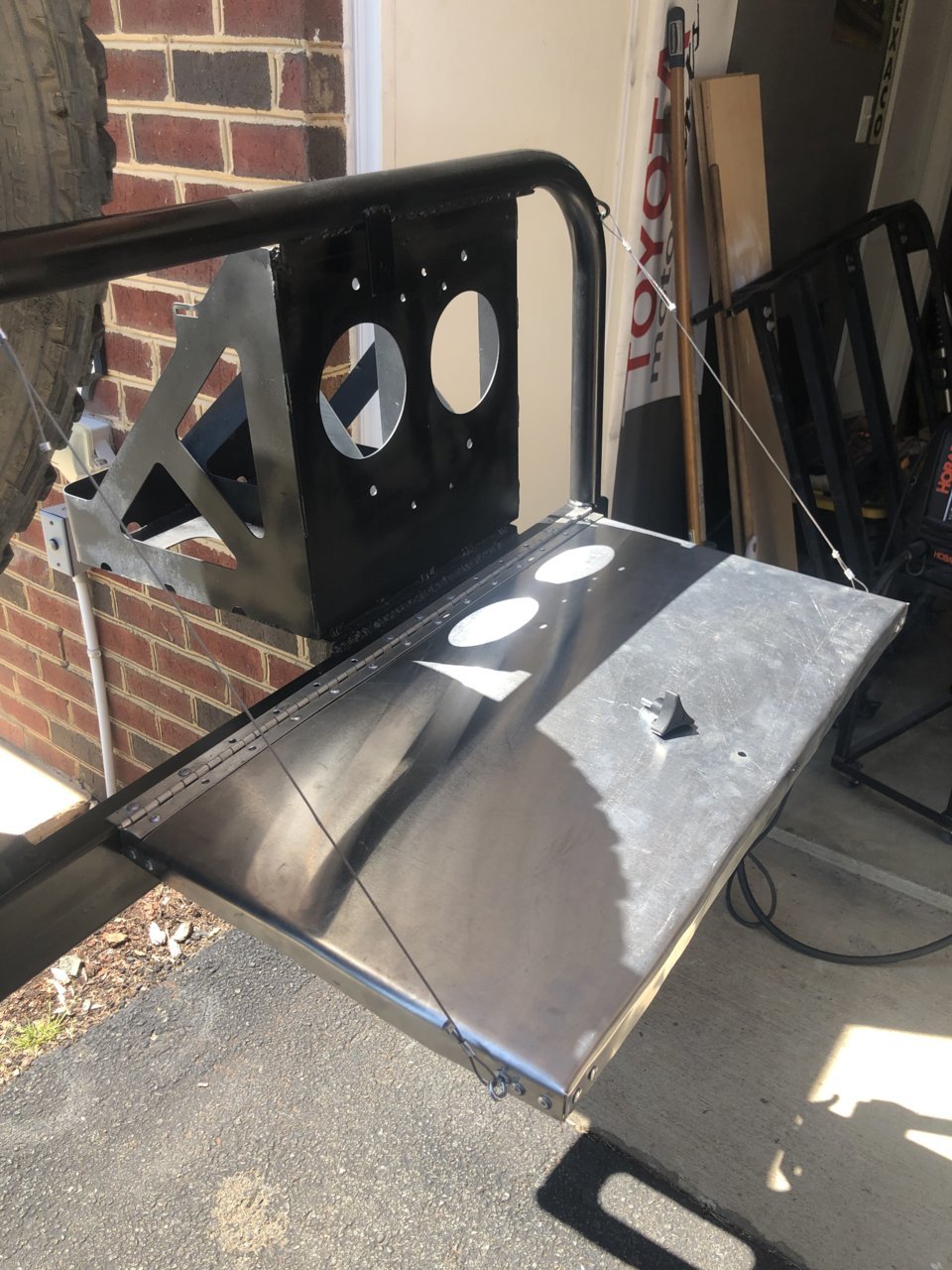

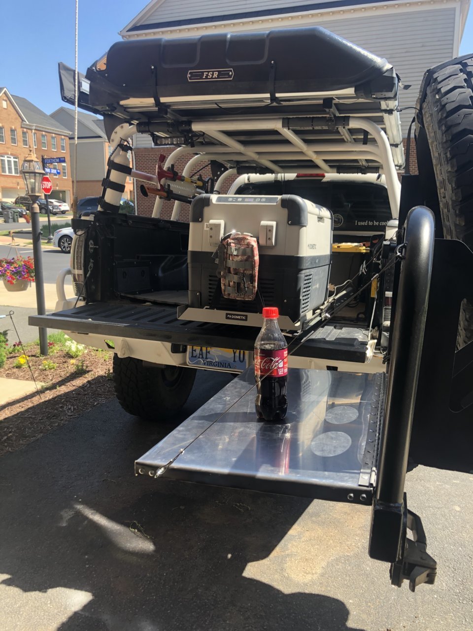

    Id rather build it myself or support a vendor on here.. The Molle panel that @docloco makes fits awesome and it does its job.
    Just like the swingout table that I just made. Already had several people ask me where i got it - made it with my bare hands..
    Slashaar and docloco[OP] like this.

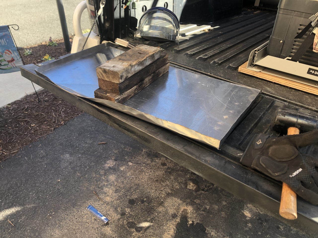

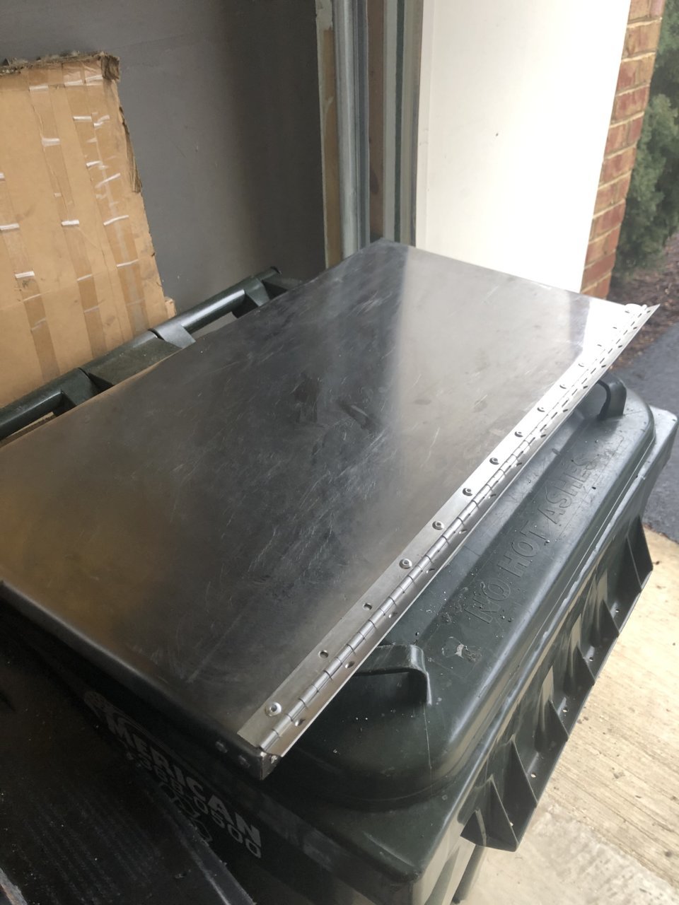

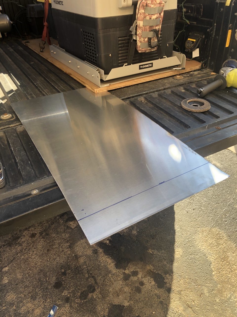

    Thats the whole table. The most expensive part would be the piece of stainless (it was given to me, so Im unsure of the actual cost. My guess is around $30), rivets, 1/2" aluminum L brackets, aluminum piano hinge, 1/16" stainless wire, aluminum eye bolts, and some aluminum ferrules. My guess is around $70 including the stainless sheet.
    Started with a flat piece, bent up 1" around on 4 sides. Riveted in the L brackets and hinge. Then a couple months later when winter passed, added the stainless wire

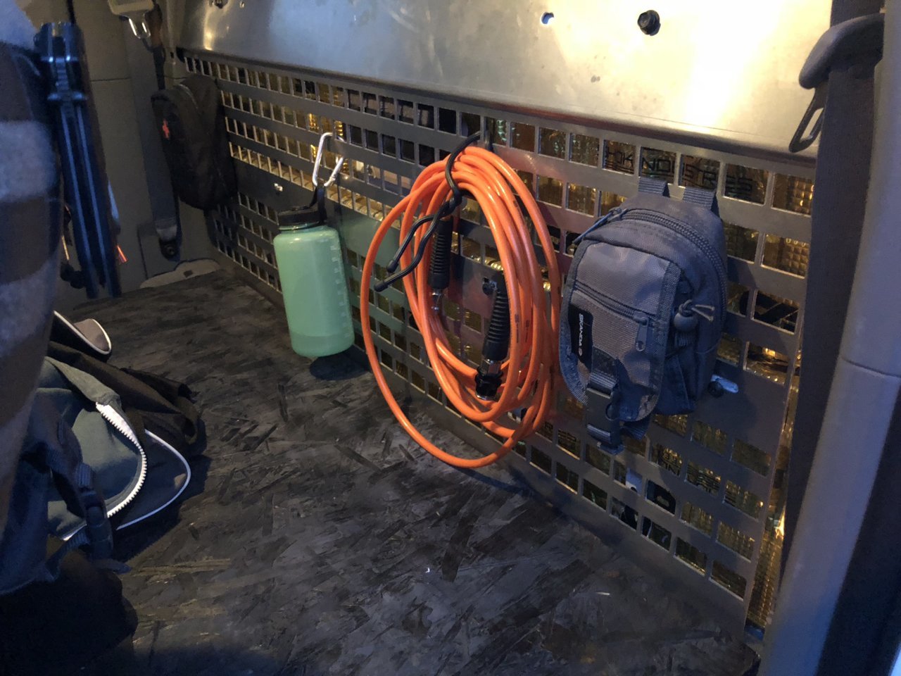

    @docloco found another picture from when i had installed mine. 2010 AC

    What do you have for the flooring there?
