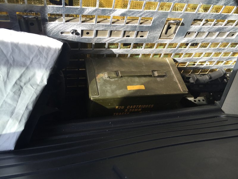

    How much room is there at the bottom? Enough for a 50 cal ammo can?

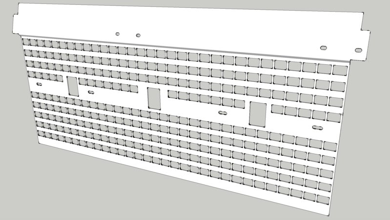

    Final design. If you haven't paid, now it is time to submit those. This order will promptly be submitted 3/21. All orders must be paid by 12 am the night before.

    Hell yeah! So what changes did you end up making? I love how it looks.

    I widened and adjusted placement of some of the screw holes, removed the bottom lip, lined up the 3 big holes for the child seat latches, trimmed 1/4" off the top right, removed the MOLLE holes that were useless in the center row once mounted, and made the 2 top recessed cuts to allow room for the side plastic trims.

    Man thats awesome. Are you planning on having the shop do that work before they ship out?

    I've already updated the CAD file with all the adjustments. I'll be sending those in tomorrow or Monday.
