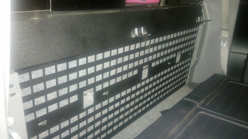

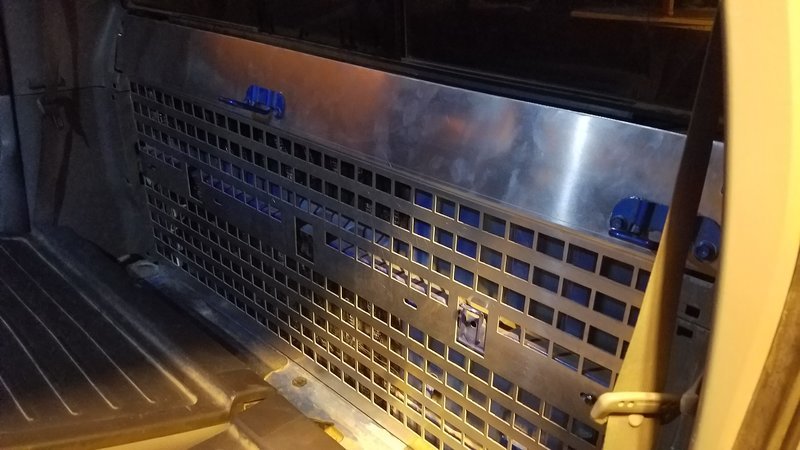

    Threw some left over carpet back there and used two bed liner paint cans. Only used 4 of the old bolts from the plastic bins. Is that correct?

    You are correct.

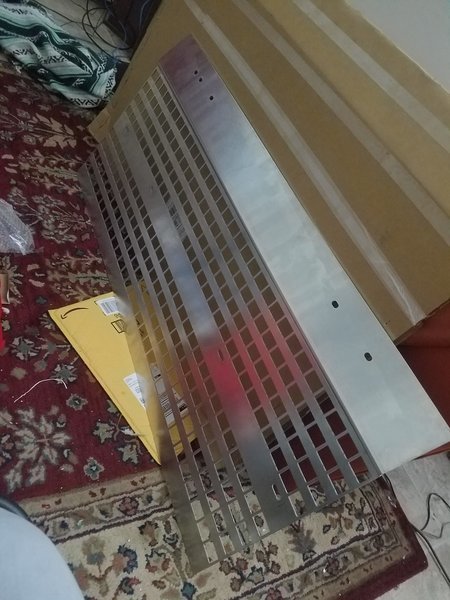

    My panel arrived the other day. I've really been looking forward to this mod. Now I just need to find the time to do some sound proofing and install this bad boy. Big thanks to @docloco for executing this group buy!

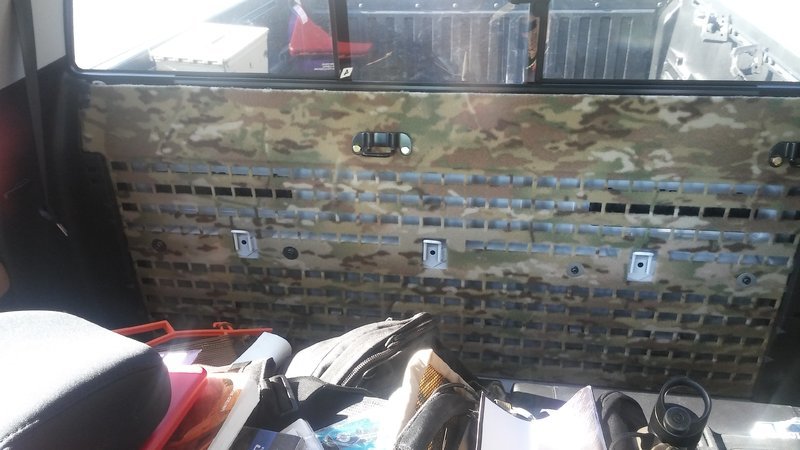

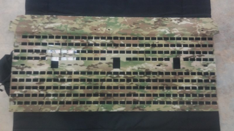

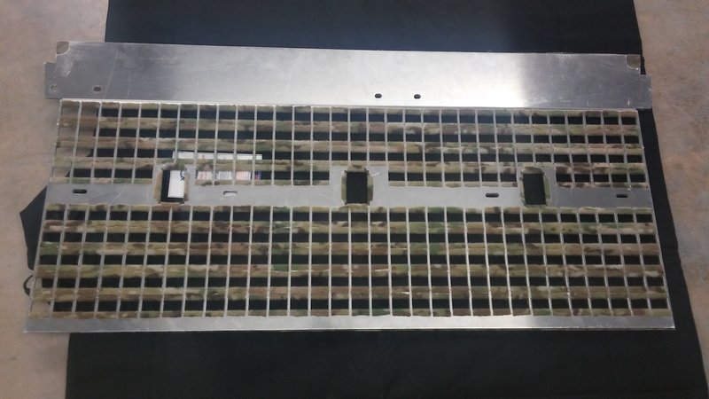

    Got mine put in today. Glued multicam velcro to it then cut each hole with a hotknife. Took forever but glad i took the time. I cut each hole in an H pattern then glued the flaps to the back for extra strength. Took about 4 hours and a few beers. I will get the black soundproofing in tomorrow and it should look much better. 20170408_174144.jpg 20170408_172947.jpg 20170408_173012.jpg

    I think you just helped me decide whether to get the black or silver sound deadener. Where'd you get the velcro???

    I got this velcro from the milspec monkey store. $50 a yard and it is just enough to do the job with a 4" or so strip left over. If you want black velcro you can get it at rockywoods fabrics for a little less than $20 a yard. I run a small custom tactical gear shop so I already had the multicam velcro otherwise i probably would have done black.

    Which side did you use, the hook or the loop?

    I use loop. Most velcro pouches, patches, and gadgets have hook on them so you want loop for it to stick to.
