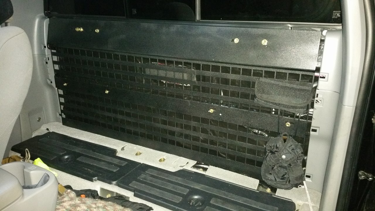

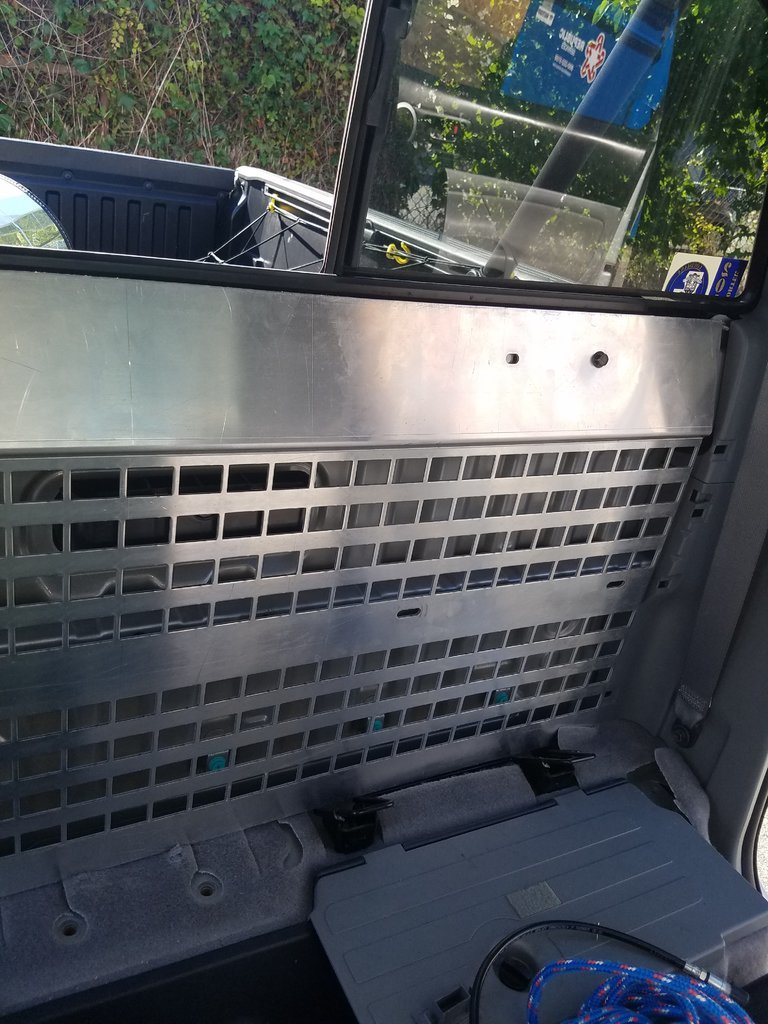

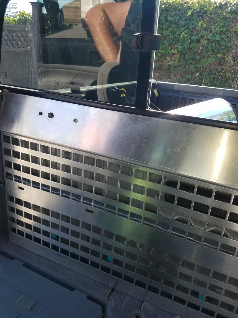

    Hey @docloco Dunnop if this is the right place for this or not, Sorry it's late but here's my review of the panel I bought and installed from you.
    I received my panel it was shipped in a cardboard sleeve and fortunately the carrier fallowed the "DO NOT BEND" instructions written on the side it arrived in great shape.
    My panel was ordered plain aluminum as I didn't trust the powder coat to last in the shipping.

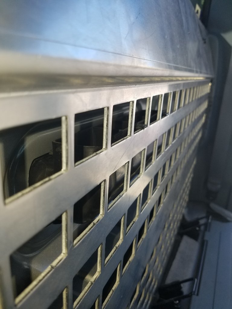

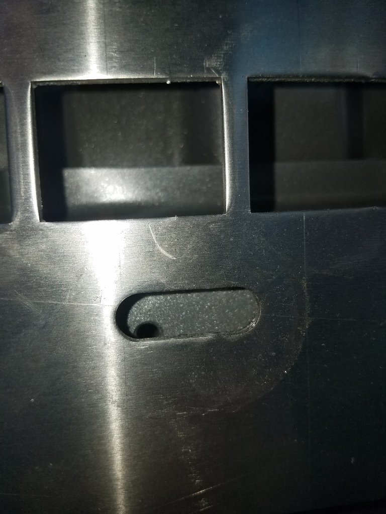

    The panel is perfectly machined, unfortunately the panel is PERFECTLY MACHINED!!! Seriously this thing is laser sharp new!
    So I'm glad I ordered it bare as I spent about 2-3 hours with a file knocking off the sharp edges from all the holes and the outside. I had concern that the edges, weight of the gear, and vibration of the truck, would lead to cutting through the webbing on my bags etc.

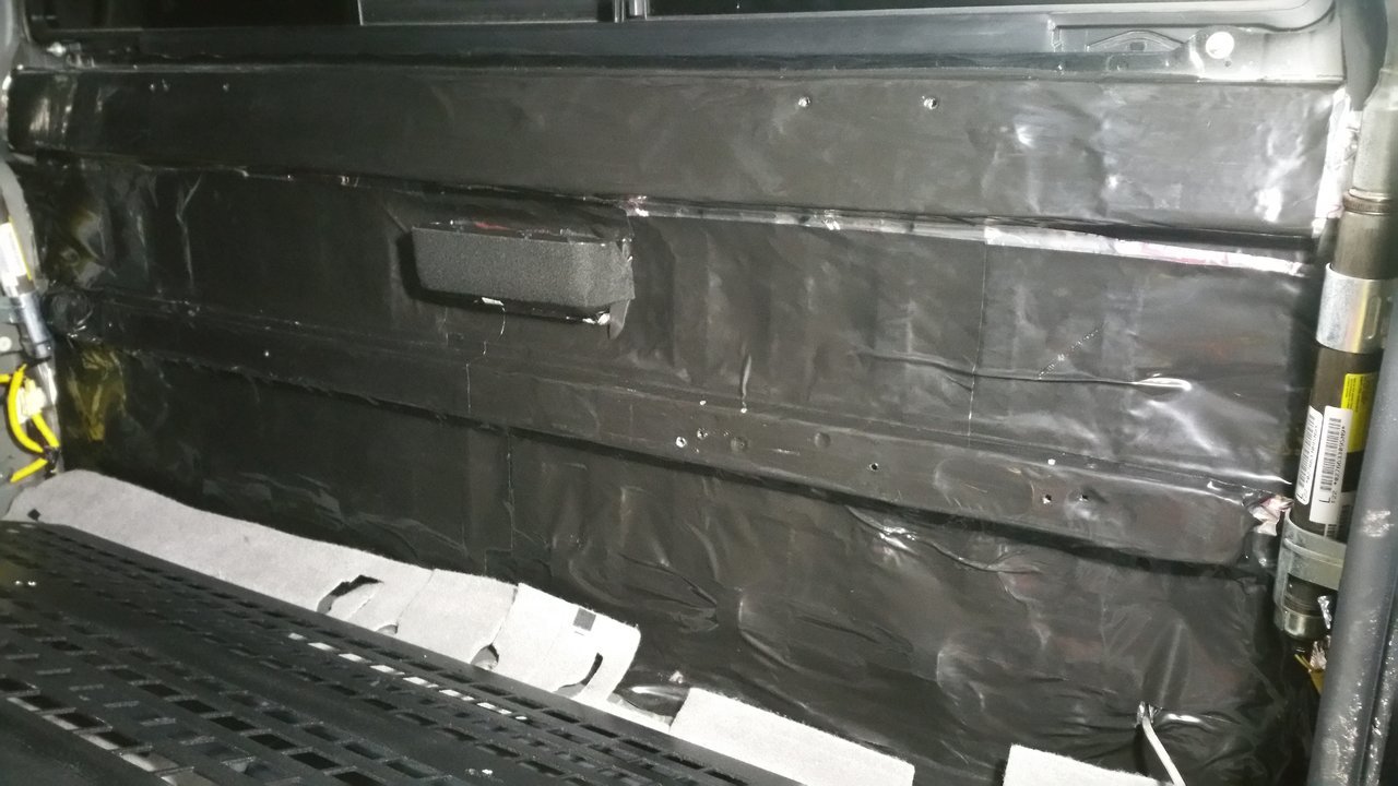

    As other have mentioned sound deadening is a MUST!

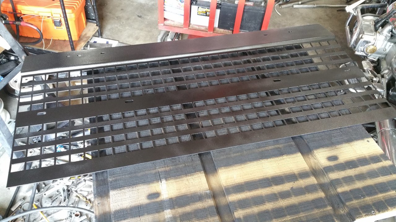

    I painted my panel with Rustoleum Bed Liner spray paint.

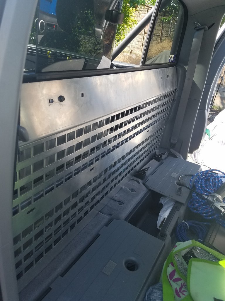

    When mounting I did ended up having to drill out a few holes to get it to fit, considering how vehicles are glued together in assembly it's not really surprising. The aluminum is very easy to drill out.
    I love my rack and have been slowly accumulating and adding Molle gear. Fit is great and versatility is great!
    Test fit wit the only holes that lined up bolted.

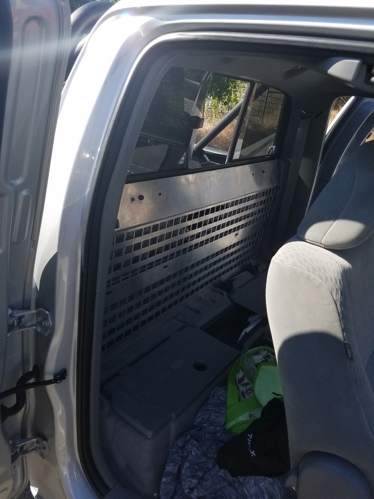

    Added A finalized pic:

    Is that homeade sound deadening?
    docloco[OP] likes this.
  19. Oct 9, 2017 at 8:03 PM
    #1839
    Key-Rei
    Key-Rei Well-Known Member
    Jun 20, 2017
    #221942
    7,863
    Key
    Florida
    2010 TRD Off-Road 6Spd 4x4 209BSM
    Locker anytime Fog Lights anytime Full LED light conversion TRD cat back Rear cat delete Exaust Y reroute away from actuator Alloy Clutch master 2000 4Runner "Dog Leg" shift leaver Marlin shift seats and bushing Rear seat delete Rear diff breather extension Chrome grille swap Debadge Rear seat delete Honda blower motor beefy plug and wire mod Anytime 12v and USB with volt gauge in bed Blue Sea fuse box Hella AND 70's Caddy horns Low profile recessed hex drain plug swaps Alluminum battery strap 7pin relocated Backup cam on anytime Various other creature comfort and personal taste mods.
    Lol, kinda, I didn't want logo's showing through my panel, it's a layer of aluminum tape direct to the cleaned bulkhead, then a layer of 1/16 butyl rubber window flashing from home depot, another layer of aluminum tape and then two layers of the same butyl rubber flashing. Cheaper than buying name brand deadening and it's made from butyl rubber like the name brand stuff not tar biased.
    Works quite well actually!
