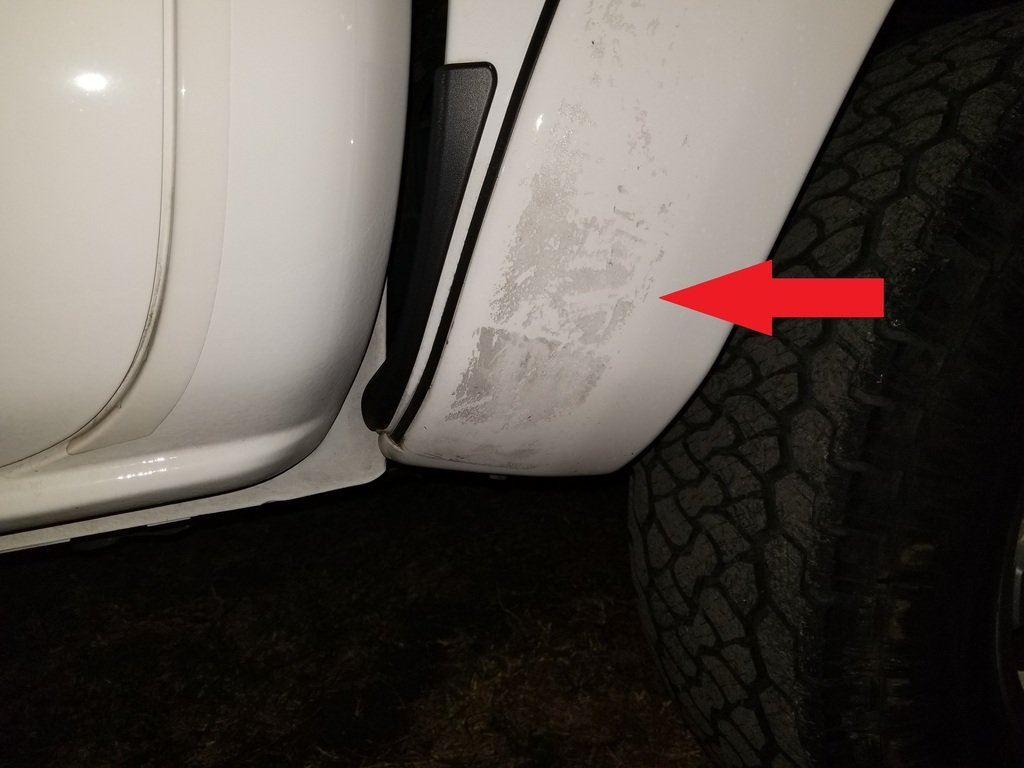

    I removed the protective decals at the base of my truck because they were getting dirty around the edges. I have tried to remove the hell goo that remained with goof off, WD40, Permatex Decal & Adhesive Remover (w/ a magic eraser), and gasoline. It refuses to go to the underworld from whence it came.
    Short of trading in the truck, sandblasting, or blow torching it off, does any one have a suggestion?

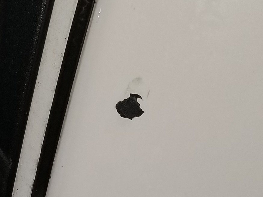

    I wound up ordering the eraser wheel that Misplaced suggested. It's made out of a similar material to a kids gummy art eraser, which made me wonder if one of those wouldn't work for a smaller project. While the wheel's learning curve is short, it is pronounced. I managed to cook off a 1/3" circle of paint before I got the technique down. The passenger side of the truck was completed in a few minutes, once I knew what to do.
    For my application, which was purely goo removal, and not decal, I would suggest the following:
    · I used it on the #2 setting on a Dewalt cordless to prevent cooking, and wheel explosion
    · Keep it moving. If it sits in one spot too long it gets hot, and it is good-bye paint
    · Do not push too hard, or it is good-bye paint
    · Have a soft cloth handy to wipe eraser dust away to gauge progress
    · Keep the wheel square to the body of the vehicle
    · Wear eye protection. Amazon reviews show a number of exploded wheel pictures
    · The sticky goo that was dirty was easier to remove because I could see it better. One side of the truck was clean of dirt due to my attempts to remove the goo with cleaners. I wound up doing it at night with a flashlight and found the mess easier to see.
    In closing, take your time, don’t be an a$$hole like me, and you should be fine. Thanks for all the suggestions!

    Glad it worked. Someone pointed me to the eraser wheel awhile back. It can fall apart easy but it's quick to learn. How bad is the spot you cooked?! Did it burn the clear?

    Lol, I'd say so. At least I don't see daylight through the damn thing!
