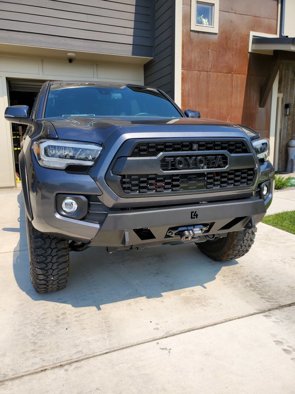

    I just installed my new C4 low pro bumper with warn vr Evo 10s and all works but the wireless. I push and hold button till light comes on but I get no in or out when trying to use. What am I missing?
    Works with cord
    No worky with wireless
