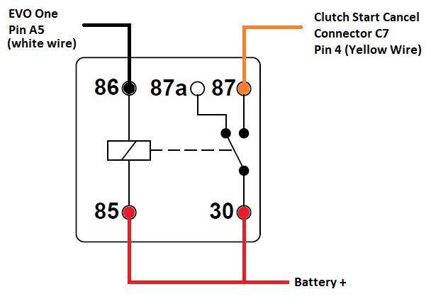

    Guess you missed mine. I’ve had mine installed on my 2017 6MT for about a month. Glad you figuared it out though. Interesting thing is you wired yours a little different. So just to add some info, this is what I did:
    There is a negative a starter output wire on the EVO One in the 20 pin white connector pin A5, I used a 5 pin relay since I had some, but a 4 pin is all you need. Battery power connects to the relay coil and pin 30, then white wire from EVO One pin A5 goes to the other side of the relay coil and relay pin 87 goes to clutch start cancel switch connector C7 pin 4. Like this:
