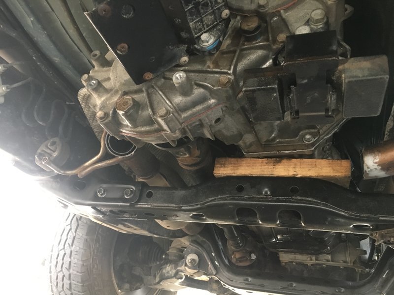

    IMG_2686.jpg Here is the current transmission mount.. lol

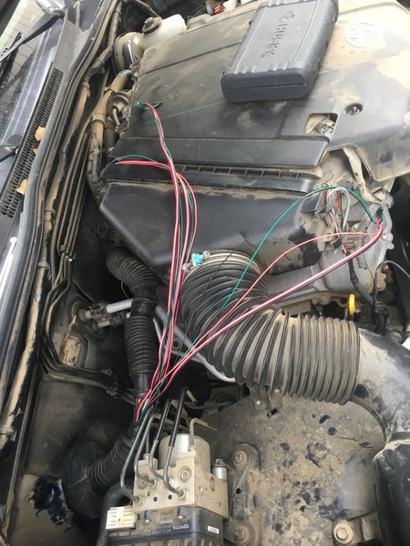

    Took about 4 hrs to finish up the wiring. Got the last of it done and one more step checked off. With a little fighting got all the wireing through the factory gasket. IMG_2685.jpg
    Looking at the carrier barring mount it could be moved back if it has to. The factory probably used the rear mounting holes

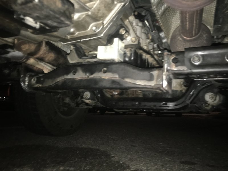

    Project completed!! Woo:goingcrazy:im a4x4 now!!
    Thanks to @3378jakesr5 for helping finishing up the welding part. IMG_2713.jpg
