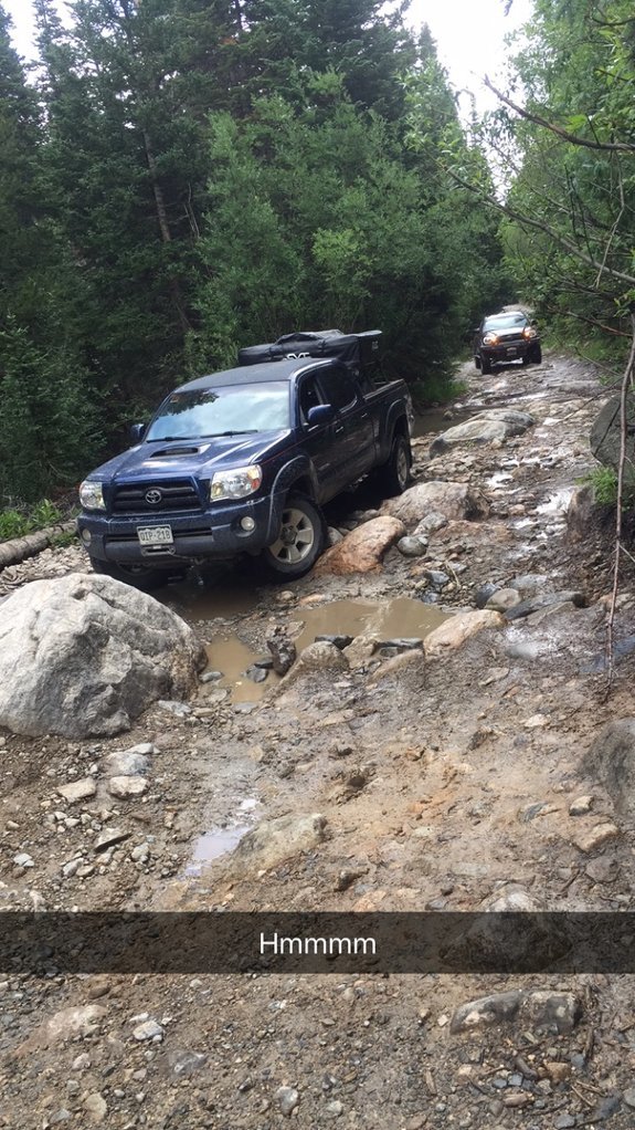

    Well @Coop68 and I tried to go up msv however trail limo problems...
    @3378jakesr5 thers something missing that I needed:boink:

    Sliders :ohsnap:

    :thumbsup: And I need skids badly.. got more rock scars and one good dent under there.
    Oh! And let's not forget a torn off mud flap
    You missed a good time. Had to slide backwards into a camp Spot

    It looked slick as snot there

    Most people go around the rock :p

    I couldn't get angled enough to turn, and with out sliders that driver side rock wound have hit the body.

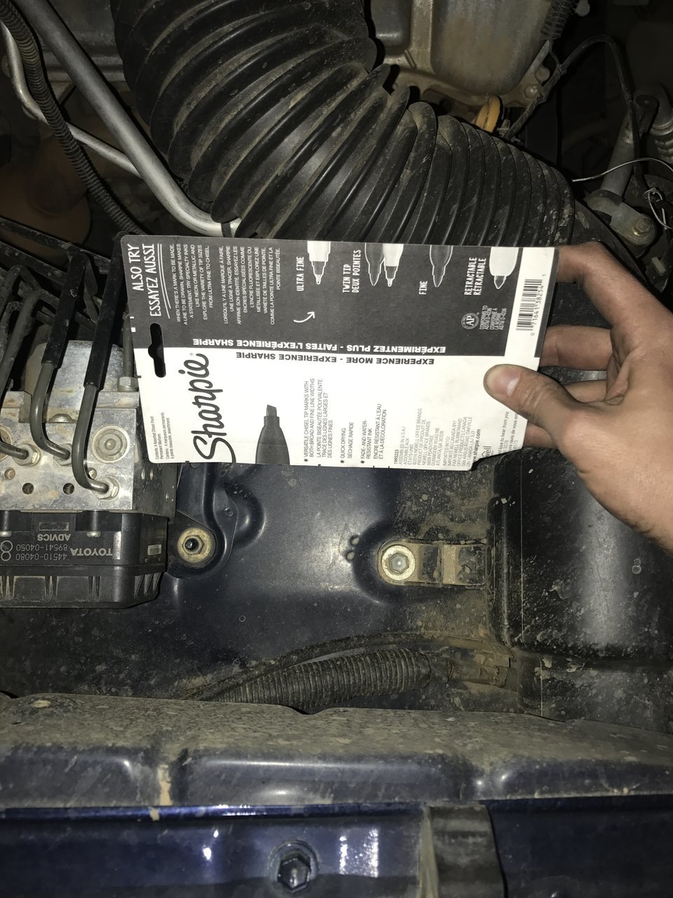

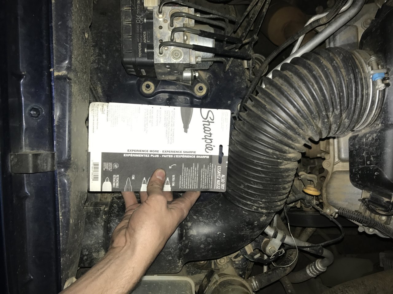

    @Gramps @DaveInDenver so after the talk about the battery, I saw a used battery (group 121) and by rough measuring it looks like it wound fit in the opening between the air tube and the abs pump. All that wound be required to make it fit is a cage and cut the one foot on the air tube
    Or possibly a group 26 battery
    In this pic it wound clear if that one foot is cut back, and becomes a place to bolt to.
    This wound be a tight squeeze for the 121 size it wound be touching the air duct. Not sure on the 26, but it's more square

    The 121 is 600cca with 110 reserve
    The 26 is 540cca with 80 reserve
    I'll run up to parts store tomorrow and see if they'll let me take one outside and test fit it.

    Those numbers are legitimate. The PC1400s that I have are 55 A-hr, 850 CCA, 130 reserve minutes each. So either of those should be fine for back-up starting, no problem. Odyssey's equivalent is a PC1200, which is a 44 A-hr rated battery.

    So I stoped in there and we tried a group 26 and it was to large, if the abs pump could be moved about 2" tords the firewall then it wound fit.
