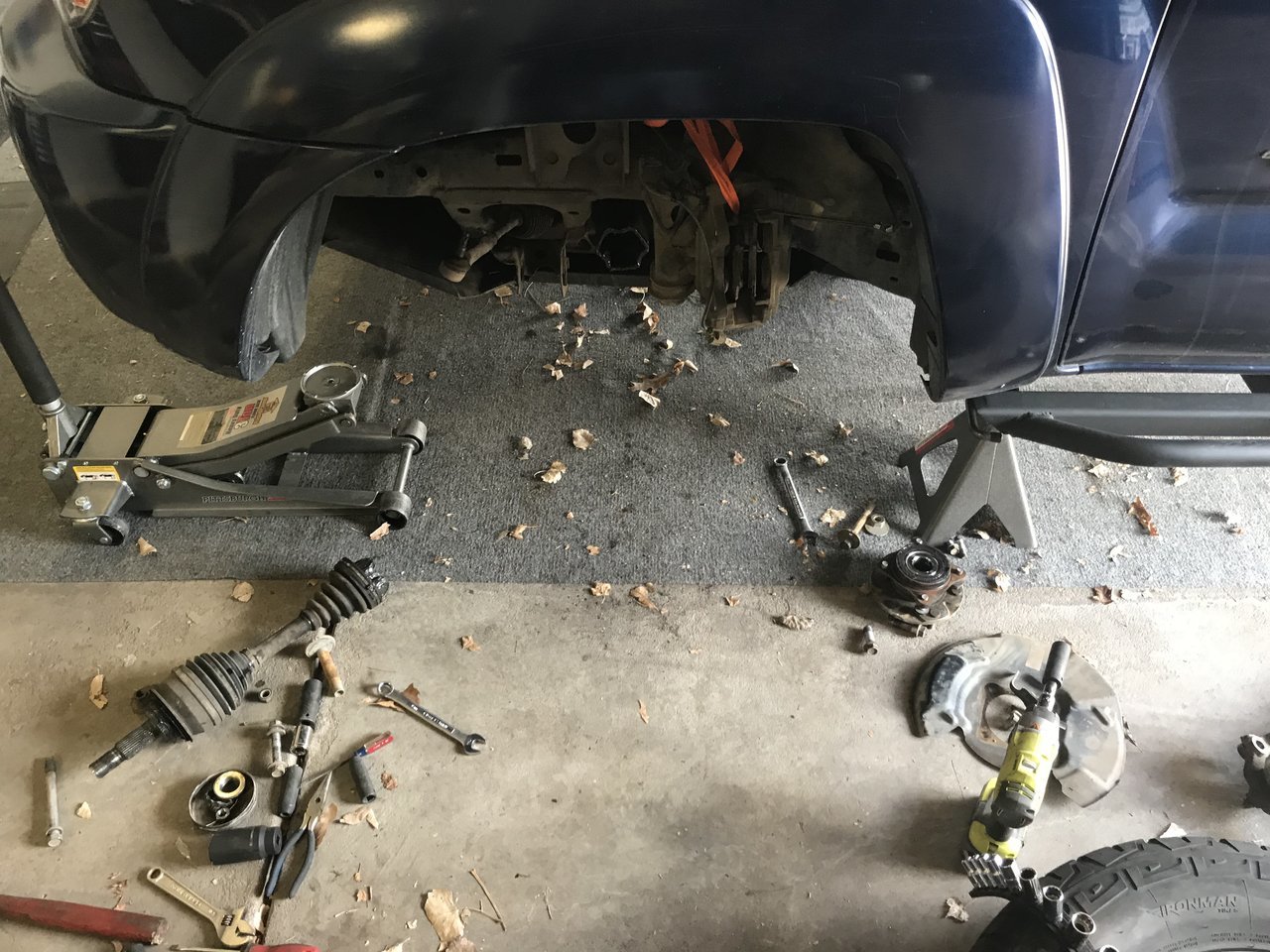

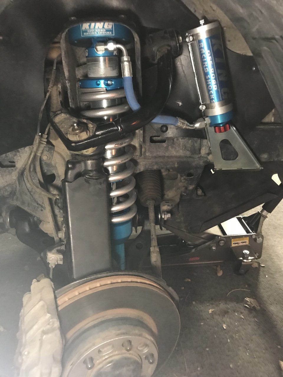

    From ^ to fully rebuilt in 8hrs with help from @CO MTN Steve D8CFEC2A-9575-42B3-B7F5-B047AC164EE1.jpg
    Mileage 111500

    nice where did you end up getting the spindle reinforcements?

    Toytec and had jake weld them up

    Nice Josh, thanks for the education and sorry for having to leave on you in the final stretch.

    It’s cool, I really appeicsted the help.
    Btw the seal on the back of the knuckle is National # 710573 best price so far is Amazon.

    Thanks, I would not of had those to replace them

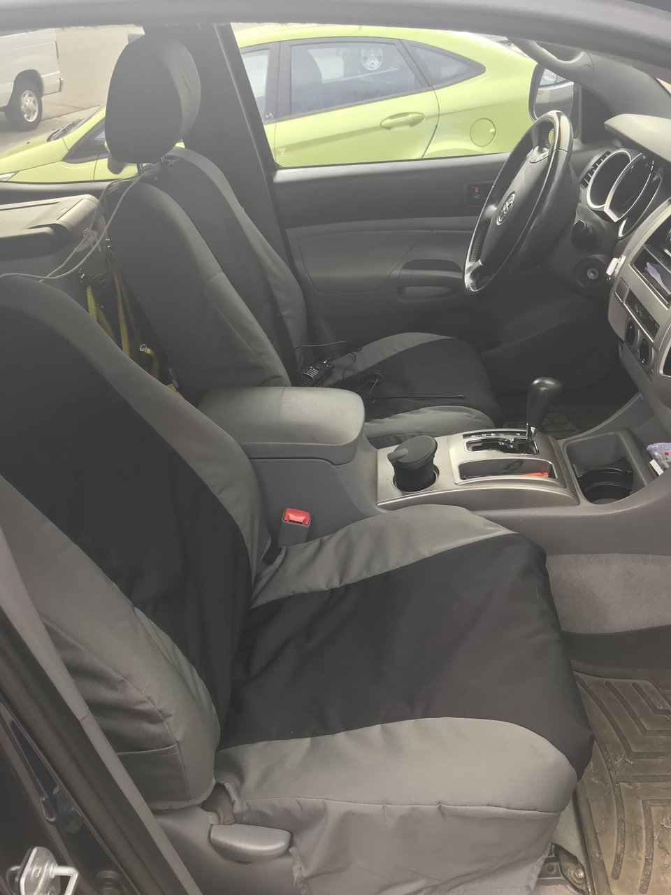

    How did those seat covers work out for you?

    So far so good, will have to teeek them later 0B8D41EF-82FA-49A7-80FB-AD91F9A81ED8.jpg

    Yeah you can tuck all that extra under the plastic end caps to tighten it down.
