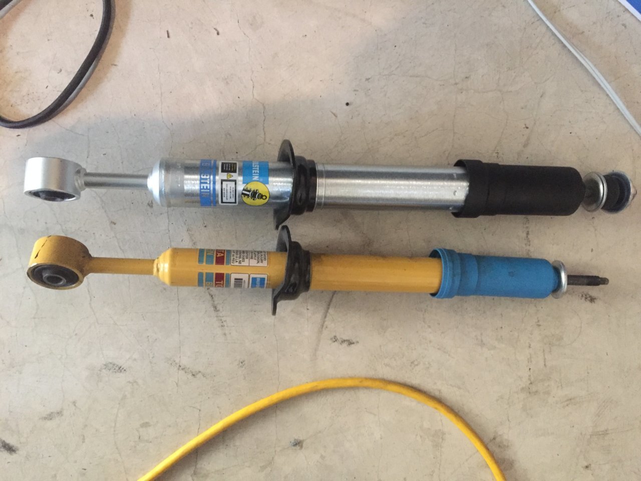

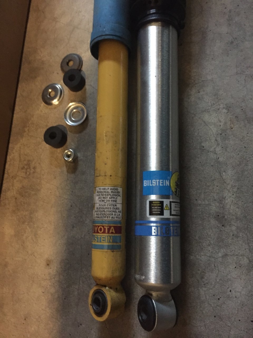

    Not 4600's. They are smaller. This has been discussed before. Let me find the picture....OEM TRD branded Bilsteins vs 5100s (extended length 4600s). The OEM ones appear to be about 3/4 diameter of the 5100/4600 series, which would explain why they fade in about 15 minutes.

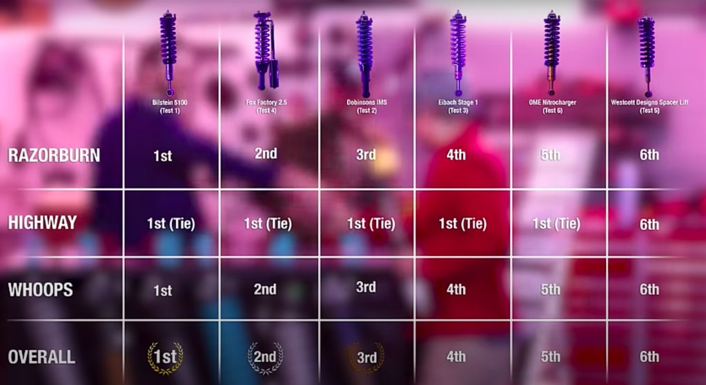

    Watch this review...they did a high end one a few months ago, this one is the budget, and in a few months they will do a mid level (6112 etc.) comparison.
    Affordable Shock Upgrade Shootout - BLIND Tested | Shock Value Season 2 (youtube.com)
