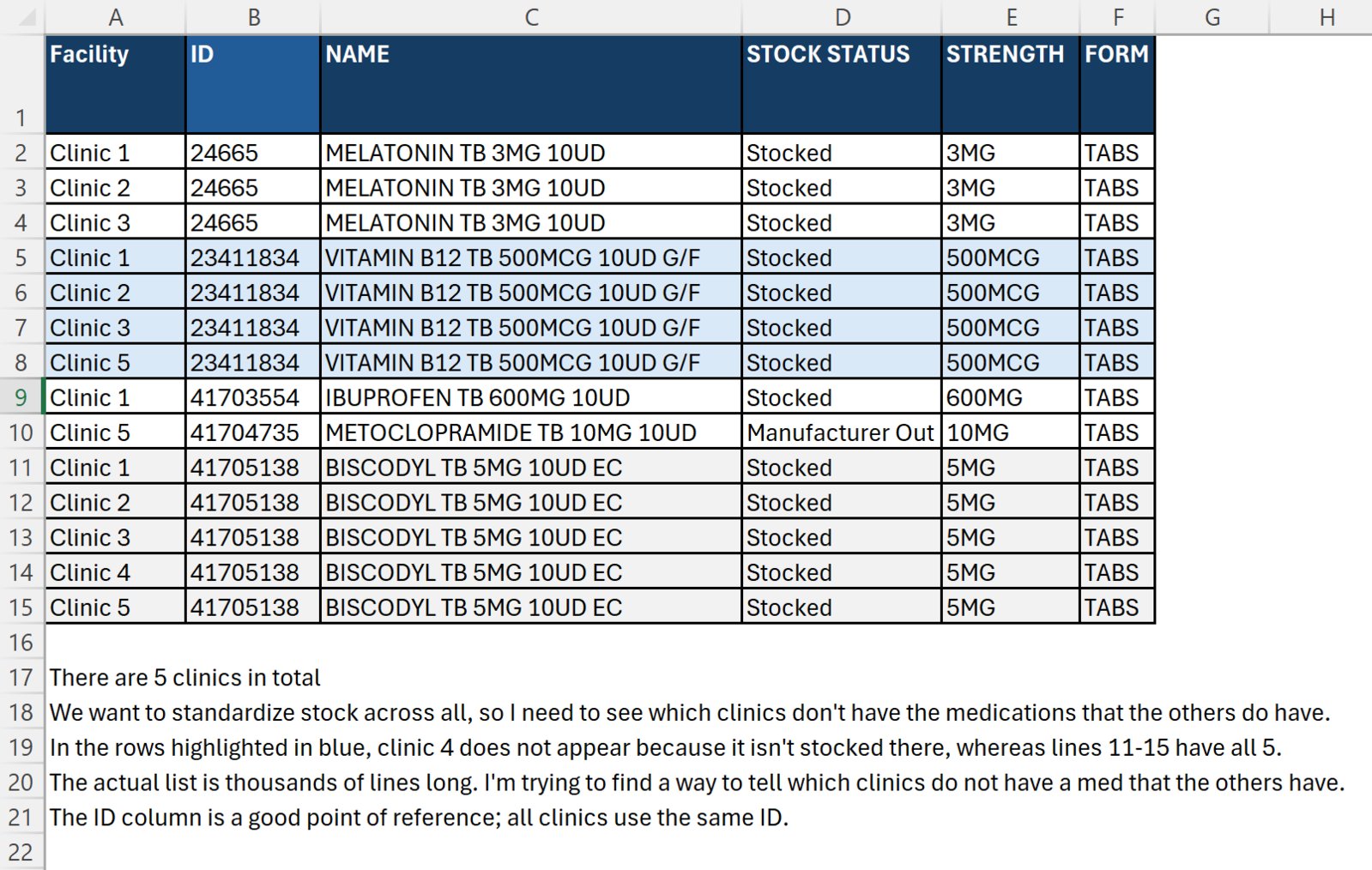

    There are 5 clinics. We want to standardize their med list so they all have the same meds (within reason). I've got a list of their inventory and want to note which clinic does not have a med that others do. More explanations below the table. I've thought of Index/Match, If/Then statements and possibly some type of Pivot table (really don't like pivot tables), but I just can't come up with a way. Any ideas would be appreciated.
    Made up sample of the data, which is several thousand lines long.

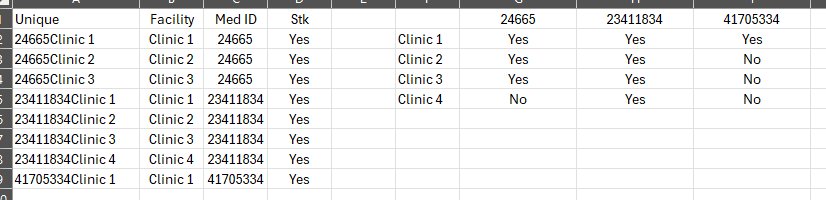

    Create a master list of ID (rows), then each clinic is column. Could use "unique" for that if you don't have it.
    Then you should be able to create an index match at each intersection to bump against your data table.

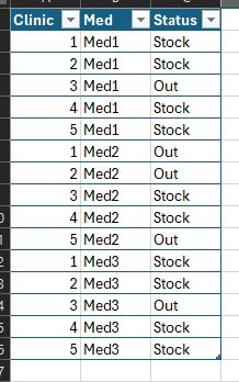

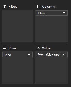

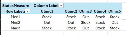

    Make a table
    Make a pivot table, click this box
    Rt Click here, and "Add measure"
    Make this:
    Note the function is CONCATENATEX, with the X.
    make this the pivot table:
    Turn off grand totals and play around with what you want for formatting
    Here you go
    Edit - I made the clinic numbers Clinic1 Clinic2 etc from my first screenshot being 1 2 etc respectively, to see it better and easier and never went back to change that screenshot. Woops.
    916carl[OP] likes this.

    The only data that really matters is the Facility and Med ID. The Med ID is unique to each medication. If it's in stock or not doesn't factor in at this point. All I need is what clinic doesn't have a Med ID that the others do (if the clinic doesn't show up for a Med ID, then they don't have it on their formulary, but should).
    I've tried the index/match @ace_10 mentioned but I'm not seeing how to get the result. The issue with Index/Match is it uses the first match it finds, so using the Med ID will always return the first clinic. Same would happen if I used the clinic name. Unless I missed something he mentioned.
    So, in the table below, Med ID 24665 is on the formulary at clinics 1-3, but not clinic 4 or 5. That's what I need to know, for all Med IDs.

    As someone said above, "unique" the medicine listing and run that along your Y-axis. Then across the top on the X-axis, clinics 1 through 5. In the field, just do some index/matching combined with if/iserror stuff to return either blank cells or populated cells. Conditionally format the blank cells to stand out and you can have what you need VISUALLY. It's kind of a table and kind of visual so it's in a weird space. If you get more medicines, it'll populate the unique field already (that is, if you are formatting the medicine listing in a table and referencing as such, which you should be because it makes your life easier :) )

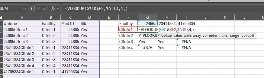

    Another option is to add a unique identifier column for Med/Clinic combination, then one can use VLOOKUP to accomplish what you want by linking the horizontal and vertical lookup criteria such as the formula shown
