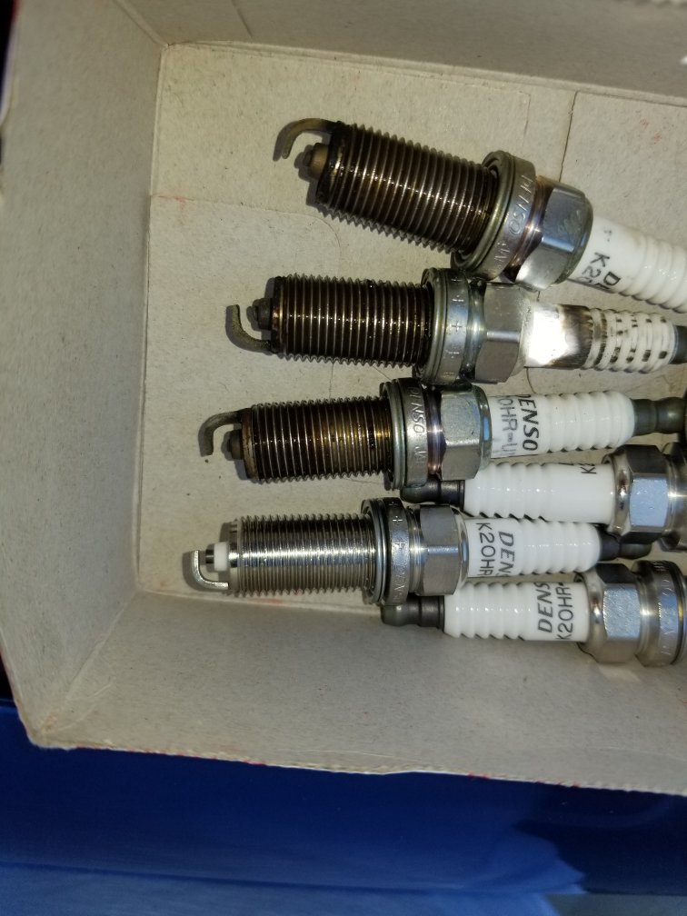

    Soooo basic with just a hand full of swivel and extention combo's. Just watched my son do the 08 1grfe in just over 1/2 hour.
    $3.50 an O.E.M. plug at the dealer.
    Old worn plugs had .090 gap! Still it ran like silkResized_20230513_161842.jpg
