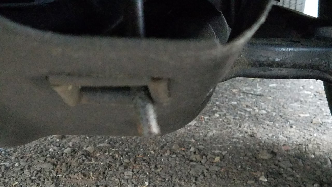

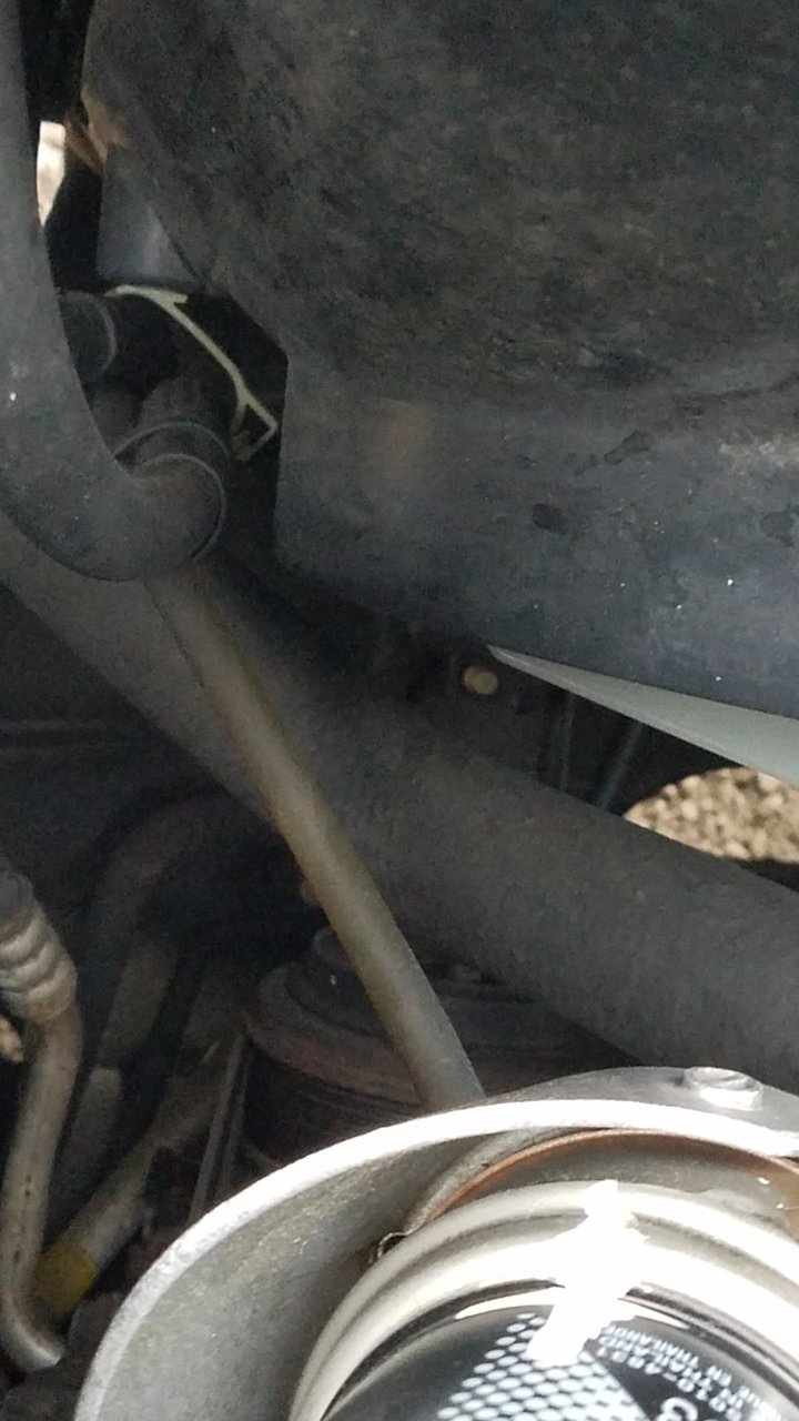

    TOMB
    TOMB Well-Known Member
    Jun 11, 2014
    #131765
    1,345
    Tom
    Newington Ct. 06111
    2013 Access cab Sport -super white
    Changed all drain plugs to Dimple Magnetic plugs UNI filter on air pump
    I lined the square hole in the skid plate with some fuel line . No chafing.
    Pic to follow .
    In use for 5 years .
    Probem solved.
    TOMB
    Stryker420[OP] and BEE-ROCK like this.

    TOMB
    Jun 11, 2014
    #131765
    1,345
    Tom
    Newington Ct. 06111
    20180613_194040.jpg Hose goes from bottom of the oil filter adapter down along the left side of the radiator tie wraped to some hoses and exits through the bottom of the skid plate through a square hole which I have outlined with just a quarter inch gas line to keep the edges from fraying the hose after I drain the oil is for a little carb clean through it goes right through no more dripping =full]2756073[/ATTACH]
    TOMB
    vssman likes this.
