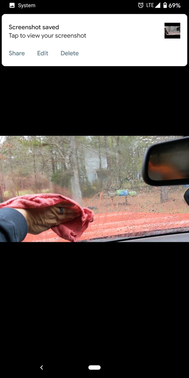

    Have excessive condensation on windshield, anyone else have this kind of issue? Dealer has had truck for a couple of days and they can't duplicate condensation. Can't find any leaks on from or back window. Any thoughts???[​IMG] Screenshot_20200226-131343.jpg
