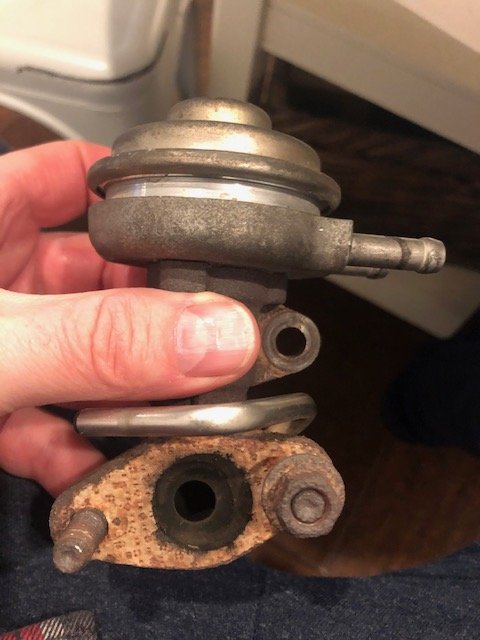

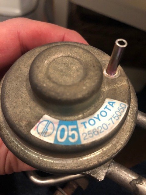

    I was getting an excessive EGR Flow error code, so changed out the EGR Valve and am still getting the same excessive flow error. I was told that an aftermarket, may still get the error. Any ideas on the way to go about getting this error code to turn off and pass smog?'
    These are pic of the old EGR Valve that was getting the error. The new one looks exactly the same - doesn't this look like and OEM part? Not even sure... Sorry, new to the fixin car world...Thanks in advance - Moshdog

  2. Jan 17, 2020 at 5:47 AM
    nzbrock
    nzbrock Well-Known Member
    Jan 6, 2013
    #94572
    3,233
    Noah
    San Marcos, TX
    99 TRD Prerunner 3RZ
    SAW 2.0 Coilovers Wheeler's 5 Leaf + 3 AAL Bilstein 5100s LCE long tube header Flowmaster Delta 50 Muffler FJ Trail Team Wheels 4Runner overhead sunglass console 4Runner leather seats All LED lights Red/Clear Tail Light Tundra Brakes HID Projector Retrofits 4Runner Auto Up/Down Windows Bullet Liner Cargo tie down system E-locker axle swap w/4.56 Gears ARE MX Cap Prinsu Toprac Custom heated turn signal/puddle light mirrors Volant Intake Tube
    It could also be the egr modulator, which is a lot cheaper than the egr valve. The modulator is the black disk looking thing with all the small vacuum lines going to it.

    NZbrock) I cleaned the filter in the modulator and then put it back on. Also bought one that was cheaper and tried that, but I read that it should be the same. So I am waiting before buying a 50.00 new modulator for no reason. I could just try that and hope for the best.
    Whitebutler) If the intake was clogged would that still trigger an excessive flow? I would think it would be the opposite, so I have opted against pulling the intake off for now. Also, I checked the switch coming from the charcoal canister and it was working and out it back on / 401 code.
    Thanks all for helping out, still not sure what it could be...
