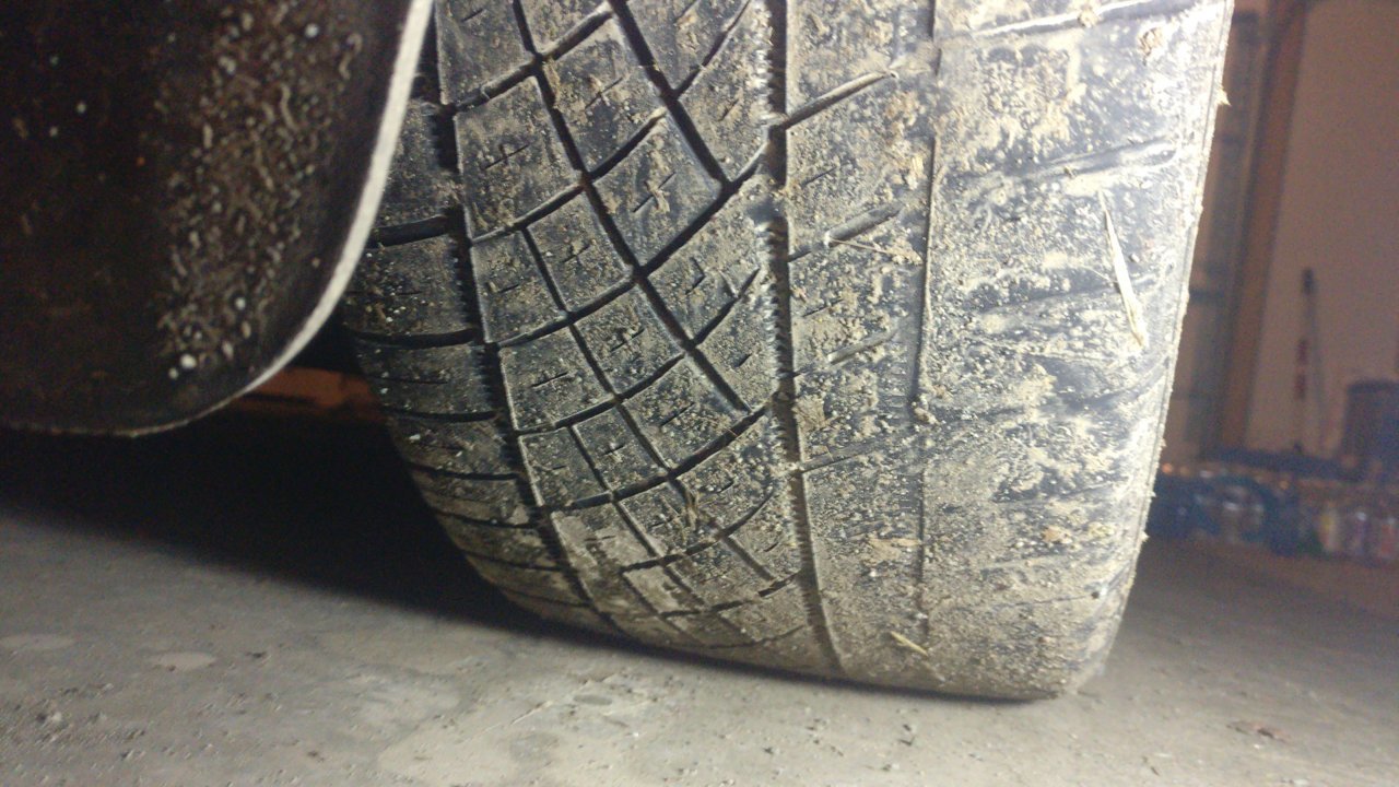

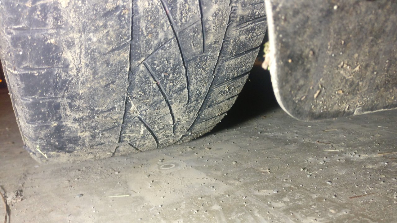

    Here you go:
    On the driver side there is more wear on the outer edge of the tire but on the passenger, it is pretty even/
    So yea, I should get the alignment checked but this is still out of hand -
    Driver's side
    Passenger Side
