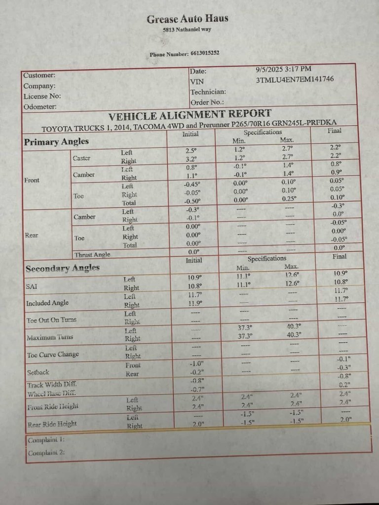

    Let’s see those alignment specs.

    I’ve attached the specs. I believe the truck has 2-2.5 inches of lift

    Lifted trucks can use more caster than spec. They actually removed caster during the alignment which is just the opposite of what they should have done. Caster also is what drives return to center with more being better. Manufacturers tend to limit caster in the specs as it adds to steering effort.

    I understand that. I’ve already had the caster maxed out last time to stop the rubbing. Something tells me has to do with the intermediate shaft or steering rack.

    It could use a tad more caster imo, I'm up around 3-3.5 degs and it drives on rails
    Check the steering shaft universal joint and seeing it's getting sticky from rust. Spray it with wd-40 and see if that helps

    Id start with the alignment first before just throwing parts at it. I’d ask for 3.5-4* of positive caster, 0-.5 positive camber and 0-.5 toe in. My personal truck is 4.0 caster, .5 positive camber and toe in. Everyone is a bit different. What I think feels great others might say it’s a bit tight.
