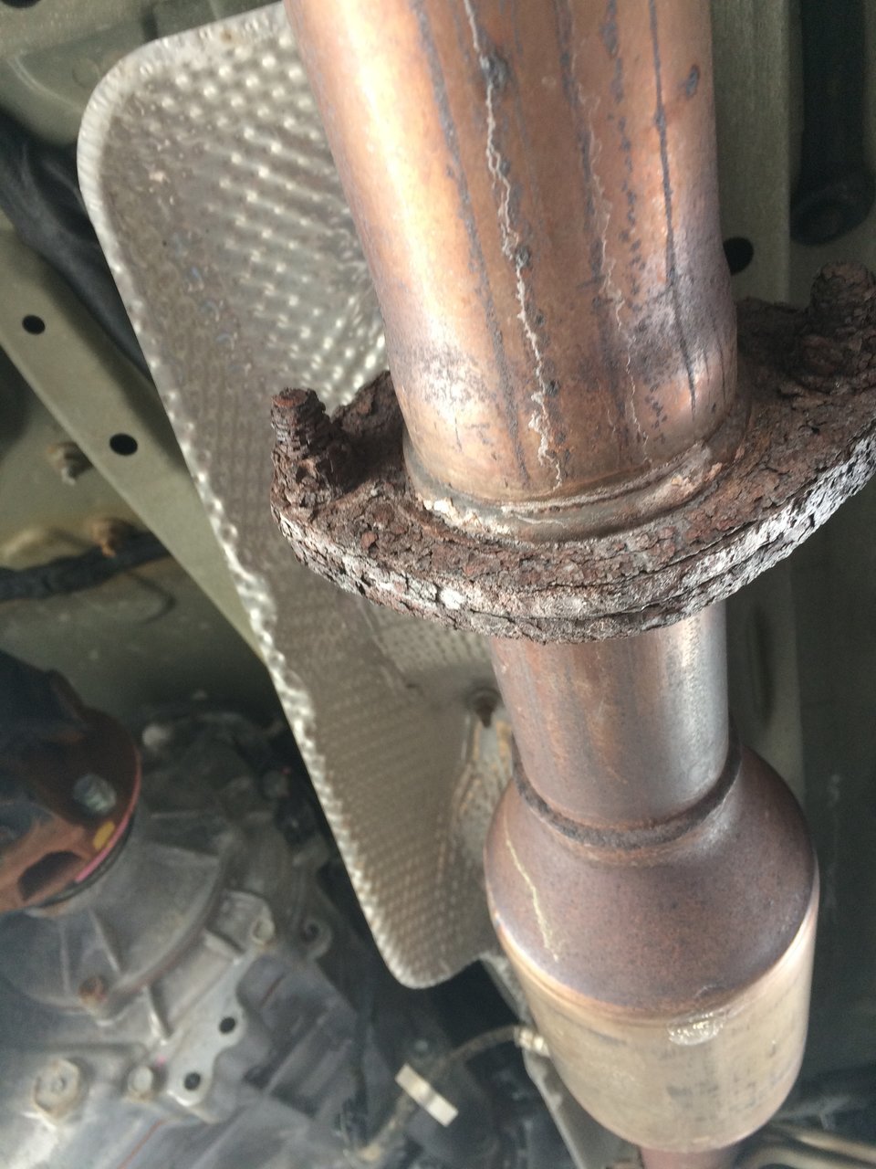

    Yeah that would bug me too. Here’s mine:76862853-0EBA-438C-9DC8-1A462E9EB131.jpg
    Do I win a prize lol

    Yeah, you win.
    So I'm guessing this is normal even in dry warm climates.
    I was just curious, really.

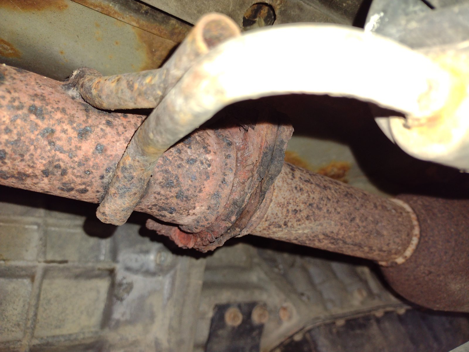

    For comparison here are some photos of my '09 Prerunner with 141k "Florida" miles on it:
    OnHartung'sRoad likes this.

    My 2002 Tacoma looked like that last summer before I sold it too, just surface rust, and it used to be a 65K mile Utah car before I owned it.

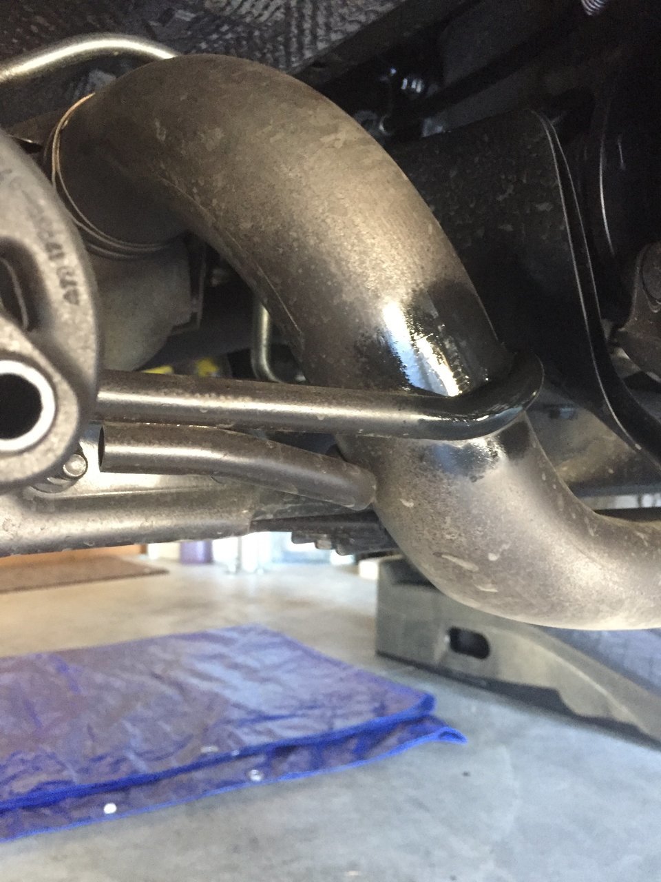

    Mine might be corroding on the inside for the last 7 months, but it looks good on the outside after about 190 wet Pacific Northwest days in that time.
    It was sprayed shortly after purchase and will get a touch up every year or so.
    If you spray your brake drums and wheel hubs, it’ll also keep the insides of your wheels from gaining a layer of rust stain over the years.
    High temp paint is usually good for a few years, even on exhaust manifolds.
    Noticed some rust on a hanger a couple of weeks ago and covered that with rust converter.

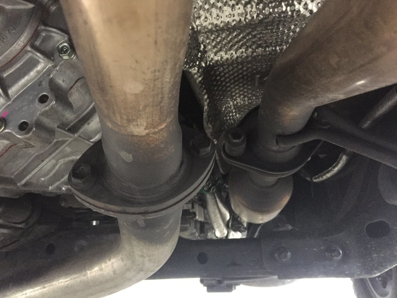

    I think I win the prize. This is the clamp situation on my 2013 taco. This is an old thread but it's helped me to understand (I think) how these pipes are joined. It looks like the clamp with the bolts through it are installed on the pipe behind the flange. Apparently, there is a gasket in there between. I had hoped this clamp was one that attached over the flanges. That would make an easy repair.
    Other than cutting and using a sleeve or welding, how are folks dealing with this? I'm not keen on having to replace the up and downstream exhaust bits. They are all in decent shape. upload_2024-5-7_18-35-55.jpg

    Look for a set of replacement flanges from napa if they have them. Cut off the old crap weld on the new parts with new gaskets and bolts. Something like this.

    Napa sounds like a good idea. Those guys always seem to have what I need.
    I need to do something. There is exhaust blowing out of that joint. It's going to keep getting worse.
