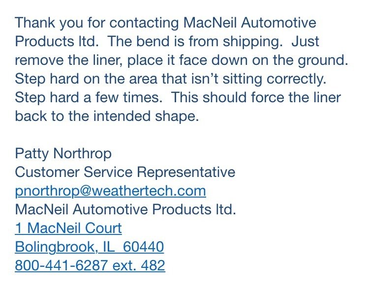

    I prefer the Weathertech rubber floor mats in my truck. And when I put a hole through them they gave me a new set at super discount and free shipping. The WTs in the T4R are a solid fit. I approve of WT :thumbsup:

    My wife said if I try that with her butt, to get it back to the intended shape, she is going to divorce me... wtf..who do I call with a warranty issue on that?

    I haven't read though all the responses so please forgive me if this has already been stated...
    Perhaps the carpet isn't installed exactly right and the locating pins are pulling the driver side line off center. I have a sneaking suspicion that the carpet in my 2015 is shifted to the right about 1/2". The passenger side floor mat is tight to the trim panel under the door but the driver side mat has a 1/2" gap between the trim and the edge.
    I have a set of all weather mats on order from the dealer (the VP gave me a $250 dealer credit because I had some issues after purchase and the mgmt staff did a piss poor job of handling them) so I'll see if they position in the same way.
    Just a thought...

    For what it's worth its been relatively cold in Alabama the past 3 days and the gap between my driver front WeatherTech mat and the kick garnish around the dead pedal area had grown to almost an inch.
    I took it out of the truck, used a blow dryer to warm that area for a few minutes until hot to the touch, then placed a heavy book on that area (smashing it flat) for about 3 minutes.
    Zero gap now.
