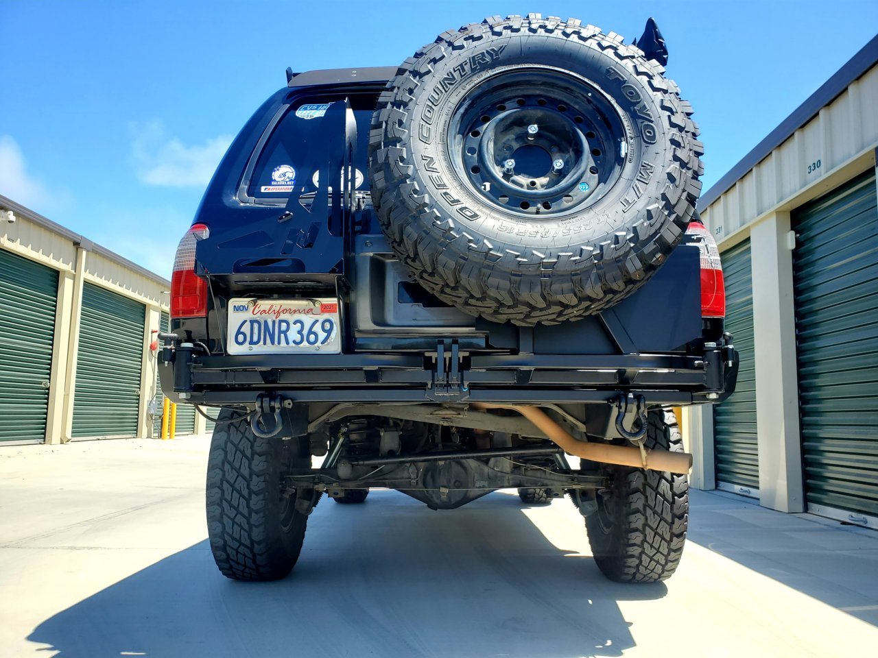

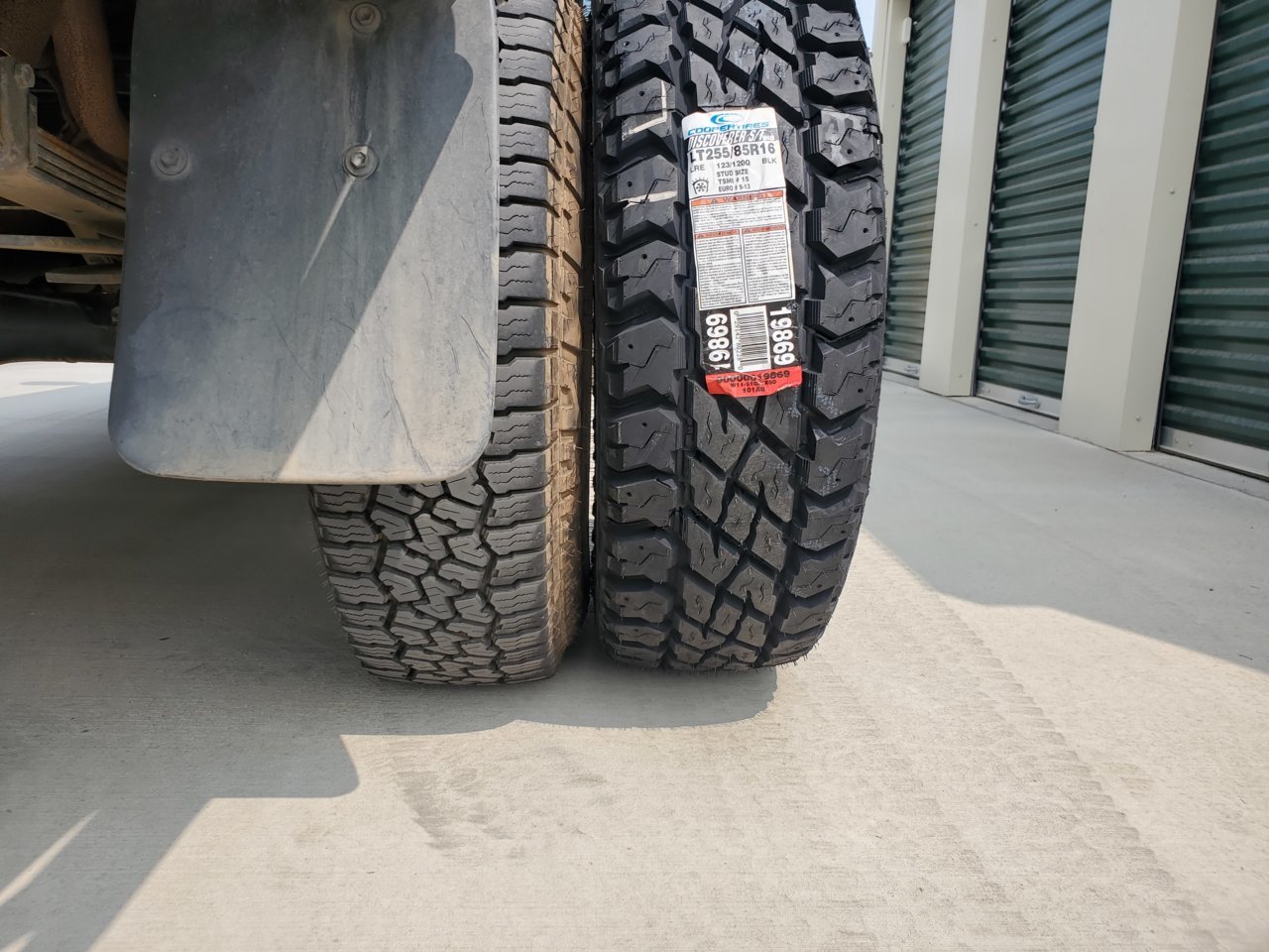

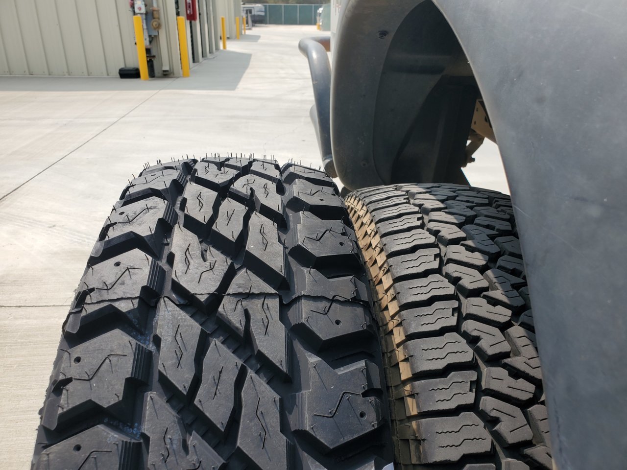

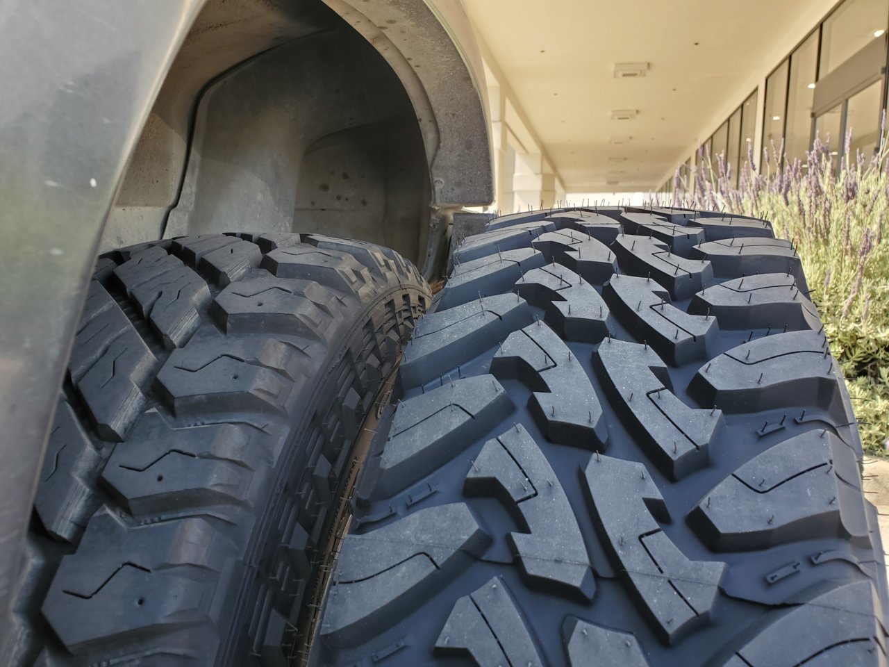

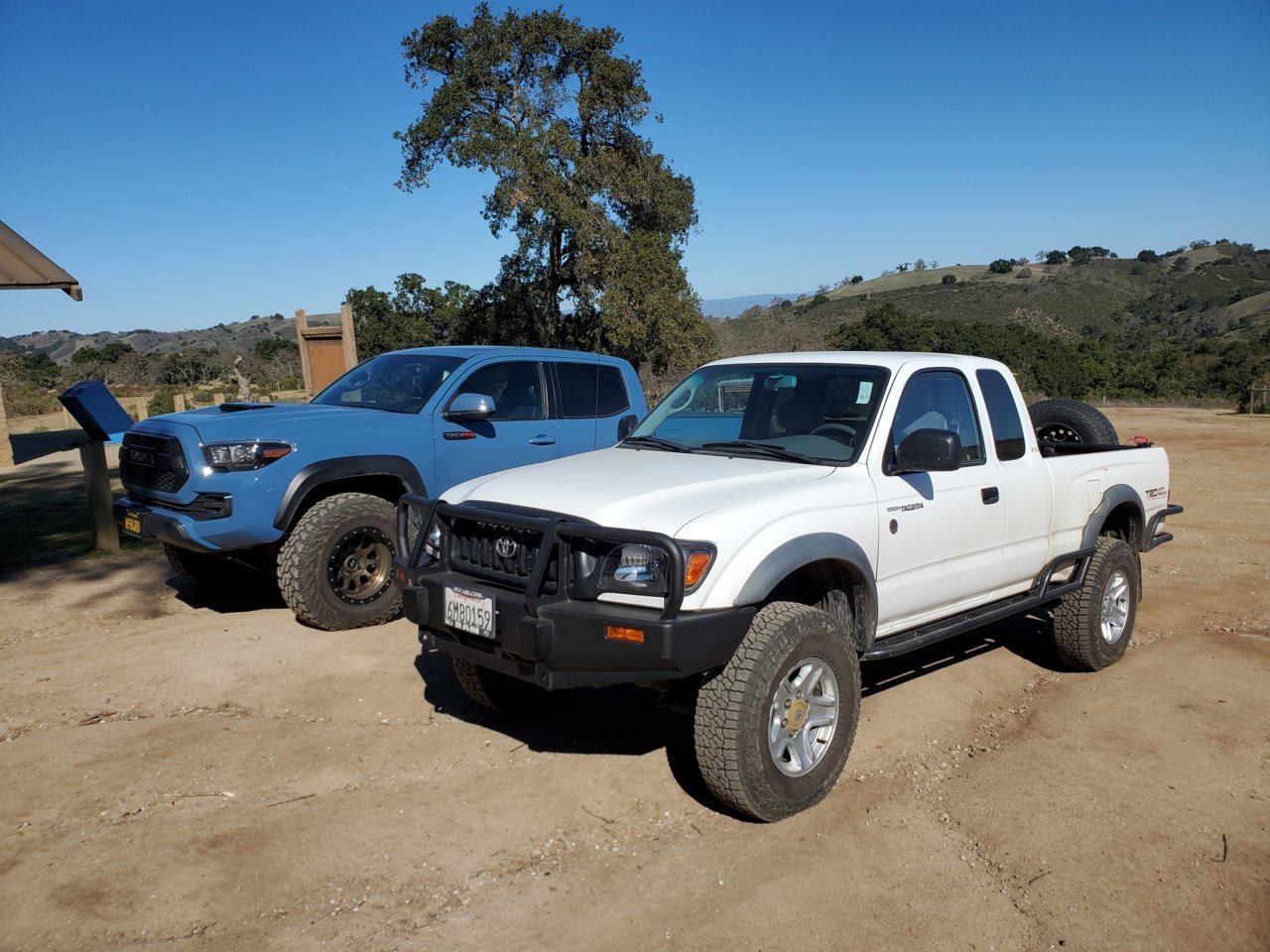

    And just for the heck of it, a photo dump of my tires all on stock wheels.
    235/85/16 (Falken Wildpeak AT3W) wheels on my old Tacoma (white one)
    Same tires next to 255/85/16 (Cooper ST Maxx) to show the difference in width and height -
    And the same 255/85/16 above next to another 255/85/16 (Toyo MT) of a different make -

    Ya this is good ^^^. The Toyo MT is 33.5 tall making them the tallest 255’s. The Cooper ST Maxx is 32.8, the shortest of the 255’s. Having had more than one set of both of these I recommended them both! But for the OP I suggest the Coopers just because they’re closer in height to the 235’s.

    Yeah I was surprised at how freaking tall the Toyo was.
    I got it as a spare since I couldn't find a Cooper anywhere.
    The thing is massive -
