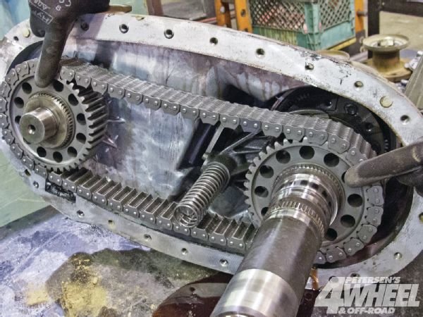

    I strongly advise against doing so. As long as you are not making any turns you lessen the damage. But it simply isn't worth the risk. Find a surface with loose dirt, gravel, sand or even grass even if you're only able to engage 4X4 for a shorter distance.
    Making sharp turns and cornering on dry pavement will very likely lead to immediate complete failure. But just because something didn't break today doesn't mean you didn't do damage to the transfer case. The transfer case uses a chain to transfer power to the front wheels as shown in the photo. Even though you don't break something immediately every time you put the chain under stress it stretches. It will eventually stretch enough that the chain will begin slipping on the gears and you'll have to have the transfer case rebuilt or replaced.gear-drive-vs-chain-drive-transfer-case-decisions-np271-chain-drive.jpg

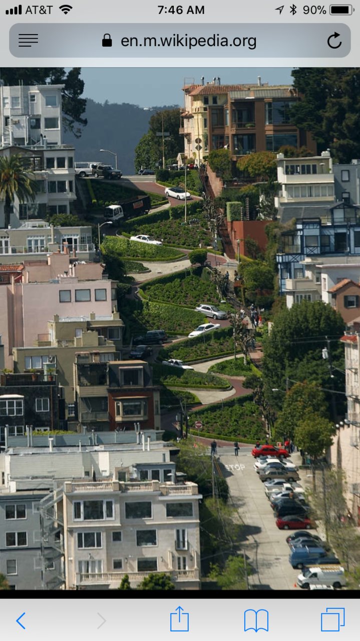

    I was in SF about a year ago and took a detour to show my then 3 year old that section of Lombard street that is about five switchbacks. There was a two block long queue up a steep hill as it’s a tourist attraction. I have a stick, so instead of roasting my clutch every time we inched forward, I put it in 4low. When we finally crossed the intersection to descend the switchbacks, I realized I forgot to shift back to 2hi. But it was too late, my wheels were turned and it wouldn’t disengage. :facepalm:So I tried backing up a few times but no-go. I had little choice but to keep going.
    About halfway through the first switchback, BANG!, it slammed back to
    2 hi. I was really worried I’d grenaded something but it all seems fine for now.
    Anyway, back to the relevant conversation....

    Roller chains do not stretch and people should stop saying that they do. Chains wear. The amount of tension force necessary to actually stretch a roller chain (aka bend the pins) is a couple of orders of magnitude greater than the transfer case housing could ever hope to hold.
    Lawfarin, synaps3, hiPSI and 4 others like this.

    Really? That one failed box picture has been making the rounds on every forum for the past eight years. One picture, one failure. If I remember correctly, that is a Jeep Grand Cherokee case and the guy drove it for 60,000 miles or so in 4WD before failure. C'mon man.
    tonered likes this.

    Exactly. There is no possible way our truck's tires slipping on dry pavement in a turn creates the force required to stretch the chain.

    It's amazing. One picture of one failed case has generated and alarmed tens of thousands of people to discuss this issue. Worse yet, they don't understand so they make shit up and post it!
    I'm pretty sure you could put our trucks in 4HI, cut the wheels to full lock and burn through tankfuls of gas and as long as you monitored the case temp you wouldn't fail a thing, other than wearing out your tire.
