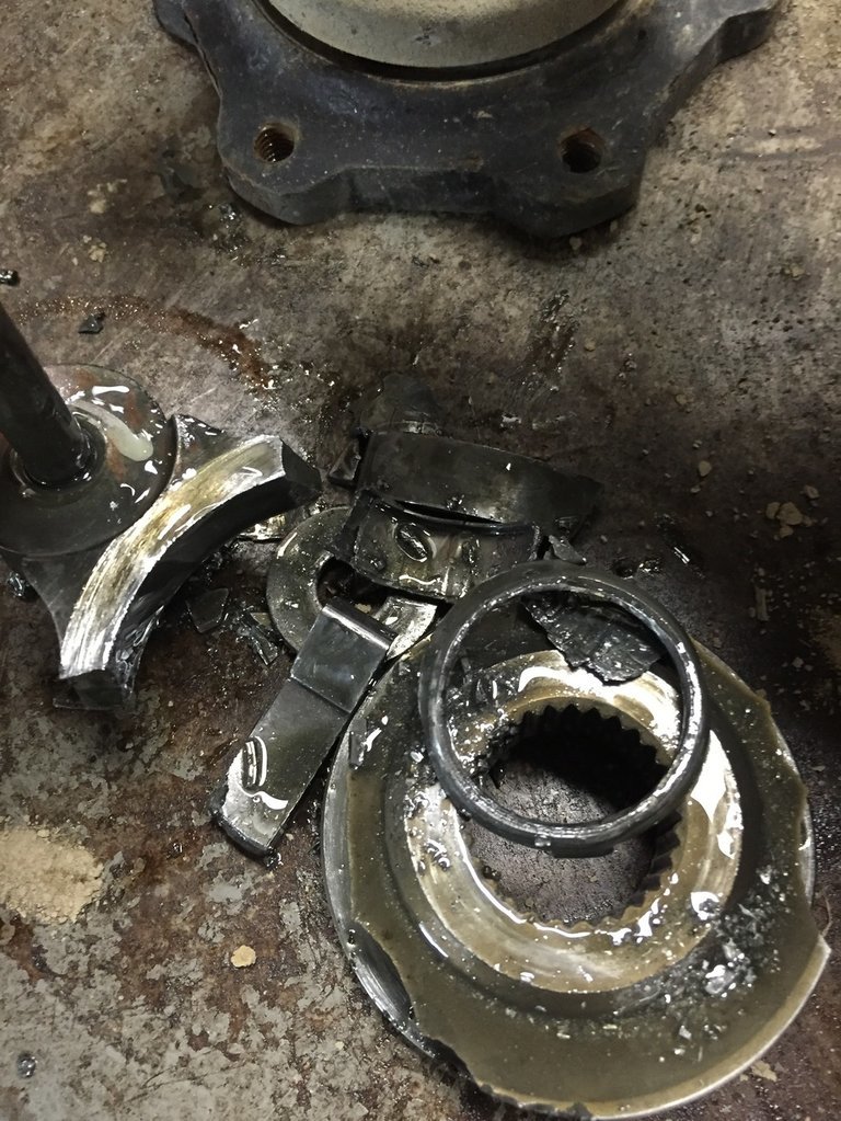

    Bullshit , thats not from straight lining on pavement , you said in the other thread that was in 4WD around town for 3 days and if flicking on 4HI on pavement was going to blow up your system anytime you did it , my truck would have detonated years ago
