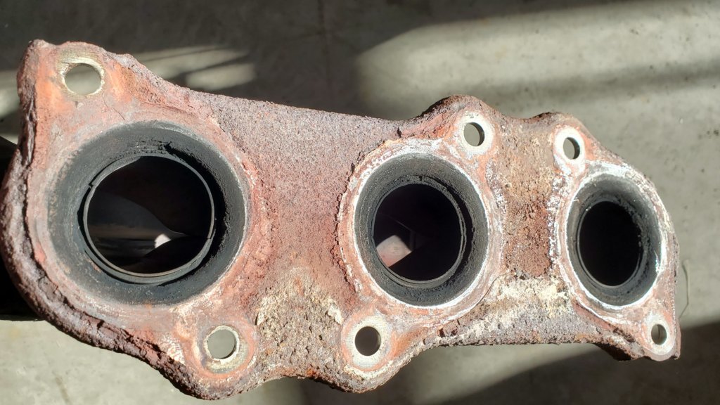

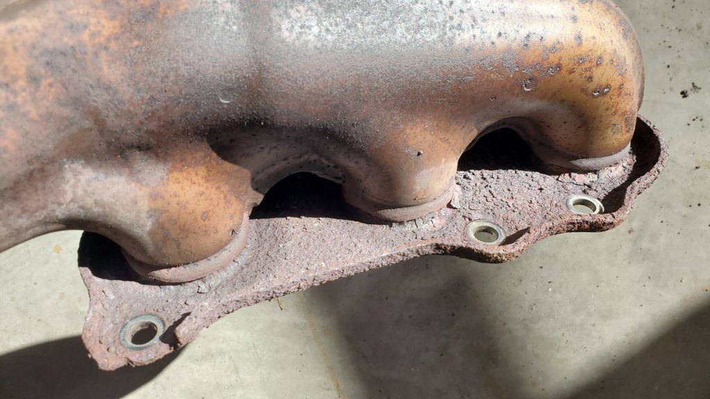

    Did you do anything yet?
    Just had both manifolds replaced on my 2011. It had been noisy for a while (ticking). Nice and quiet now. FWIW I used Walker "Ultra" replacements p/n 16390 and 16391. Aftermarket pipe gaskets, toyota manifold gaskets, toyota studs & nuts. Saved a pile having a Toyota-knowledgeable friend of a friend do the work, and getting the manifolds myself from another parts supplier.
    I still have the old manifolds sitting in my garage if pics would be of any use/interest to anyone.

    I'm not really sure where it was leaking. It doesn't look like the gasket was leaking, but it's not my area of expertise. I will post some pics.

    I sure do.

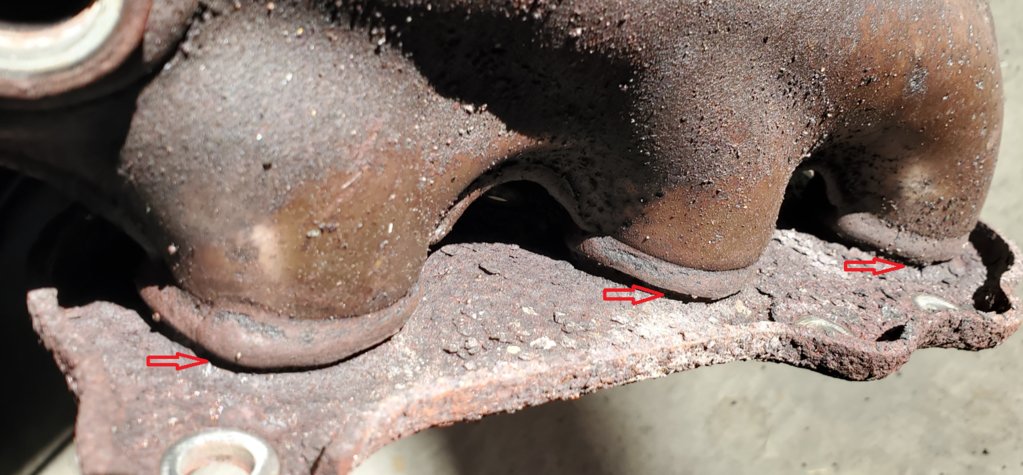

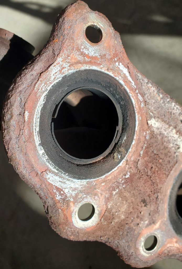

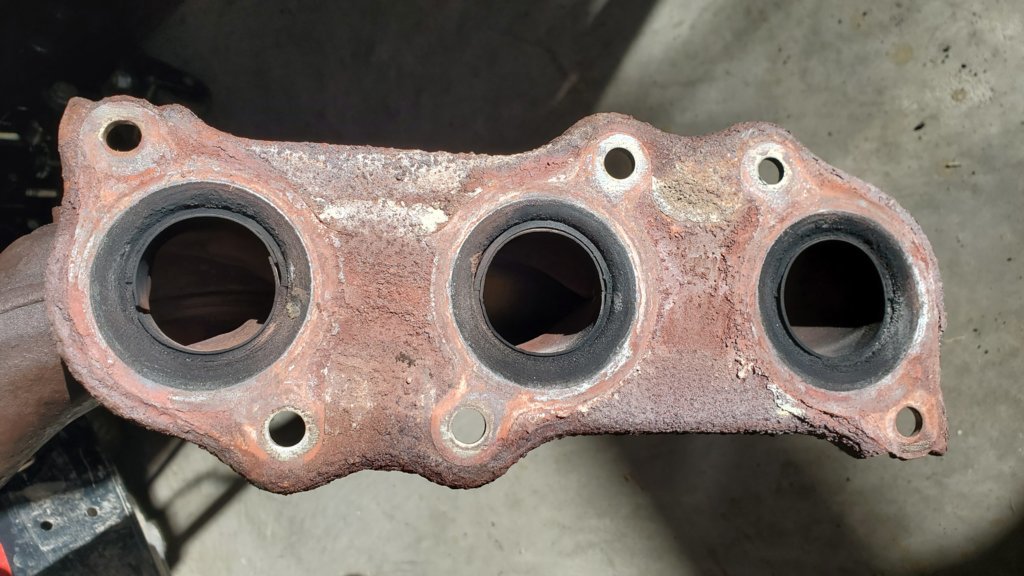

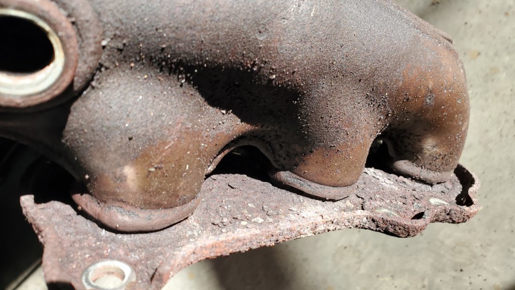

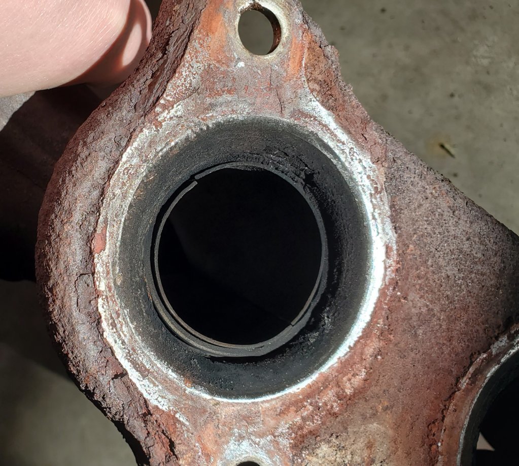

    Also identified that the leaks were holes in these areas:

    2010 TRD Sport V6 Auto Double Cab MGM
    I hook a shop vac up and blow air into the exhaust (truck not running) .... then sprayed soapy water in the exhaust manifold.....I have small leaks in the same area.
