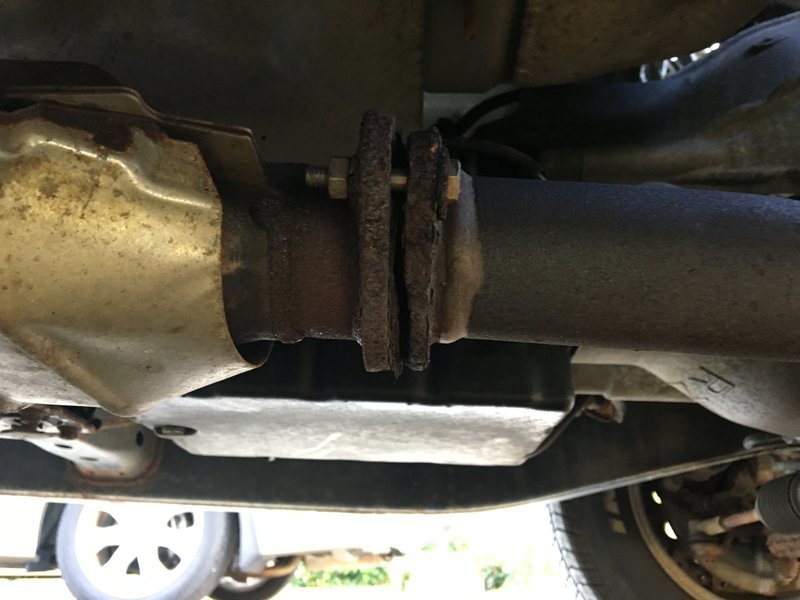

    I am posting here for the first time to ask some advice. I have a 1997 2.4L Tacamo, auto, 2W. I have had it about 10 years and I love it.
    I was driving home this afternoon and suddenly noticed the truck was much louder especially when accelerating and when stopped I could smell exhaust in the cab. Exhaust leak, right?
    At first, it sounded like it was coming from the headers. When I arrived at home, I let it cool down and did you research. It seems these exhaust manifolds have an issue with breaking and if memory serves me correctly, after I purchased the truck it would not pass inspection because of a hole in the exhaust manifold.
    After it was cool enough to work on, I sprayed PB on the four bolts holding down the heat shield. Yeah... Three of the four sheared right off. But manifold looked good. Then I got under the truck (which I should have done first) and found this (see photo).
    Now I have a header with no heat shield, a rusted down pipe and cat. I have already replaced the cat myself about three or four years ago. That was a PITA. Then I had to have the muffler replaced earlier this year. (WTF with that rust?)
    Should I just replace the down pipe and the cat? Or should I try to prevent further issues and get like an ebay header and cat and call it a day?
    And without getting the bolts out of the current header, do I have to worry about not having a heat shield?
    Many thanks.

    02 Tacoma, fixed with curse words.
