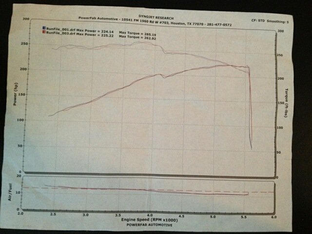

    She moves pretty good. :cool:
    TRD CAI, NST Pulleys.
    Not to bad for some pulleys and a filter. :D

    that graph as alot of short cycle noise in the torque curves
