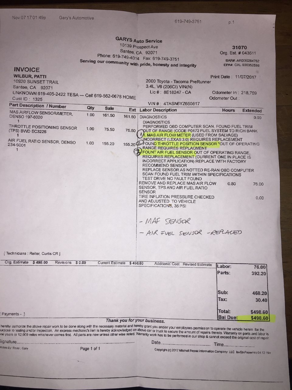

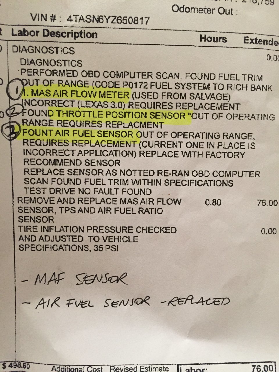

    UPDATE... problem seemed to be solved;
    NO CATS AT ALL, problem was new MAF n throttle positioning sensor and air fuel ratio sensor all of these together were making my fuel system too rich and out of operating range my mechanic reset all sensors to factory recommended settings truck runs brand new so far so good 100 miles since released from mechanic....

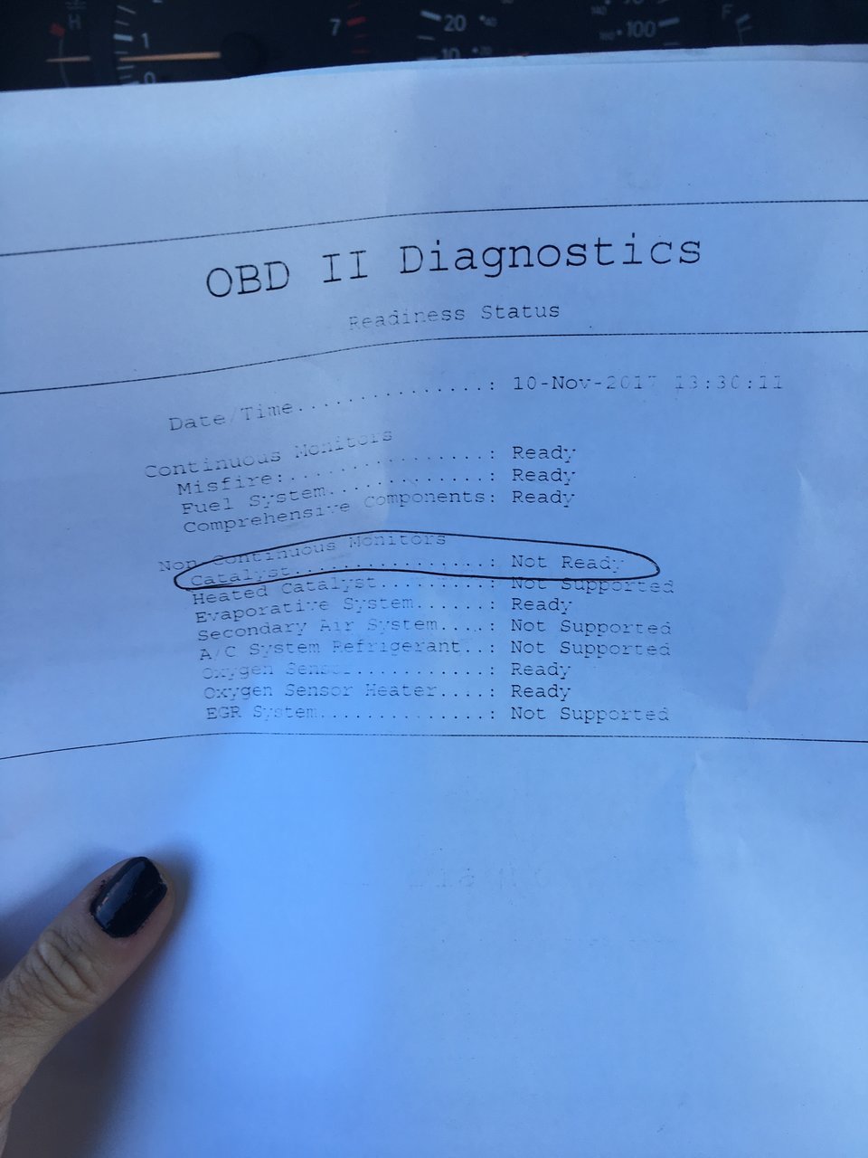

    UPDATE... i brought it to get smogged lat week after 230 miles on computer after all codes reset,etc... and faile smog cuz "catalyst" not ready...!!???image.jpg

    anyone thoughts???
    Gary my mechanic installed new MAF and whole bunch of other parts (see previous post with bill and work performed)...
    mechanic and I r shocked smog wont pass,
    good news is truck is driving 1000% better, like a brand new truck, zero hesitation, more power, better mpg, etc....
    no rattling in cats i did tempature test on cats b4 b4 intake and after exhaust, temps were within factory specs, no rattling or crazy noise...
    SUGGESTIONS...????!!!

    Was the truck cold before the test? If so, drive it to get it hot then idle and do not shut off the engine until the test is complete
