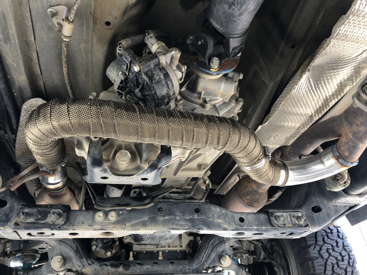

    $100-$150 for just the reroute. I wrapped mine with Nomex as its pretty close to a few items that normally have a heat shield. Not expensive to do.

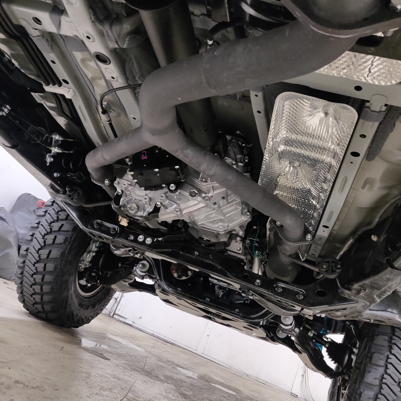

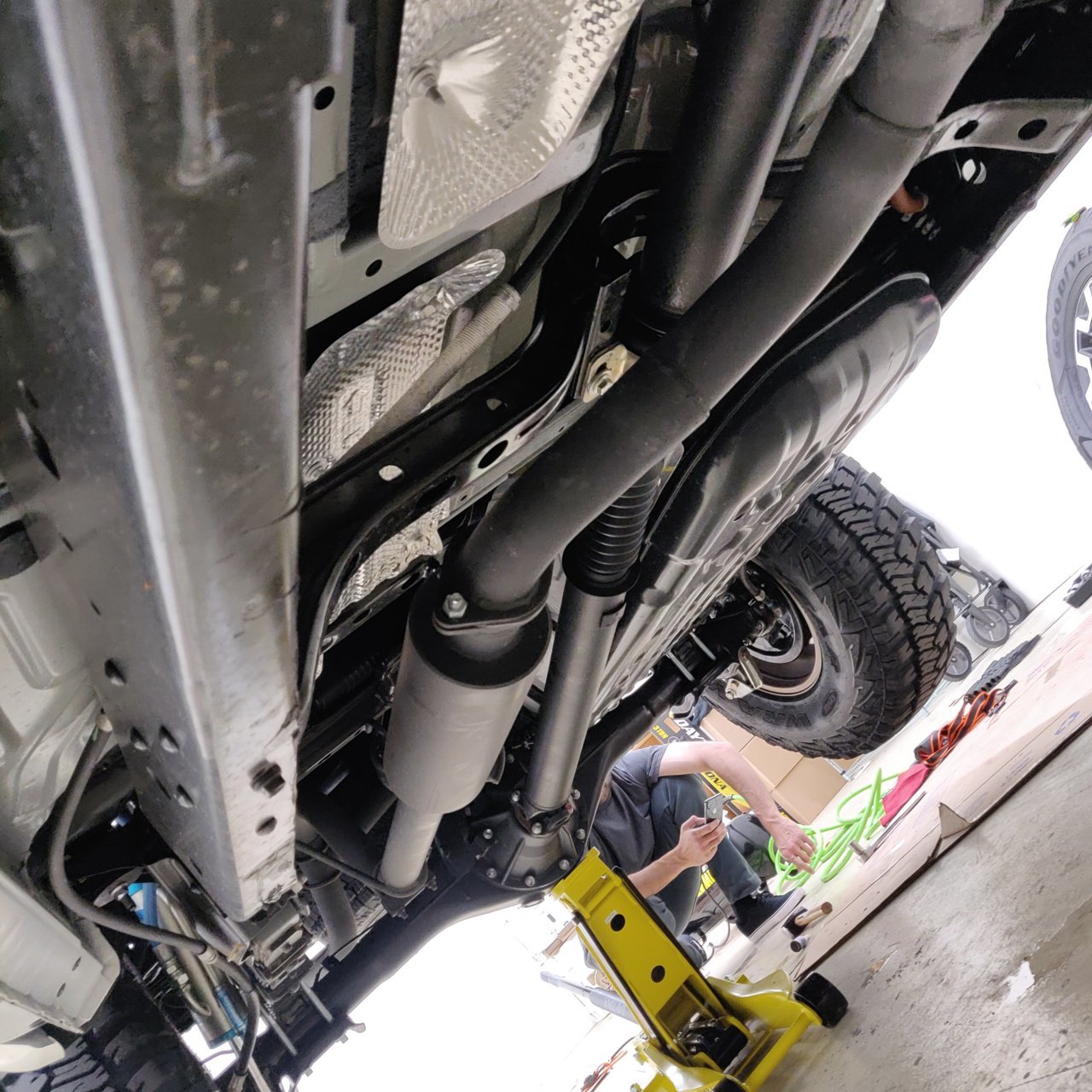

    Replaced most of the y pipe and reroute as you can see I did it at my shop. Would run about 275.

    What are the metal hose clamps for?
  9. Sep 19, 2024 at 9:32 PM
    02hilux
    02hilux What do you mean there’s no road, I’m here
    Sep 14, 2016
    #197244
    6,135
    Planet: EARTH
    to secure the wrap, preventing them from unraveling
