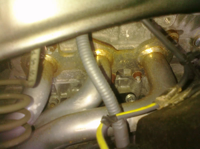

    Hey guys. So I replied earlier to an old thread about the check engine light on a '08 V6 I'm looking to buy. Turns out it's not just a cat back, so I thought I'd start a new thread on this issue since I didn't find anything upon searching.

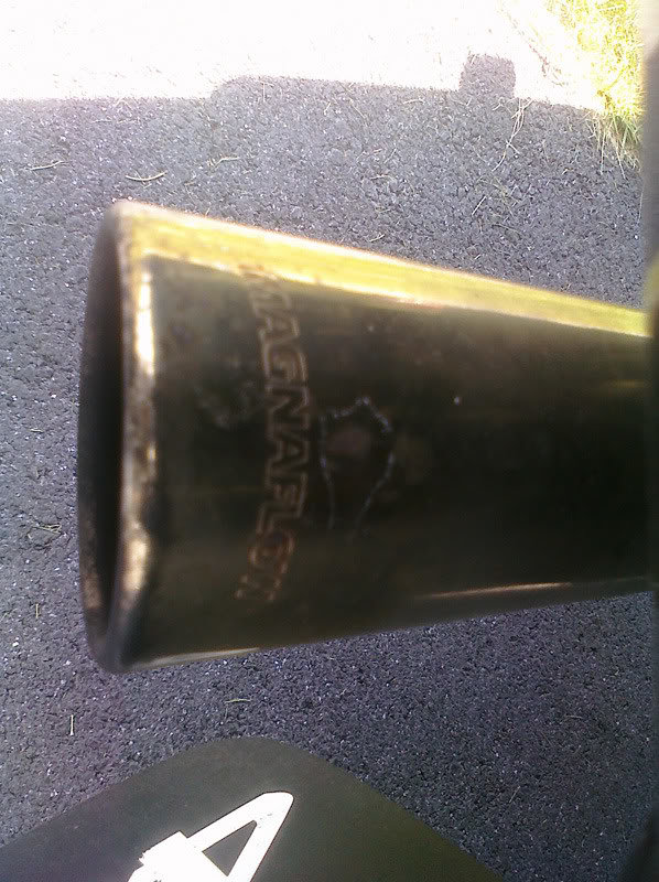

    The dealer describes the exhaust as "aftermarket from the mani back". The pics clearly show magnaflow branding, but it looks like magnaflow doesn't make a header back system for the gen2 tacos. So, I guess this is a magnaflow cat-back with somebody else's components up front??
    The dealer also says the only codes that pop are exhaust related. Sorry, don't have the exact codes. I could probably get them if it would help. I also have to think that if this were an easy fix, the dealership would have done it before trying to sell the truck. The only 'fix' they offered was to return it to stock for $1600. :confused: No thanks.

    it looks like u got long tubes and previous owner didnt hook up the o2 sensors which is why ur throwing a code

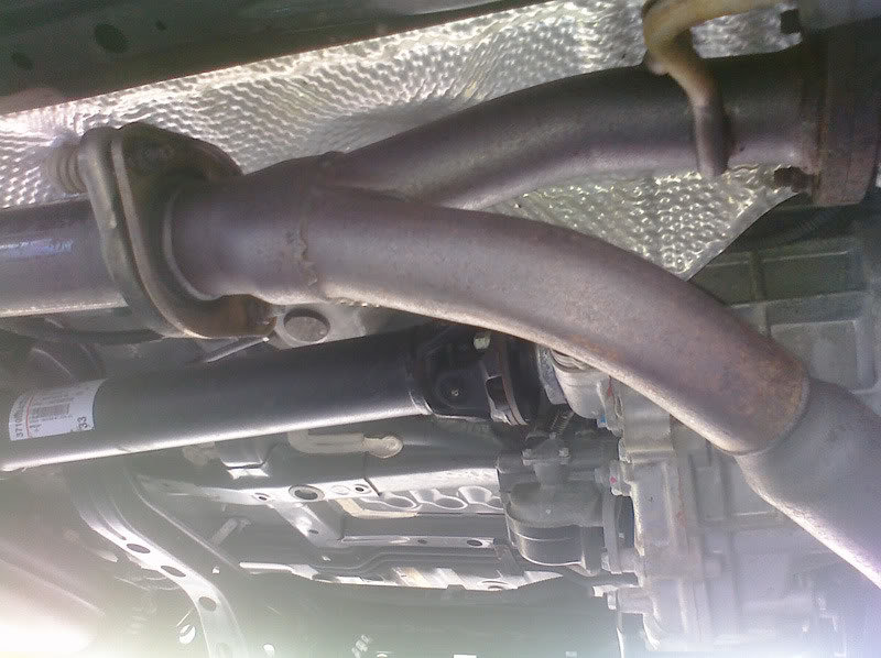

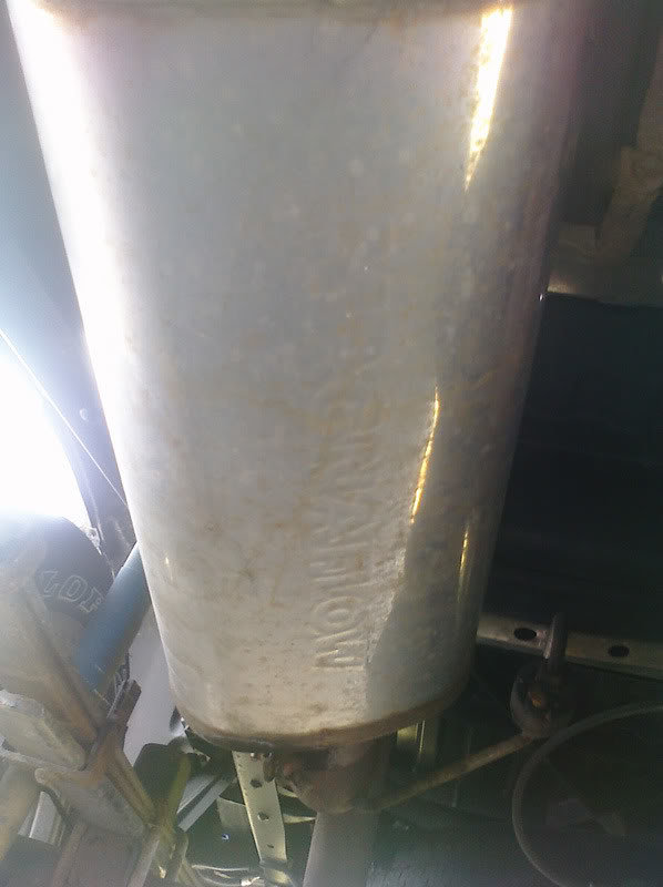

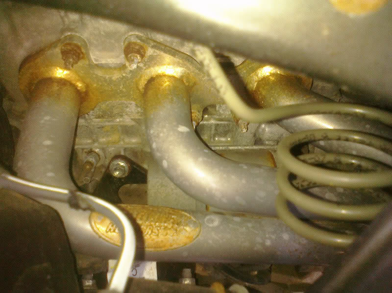

    heres your set up
    doug thorley long tube headers
    looks like the urd y-pipe
    magnaflow cat back...
    your headers is whats probably throwing the code, im assuming the previous owner didnt add the o2 sensors so the CEL is on because you got rid of your cats.

    the best diagnosis is for you to get the real code that your throwing and post it. rox and i are just assuming this is what your problem is by just "looking" at your set up. there can be lots of things wrong

    From the pictures I'd say everyone so far is right on the money.
    By the way, that is a nice setup you've got. Many would like to upgrade to what you're running. :thumbsup:

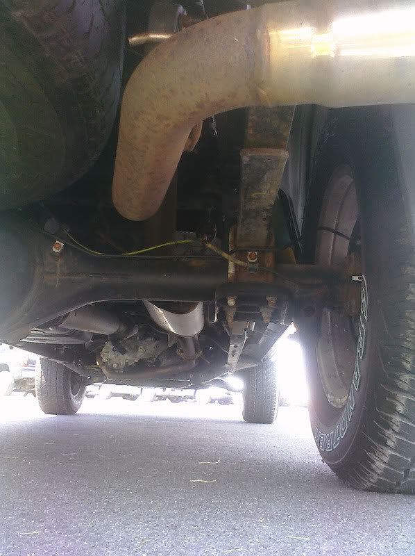

    Is this a problem? I think the tech at the dealership said that sensor isn't even there anymore. Can you tell from the pics?

    Ok, whoever installed that set up did some jimmy rigging.
    You have to have the rear sensors in the pipes and plugged into the connectors. You will need to crawl under and inspect for yourself. If they are gone, you will probably see a cap screwed into the bungs on the Y-pipe. If this is the case, I would make the dealer install a set of O2 sensors. They are required to be there by law BTW... Your truck will run like crap without them.
