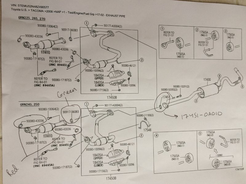

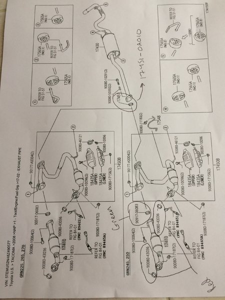

    Thank you gents,
    Sorry if my original description was not correct. I have 4 new gaskets I am replacing, from the diagram given to me these gaskets are on each side of the Cat. I will post a pic of the diagram.
    Thanks again for the advice.

    AE manifold spacer Bed lights Seat Jackers Blackvue Dashcam Elite Performance Tuned Fumoto Oil Pan Valve
    The circled gaskets are those being replaced

    A bunch a cool stickers, a bada ass MetalMiller Tx Longhorns grill emblem painted Hemi Orange, JBA long tube headers with o2 sims, Diff breather mod, Red LED interior lights, Fancy head unit that plays ipod n movies, Also DIY install factory stuff like, factory cruise control, factory intermittent wipers, OME nitro struts with 886x springs and toy tec top plate, JBA high caster UCA's for better alignmnet and dey beefier too, Old Man Emu Dakar leaf springs in da rear with the gear, U bolt flipper, Ivan Stewart TRD rims with 33" K Bro 2's, some bad ass weather tech floor liners so I don't muck up my interior, an ATO shackle flipper for mo travel in da rear wit the gear, also super shiny Fox 2.0 shocks back there too, all sorts of steal armor for bouncing off of the rocks like demello sliders, AP front skid, trans skid, n transfer skid, demello gas tank skid, and a tough as nails ARB bumper with warn 8k winch, I'm sure there's more
    For the "green" gasket, those bolts are going to break. Replace them with stainless. The others are no big deal, still wire brush n lube before removing. Torque spec for all those is 32ft#'s

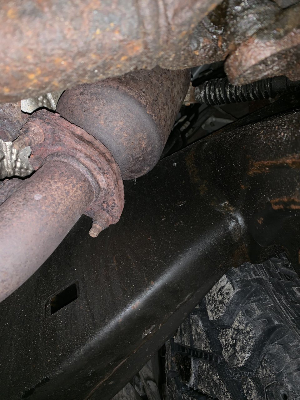

    I know this thread is both old and was originally about a second gen, but I'm doing a similar gasket job on my 1st gen PreRunner V6 and was wondering if anyone could confirm the exhaust gasket part number for the gasket in green below (the FSM just says gasket, with no part #!):
    I used a Walker 31332 Exhaust Gasket as Amazon said that would fit the truck and some commenters on Amazon confirmed that it fit theirs, but the metal ring inside the gasket and the gasket itself was noticeably smaller than what was in there before. However, it fit the muffler side indent much better pressing it in, albeit with the inner metal ring fully inside the circumference of the exhaust pipe, and it seems to have sealed up no problem. I'm wondering if the previous gasket was the wrong size, as it was well blown and caused some damage to the flanges. Thanks!
