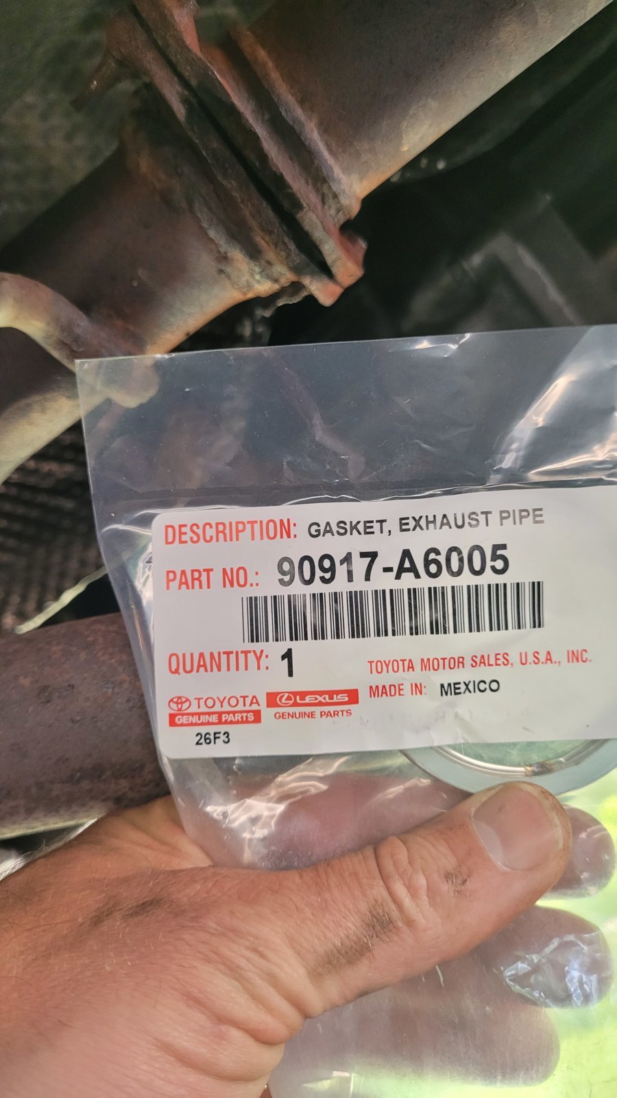

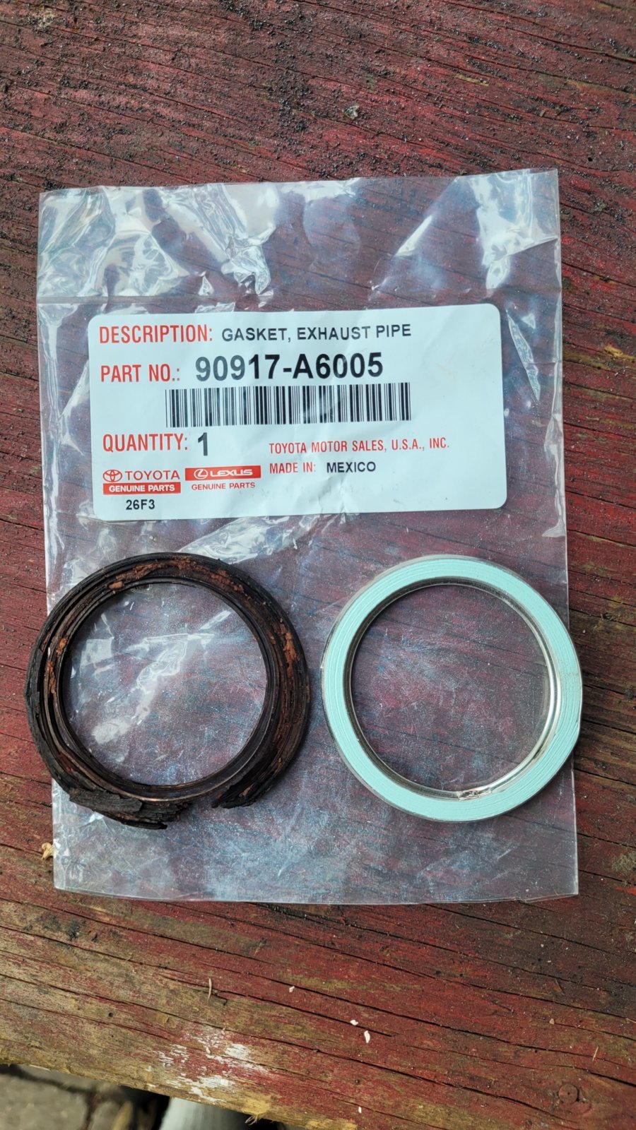

    Old post but I need to change that "green" one. My part # was actually 90917-A6005 though, bought from dealer. I believe it's the same. I bought new bolts and nuts pictured too. Is there anything I need to do to get the exhaust apart to insert? I did one on my Sienna and had to ratchet one end to have enough space to insert the new gasket. I haven't took a real close look at the Taco to see yet.

    As I recall the flange just separated after bolts are removed. I know the bolts they sold me were wrong, the bolts have a reverse torx head.

    If you loosen both sides, the exhaust will be able to swing back far enough to get your gaskets in no problem. The rubber hangars have enough movement in em to easily do this

    Yes, agreed. I did not have to completely dismantle the exhaust.There is enough ‘play’ once bolts are removed to remove old gasket and replace new.

    Thanks for the quick response guys. I had to use a little muscle and a hand from my son but there was enough play to get the gasket on. Sounds good now.

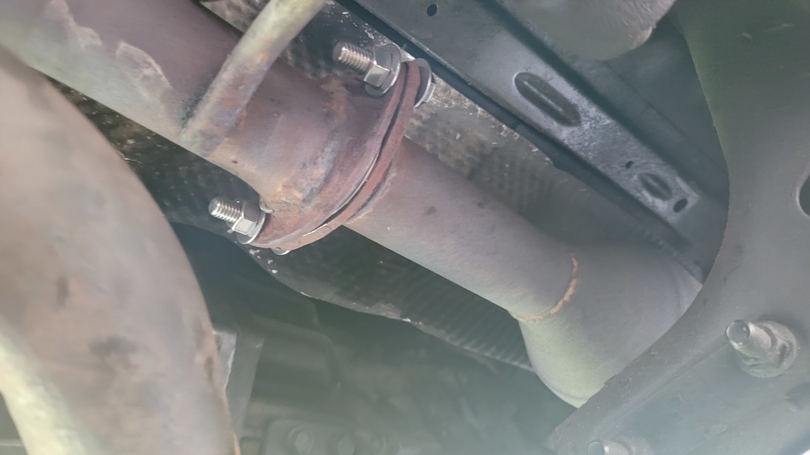

    Used 3/8" x 1.5" stainless hardware, after cutting old hardware out. Right bank exhaust , just forward (engine side) of where exhaust from right and left exhaust meet.
    SH7mi[OP] and Dalandser like this.
