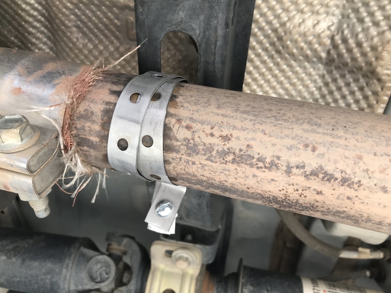

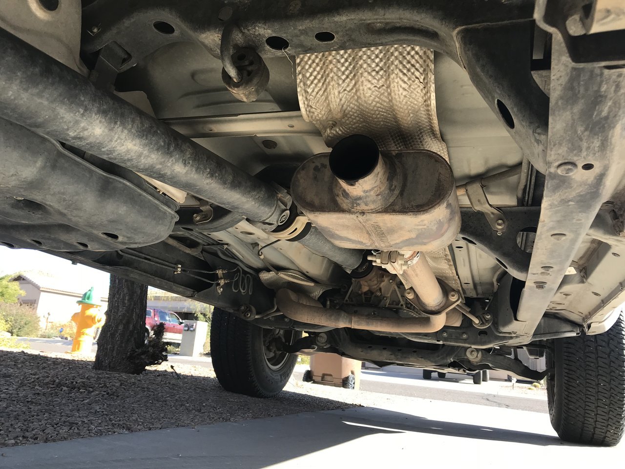

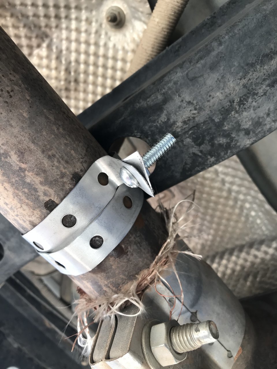

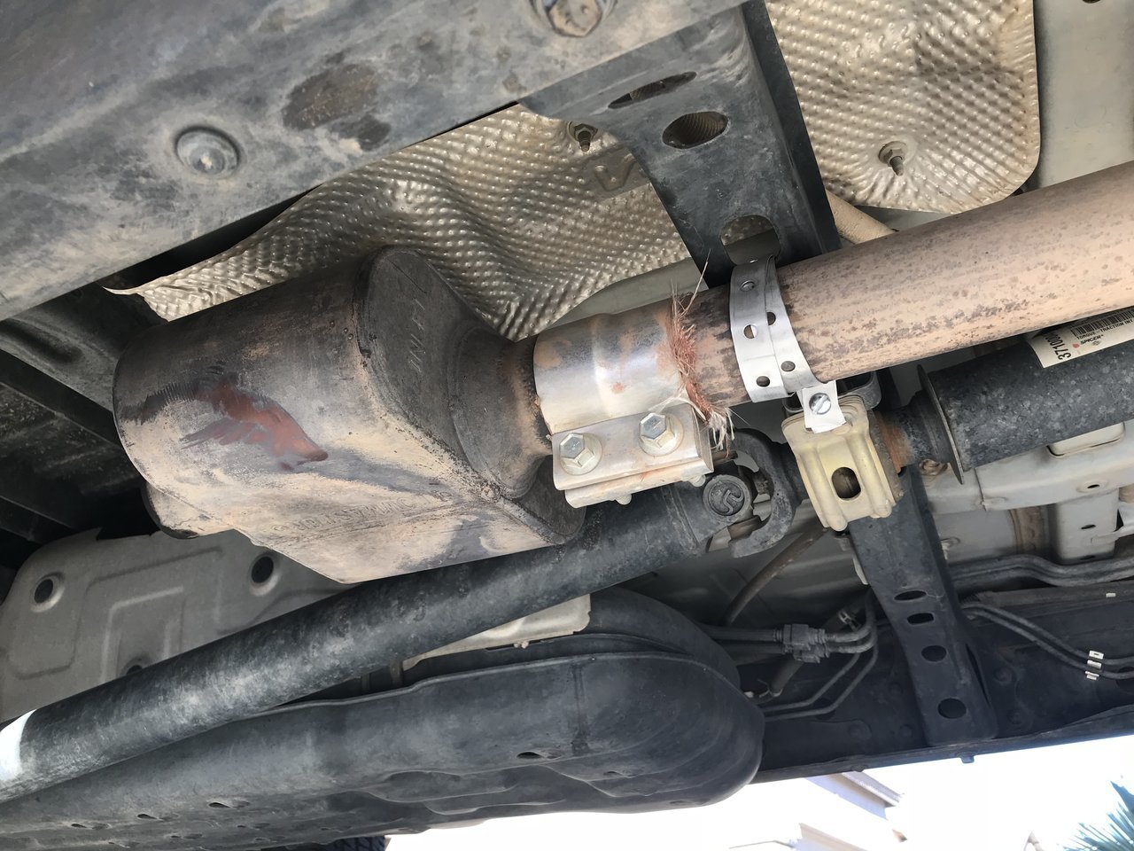

    A9F3FACE-29D6-4567-84DF-9B84B1F89DE2.jpg EB7607DD-A845-4FEB-BFE9-576266A635B3.jpg 8DD75DE7-D5A6-4F65-B96A-6D00339006B3.jpg BBC3352D-4B2D-4B58-8EA1-C4D73557D1DC.jpg Does anyone have any better ideas of how to hang this exhaust? I didn’t think it completely through a while back when I cut the exhaust and left myself nowhere to hang the pipe from, forcing me to ghetto rig it to the crossmember with metal strapping. The strapping has been breaking from time to time when I go off-roading so I doubled up on it this time hoping it’ll last a while longer. Looking for better/more creative ideas of how to hang it.

    Relocate the existing, unused hanger?

    An exhaust shop will probably charge you like $20 to add a hanger for you. Just make sure it's not a fixed hanger. It should have some play like the factory unit.
