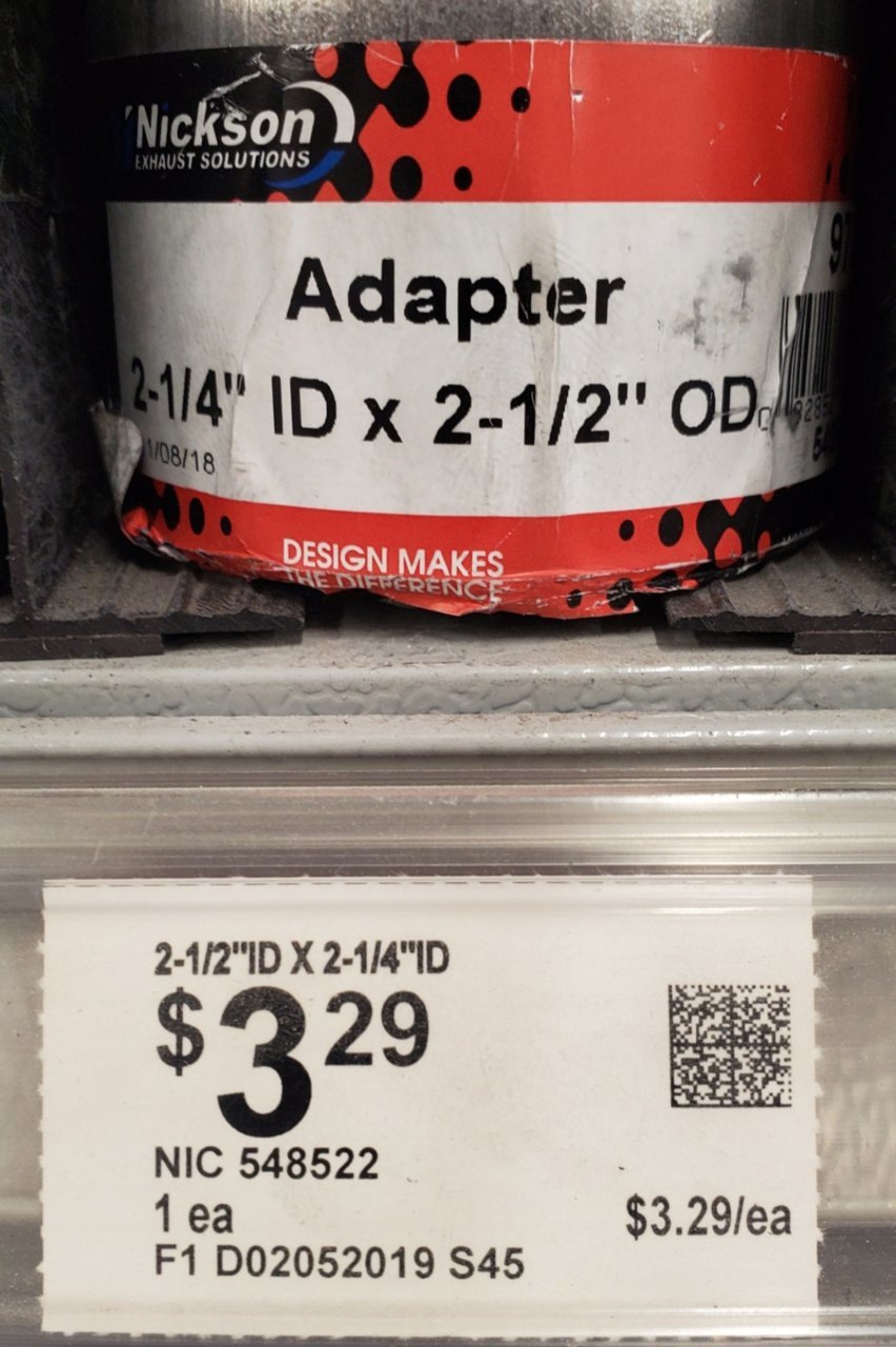

    I saw these yesterday at Autozone, I didn't know these things are available. They have all kinds of combinations available. For the Y, I personally would check a wrecking yard but I'm sure someone makes them from the aftermarket.

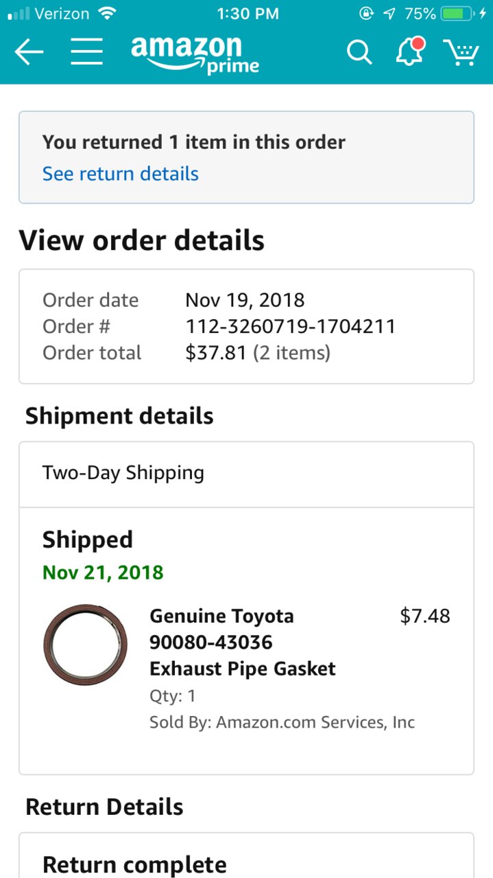

    Lol Toyota tried to get me for that exhaust replacement too. They wanted $3417 with the frame replacement. I did one of the gaskets myself last summer. I got the gasket on Amazon. The hardware was rusted away but was easy to replace with a new nut, bolt and lock washer. I pried the flange open and gobbed exhaust sealant on both sides, popped the gasket in and bolted it up. Been fine since.
