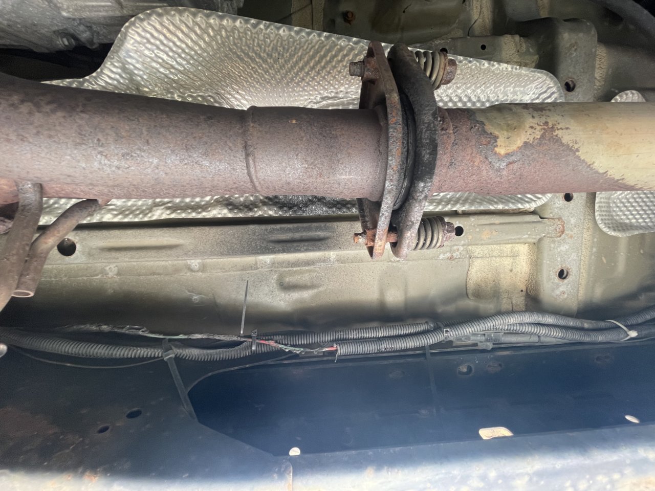

    So I discovered that the loom and jacket for my rear facing Ridgid SRQ lights completely burned away in a few spots. Last year I had an exhaust leak at the flange where the catback connects - that must be when the wires melted yeah? Wiring 8”+ away from the exhaust tubing shouldn’t melt under normal circumstances right? There is stock wiring there after all.
    Just wanted to get an opinion before I go replacing that run of wire.

    MGMDesertTaco Come on, live a little...

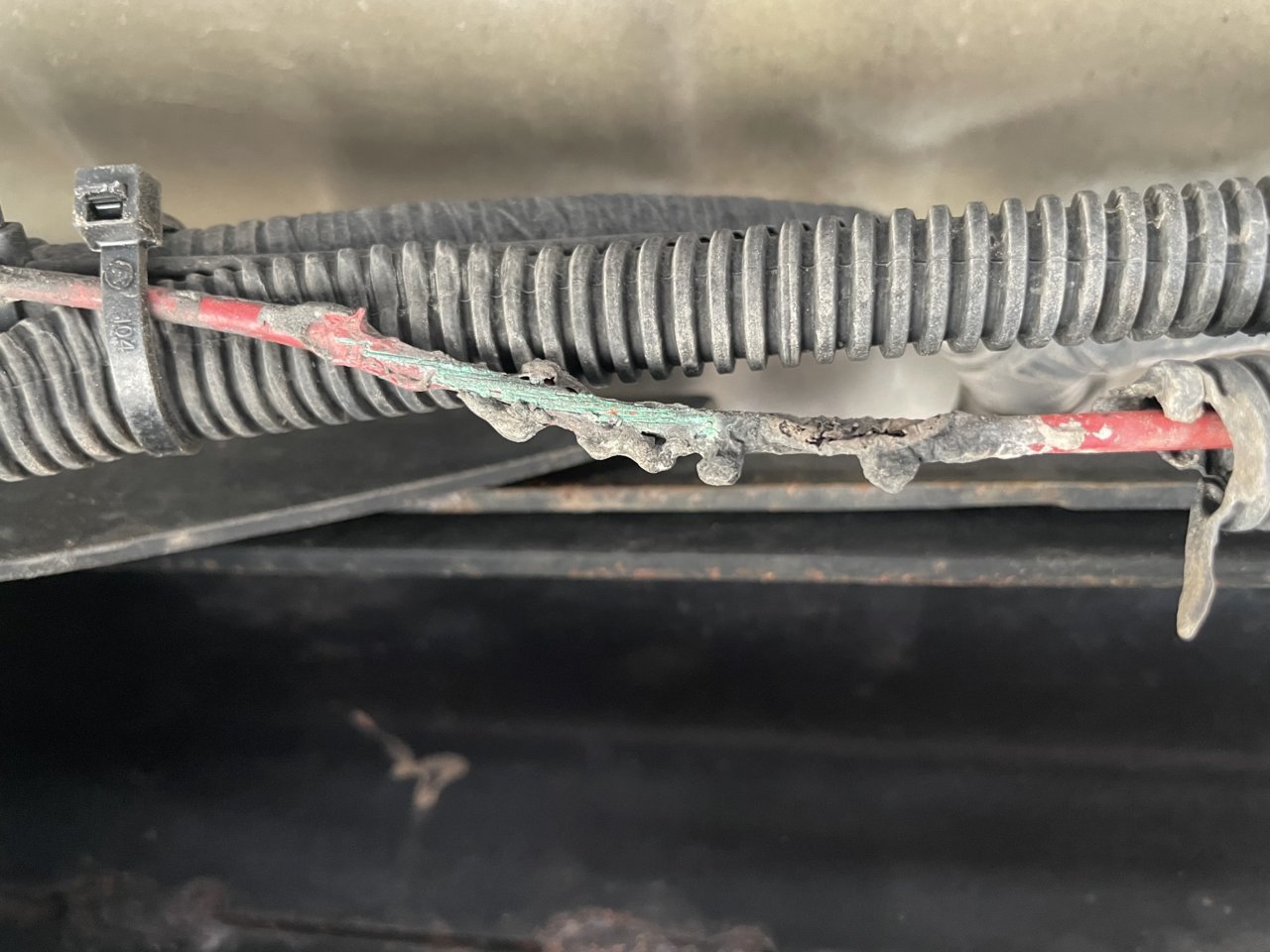

    Yeah I doubt it was overloaded since the lights were wired to their own, properly sized fuse. But it is strange that that loom melted when the stock harnesses right next to it didn’t. Perhaps Toyota uses heavier duty loom than what Rigid ships with their lights. Regardless, I’m going to completely redo the whole harness with high temp sleeve and good wire.

    That's an electrical fire my dude. The zip tie is untouched but the exhaust melted the wire under it?

    Good point, you may be right. I just can’t think of what the issue could have been. Maybe I’ll find out when I pull the harness out. And yeah the lights were still working until I disconnected them from my fuse box. The jacket melted but the copper is still in tact.

    It was in conduit that burned away.

    If you look at the location of the wiring loom, you will see the black exhaust smoke that looks like it came through the point where it leaked, so yes. I believe that's what happened just by looking at the picture. Id go ahead and replace the wiring and loom if you have repaired the exhaust leak

    Yep exactly. I’m probably gonna go with something like this across the bottom of the truck:
    https://www.techflex.com/high-temperature/insultherm
    Right? It would be too coincidental that the wire melted at the exact spot where it was leaking. Glad I’m not crazy thinking that was what happened. Whatever the cause, I should be good after wrapping the new wire in high temp sleeve just in case.
